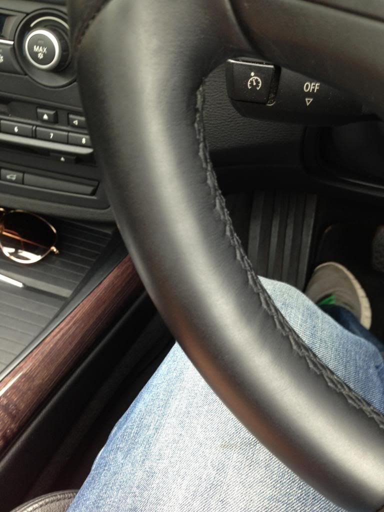

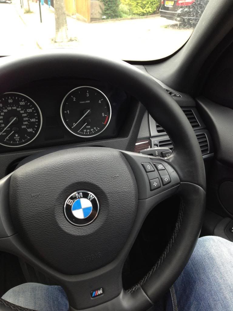

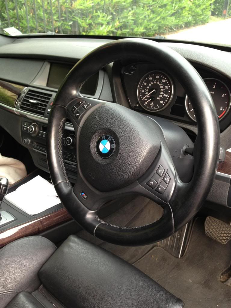

Just restored my MSport leather steering wheel on my X5. It was looking shiny and generally dirty and felt terrible. So thought I'd post a few pictures and share it with you all. What a difference its made.
from this (before):
to this (after):

My wheel looked terrible, it was shiny and felt dirty. Now its restored and look great for a car of its age plus its got the new matt look and feels soft and thick again, like new. It took about 20mins and has made a huge difference to the interior.

Thanks. I happy with the result. No doubt if I'd spent longer with the magic eraser i would have cleaned the leather up better before treating it.
Now the interior feels like new. I just need to find a way to repair this on the steering wheel. It drives me mad everyday I look at it (this photo is pre-clean!)

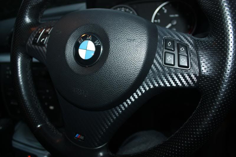

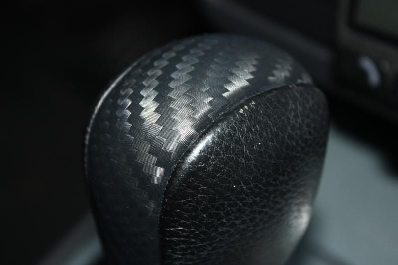

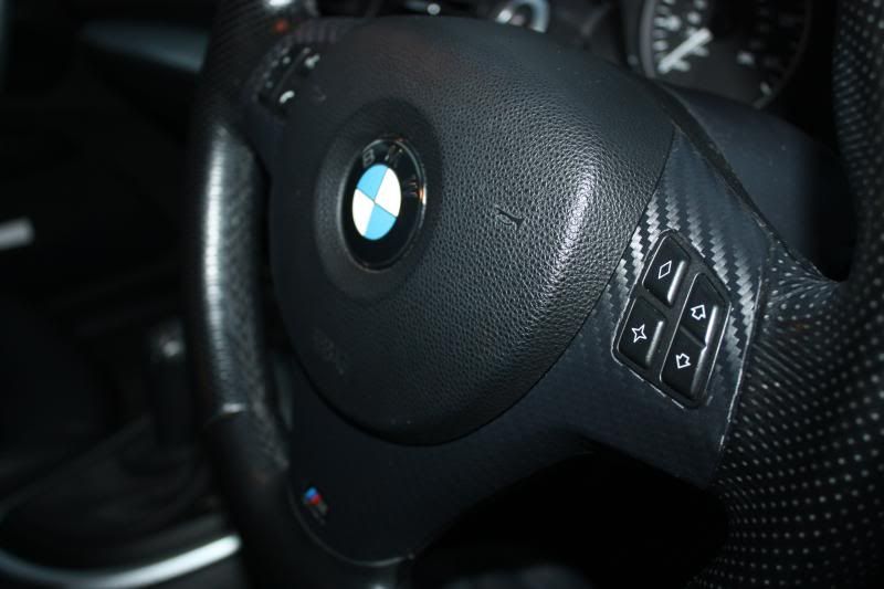

I've done my own on the 1-Series, needs a hair dryer and patience. Sometimes a few return attempts too. Can post up pics if you like?

Post by Sanj » Fri Oct 25, 2013 5:59 pm
Here you go (sorry about the flash). PM me about DIYing:

Sanj looks like a very professional job. Nice work.
