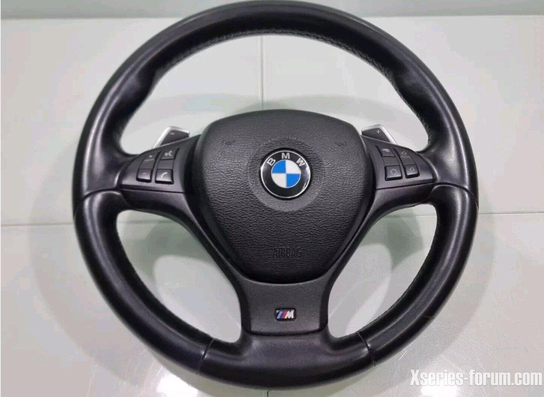

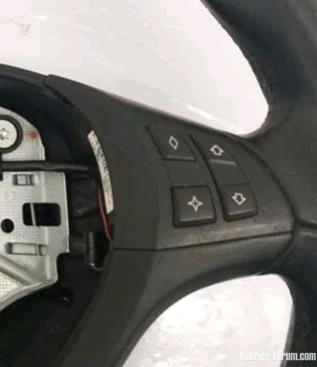

What do the inner switches do? I assume the top one is audio in some way?
The originals on mine are selectable, but in reality, i never use them. The question is, when swapping steering wheels, would these switches be compatible to swap, or do i need to split and transfer them?

If you mean on the upper image then the upper button changes the entertainment source and the bottom is air recirculation mode. My manual doesn’t list the buttons on the lower piccie. Whether they will work I can’t say. They’ll do something, but maybe only what is already there rather than something different.

Ive edited as i had the images the wrong way round. Could you clarify for me please You have an LCI model of courseX5Sport wrote: Fri Aug 01, 2025 1:03 pm If you mean on the bottom image then the upper button changes the entertainment source and the bottom is air recirculation mode. My manual doesn’t list the buttons on the upper piccie. Whether they will work I can’t say. They’ll do something, but maybe only what is already there rather than something different.
On pre LCI the two symbols can be assigned to different options in the idrive, though what they are off hand i don't even know, but i could get off my butt and have a look i suppose

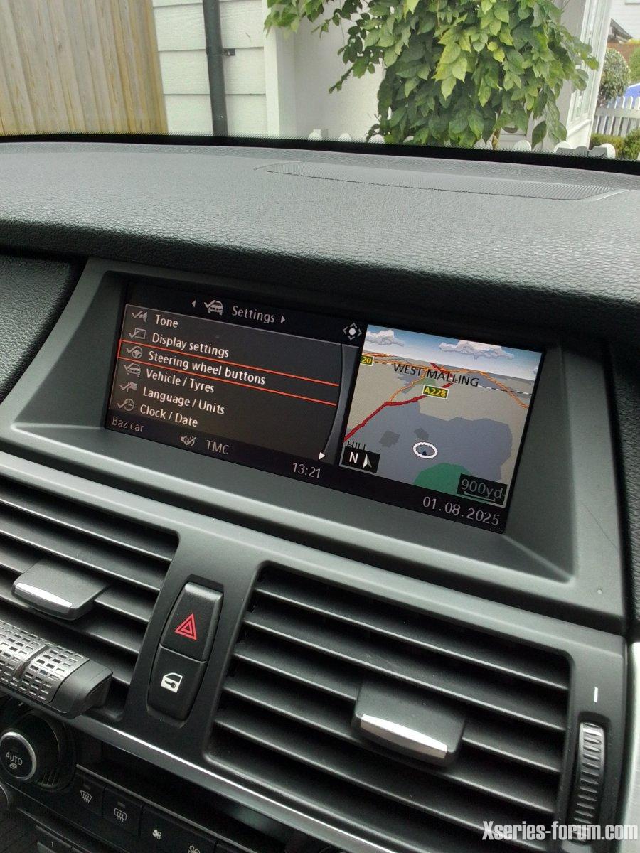

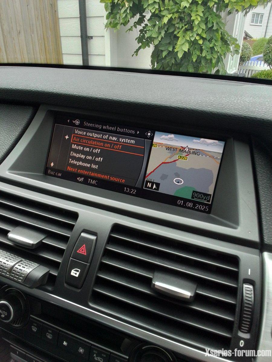

It seems the LCI models have a simplified system. Pre LCI had assignment options in the menu.. I've set up the idrive options to match the LCI steering wheel buttons, which is all i need, if that

I can’t reassign any buttons. They are ‘fixed’ and as per my comment. The top picture is the one I’m referencing. The inner pair are Entertainment source (upper) and air recirc (lower). My X6 was amongst the first of the later CIC (rather than CCC) cars. The later ones have more buttons on the idrive controller. I never use those two either.

My replacement steering wheel is now fitted drama free. I only lost the clock and date display, which is easy to reinstate. The 'new' buttons now operate steering wheel functions as LCI cars are designed to, having pre programmed them via the idrive. I was pleasantly surprised the radio and seat memories were retained.

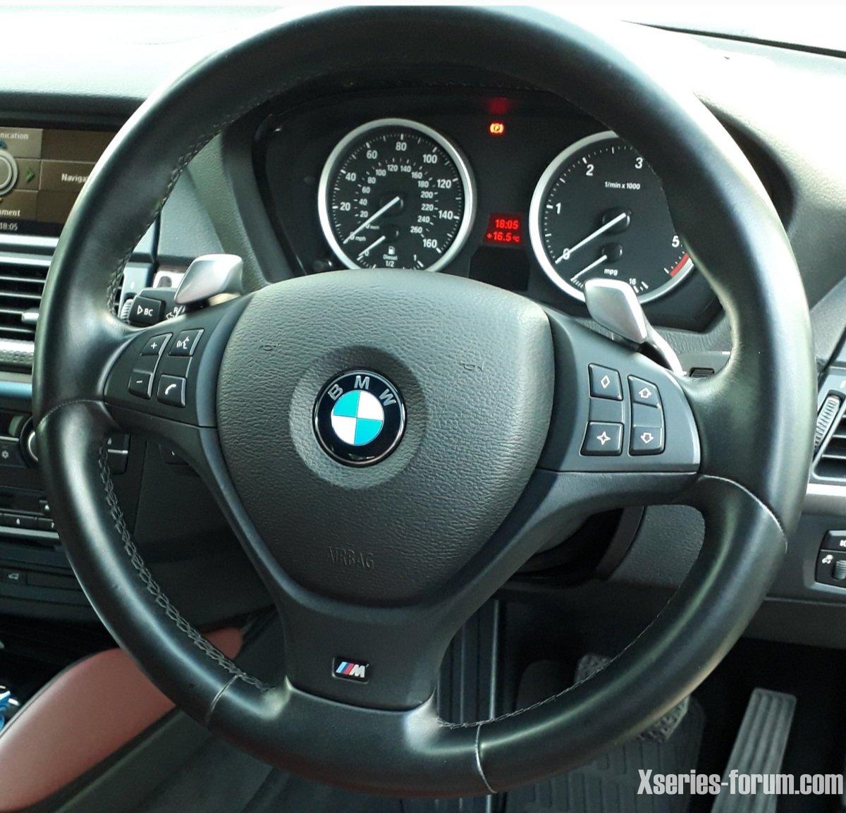

This got me thinking. Do your cars paddles look like these?X5Sport wrote: Fri Aug 01, 2025 3:26 pm CIC with Combox instead of TCU (telematics) was from October 2010. Paddle controls on mine are both moving in either direction rather than one up and the other down. I don’t think BMW changed that until the E71 became the F16 (but may be wrong) in 2013 or so. It never got the LED angel eyes either.
Or like these?

The lower version.
I also have a switch in the middle of the right hand inboard pair for steering wheel heating.
