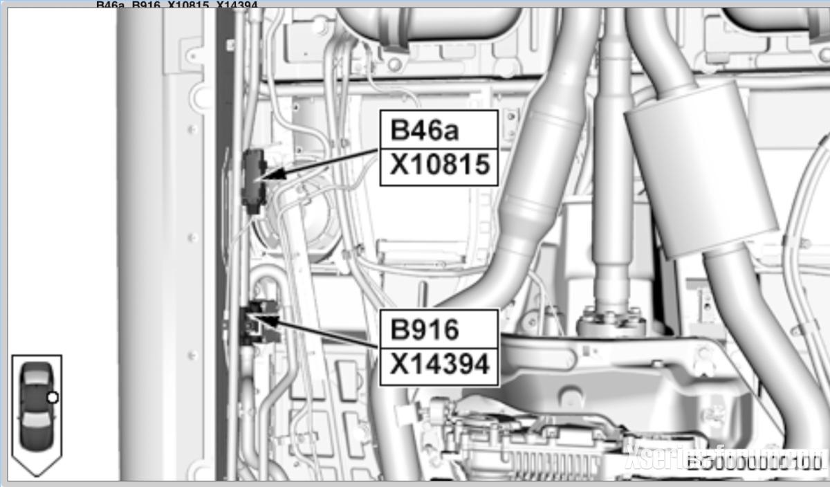

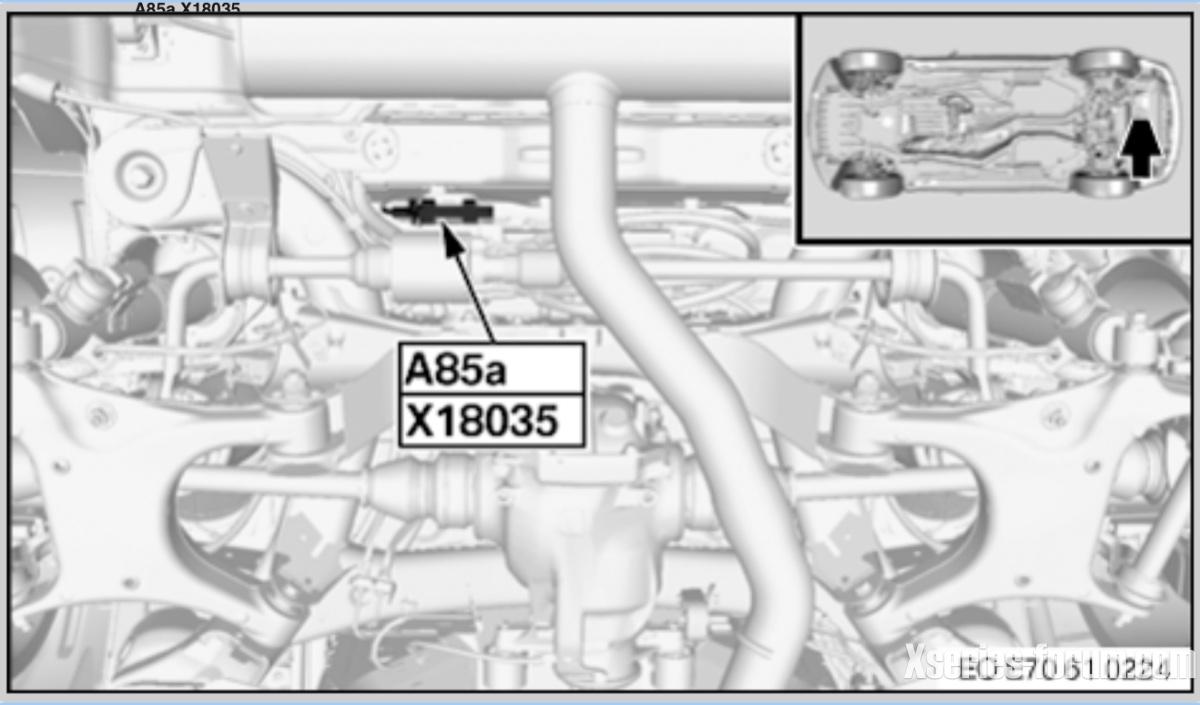

The RDC module (A85a) is showing as being here:
There may also be antennas in each wheel well behind the arch liners.
There is an antenna module (B46a) underneath as well.
