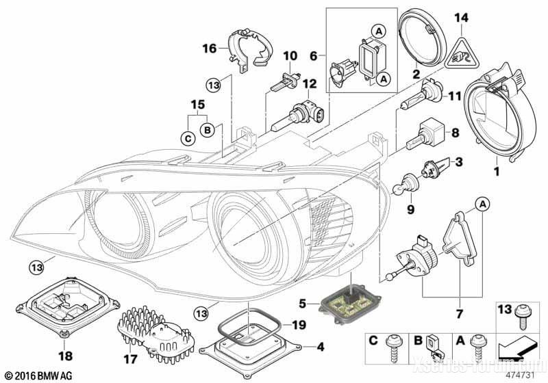

Realoem suggests H7 for dip and H1 for main on vehicles without Xenon lights.

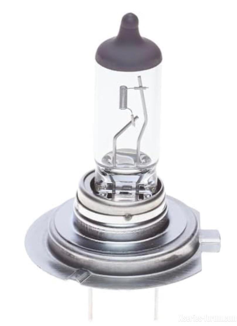

H7 doesn’t have a twist lock….image below is a Bosch H7 12V / 55W

Yes, you're correct of courseX5Sport wrote: Sun Jul 06, 2025 2:50 pm H7 doesn’t have a twist lock….image below is a Bosch H7 12V / 55W

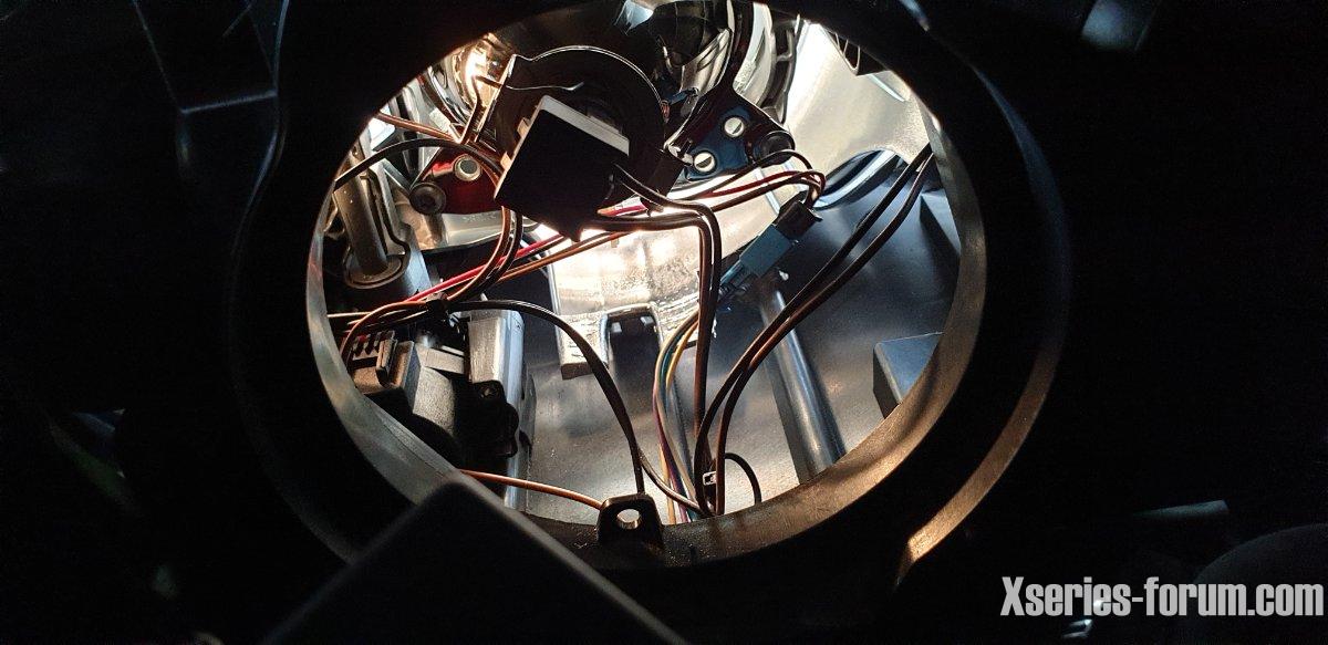

OK fellow owners, who can identify this bulb in the projector low beam?
For sure the low and high beam bulbs viewed from the rear are different, further suggesting handbook information errors.

realoem isn't much help as the image shows just about every combination for Halogen and Xenon in one small exploded drawing item 10 and 11 are the culprits

I did wonder if the black block visible in my image was indeed an H7 connection point. It seems it is. Disconnection easy, theoretically, but i note your points.
