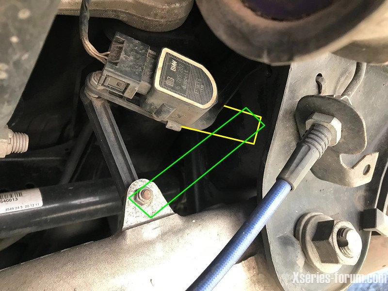

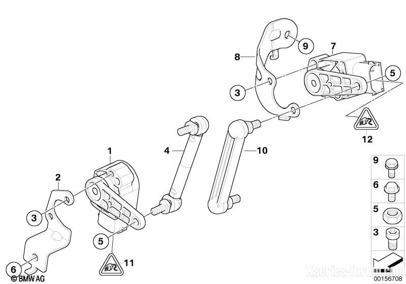

Post by Greydog » Wed Jun 25, 2025 4:20 pm
Here are a couple of pictures pinched from the net one of the nearside sensor and one from realoem
The part number is 37146853754

Still some uncertainty in my thoughts. The part number so kindly provided, when entered into RealOEM shows it as a headlight level sensor not a ride height sensor. The schematic looks the same as shown here but i wonder why the different, and to me slightly confusing descriptions? I can see that they probably mean the same thing.
