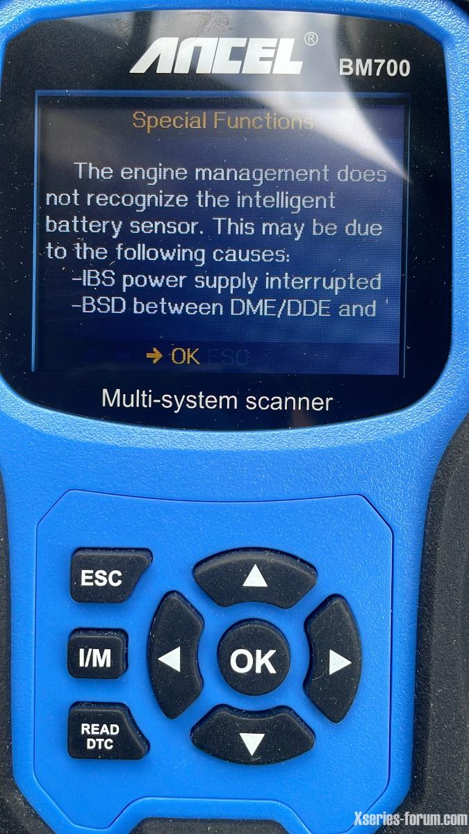

I ordered an Ancel BMW scanner and ran it and it said the ECU did not recognise the IBS so took it back to garage yesterday and they have installed a new IBS but got home and original charging fault error has come back and ran the scanner and it still does not recognise the IBS. It’s cost me over a grand and still no further forward. I have checked to see if anything is draining it and nothing else seems to be on. Unplugged everything I could and I don’t have CAS doors. Anyone had anything similar. I picked up two other codes, one for EGR sensor and one for transfer case oil wear which I doubt will be connected. Driving me batshit crazy 😩

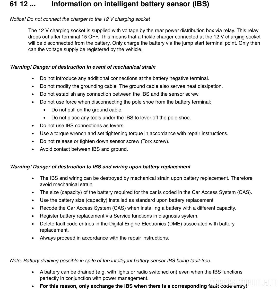

The following notes are in the BMW technical manual for the IBS: Installers have to be very careful with it or it can be destroyed.

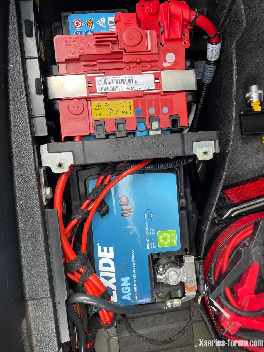

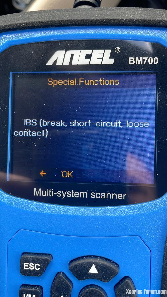

Yes the doors were closed and engine was running when the charging fault occurred. I just went to start it this morning and the high rate of battery discharge error came on again. I checked the jump start terminals and they seem ok. This is the error showing when I run the battery scan.

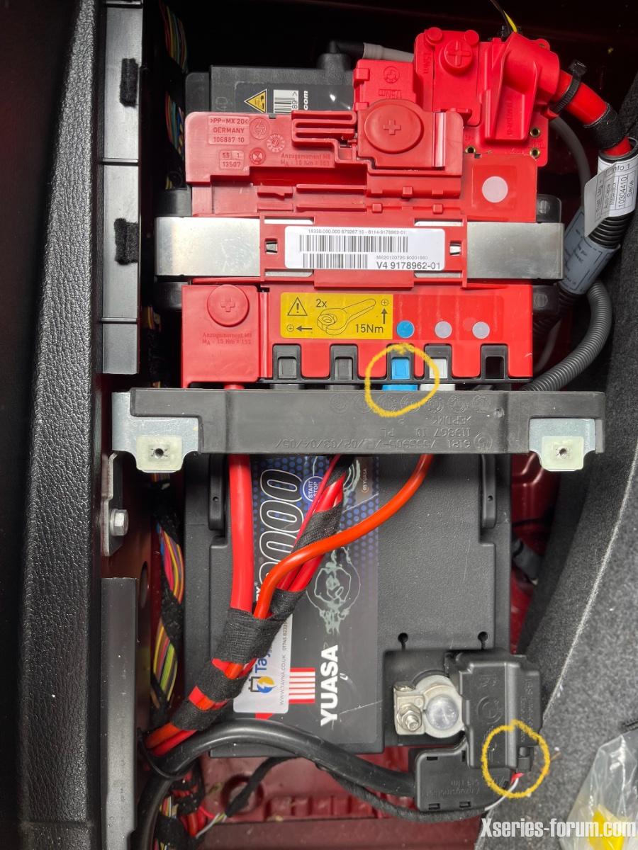

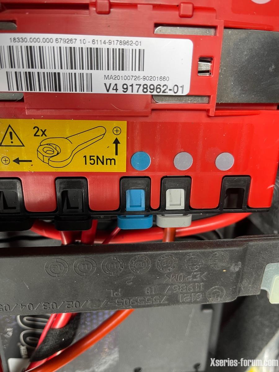

Have they actually plugged it in? The IBS Sensor is the block on the -ve cable. It contains a CAN Bus device pcb and is static sensitive. Mishandle it and game over! Mishandling in this case means not wearing a static strap, dropping it, undoing the wrong nut or jump starting the car at the battery itself. The image below is the top of my E71 battery so you have something to compare with. I’ve marked the two relevant points with yellow circles. The connector must be plugged in at both ends.
and closer…the blue connector.

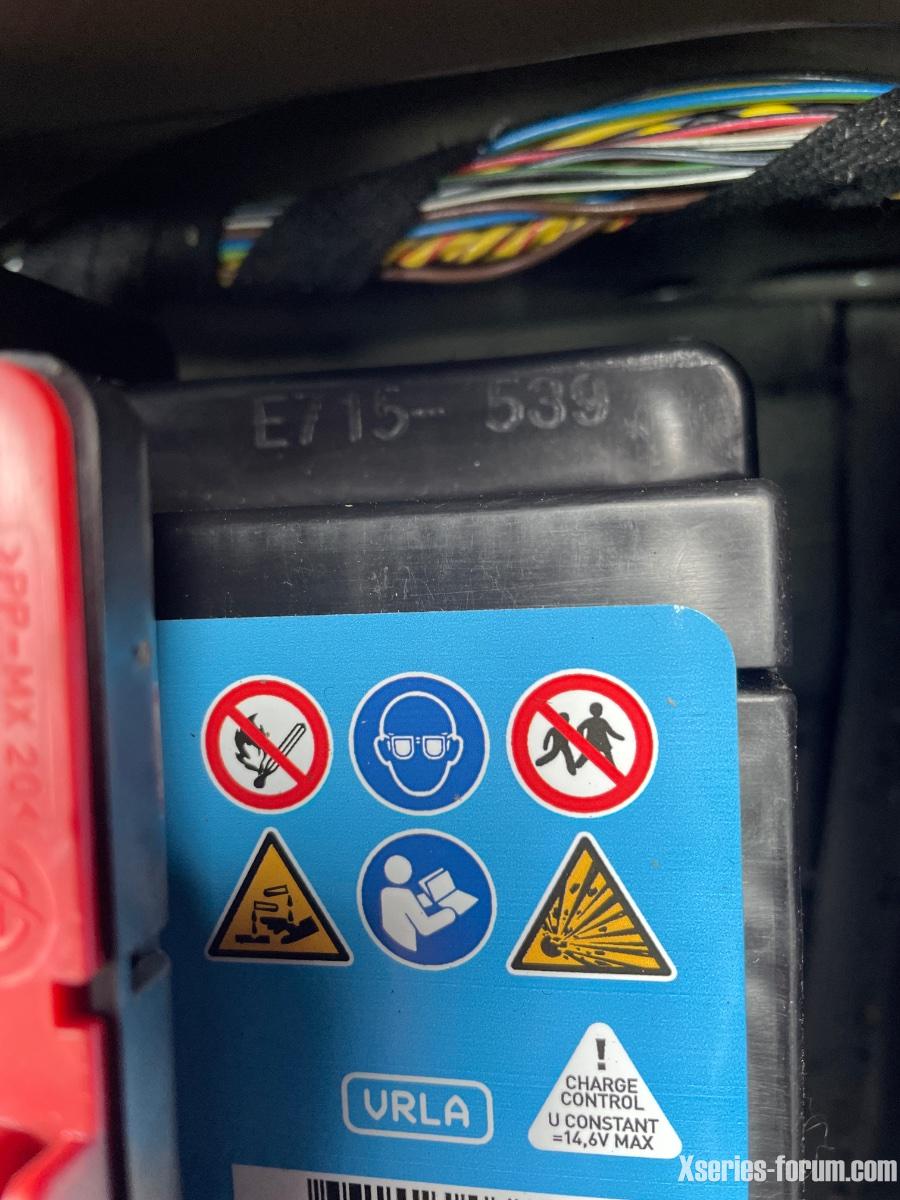

Ok, I checked and it all appears pretty much identical to yours. If I try coding the battery with my scanner, would the number in the second picture be required? Or would it be the number on the battery bar code?

Recoding the battery needs no more than it’s type (AGM) and current rating - mine is set to AGM 90Ah. The battery is an AGM 95Ah but that option isn’t listed on my coding tool.
Interesting that the IBS unit is unprotected - as in bare - given it’s a sensitive component. Maybe BMW went cheaper later.

Hi thanks for your replies, I will have a look at the earthing points. I’m not sure what you mean by doesn’t have a cover. The whole battery was covered, I had to take it off to get the pictures. I can’t see how it could have taken a knock as there was nothing could get to it and it was just fitted the other day.

The IBS should have a fully protective cover as it does on mine. It’s the device on the -ve terminal. It needs protecting from mechanical impact as well as static discharge. Yours is ‘bare’.
