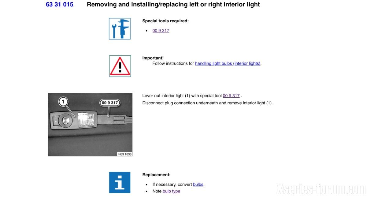

Managed to find this under the switch cluster instructions. Not even mentioned under the lighting sections! Note the special tools are just plastic trim removers. The first is a wedge type and the second look like credit cards. If you have one, wear an anti-static wrist strap, if not make sure you regularly touch an earth or piece of metal of the body. I don’t think the eCall system works any more as it may well be 2G or 3G only. It was routed via Vodafone in the UK.

X5Sport wrote: Tue Apr 15, 2025 6:08 pm Managed to find this under the switch cluster instructions. Not even mentioned under the lighting sections! Note the special tools are just plastic trim removers. The first is a wedge type and the second look like credit cards. If you have one, wear an anti-static wrist strap, if not make sure you regularly touch an earth or piece of metal of the body. I don’t think the eCall system works any more as it may well be 2G or 3G only. It was routed via Vodafone in the UK.

Where did you find that, TIS? Id also like to see the instructions for the two rear lights if thats possible?

Old copy of the TIS. I’ll see what the rear light comes up with.
EDIT: These lights? Same wedge too used. Two lamps according to the good book, both are twist type.

Well the later TIS for the rear lights seems inaccurate? Its not rocket science effort to prise on the light fitting as indicated, but the one side i tried wouldn't budge. Im wary of breaking things, nothing BMW badged is cheap.

I’ve only got the old version. No idea what it’s dated to cover but I have found errors and omissions in the past, pages missing etc. The ‘current’ version is now paywalled and we know the BMW have in the past put cease and desist orders out on any on line versions. Sorry if this one didn’t help :cry:
