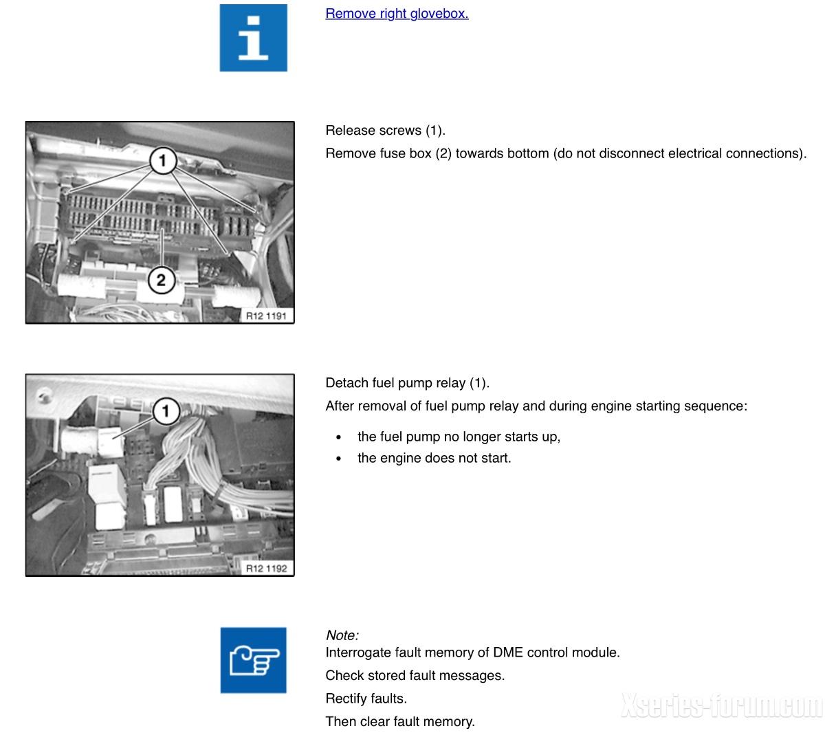

Just a thought. Check the fuel pump relay. You’ll need to drop the glovebox and then the fuse board above it as the relay is on the back.
The image below is from the LHD model, but having had exactly this on our E53 I know where it is. The relay is about £10 (or was a few years back). Have a look at Realoem to get the part number. It’s not an unknown issue. If it fails then the fuel pump won’t run.
Realoem has this page: https://www.realoem.com/bmw/enUS/showpa ... Id=61_4036
Part is common across multiple BMWs and all E53s. It’s light green from memory.
When mine went it cost over £200 in diagnostics to find a £10 part. The Indy went looking for all sorts of other things before the relay was identified as gone bad. I wasn’t impressed…..and stopped using them altogether shortly after (they’ve since gone bust anyway). My wife had taken the car to Wales and had to come back in a 1.0L Corsa with a speed limiter (hire car). She wasn’t impressed either!!
Might not be this, but for the sake of a few quid and use of a screwdriver, well worth eliminating.

It was the ‘no fuel pump’ bit that made me think relay. Every day’s a school day. I’d not have considered something as simple as flooding. Duly noted.
