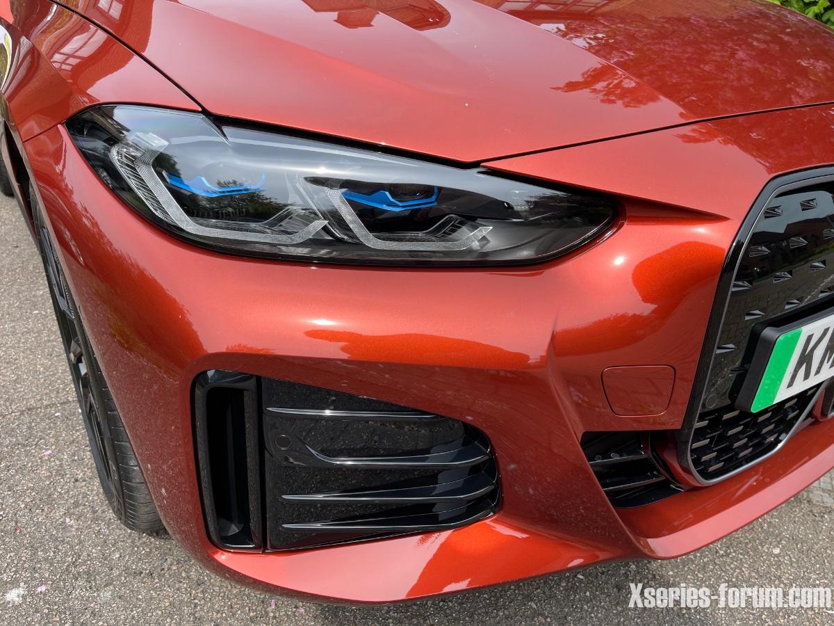

There was an official LED upgrade kit offered by BMW. £6k and a lot of wiring work and coding. These don’t look to have a number of requirements met - no sign of E Approval only DOT. May well be an MOT fail in the making.
Can’t see any sign of a laser warning label, nor are they marked with anything other than LED.
This is what proper laser lights look like - and the laser only comes on above 35mph when high beam is also on. Provide a ‘spot beam’ within high beam.
They are without doubt the best lights I have ever used. High beam lights 1/2 mile of road ahead. Sadly BMW have now discontinued them as they have started using Megapixel LED units.
