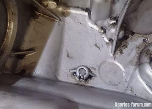

Has anyone sorted a cross threaded oil sump thread on this M57 engine?
Attempted a M12 x 1.5 helicoil repair but can't get the tap to engage and run through the hole. I think this is because its a partial hole, as part of it is missing to allow oil to drain from bottom of sump:
Just watched a video on sump replacement and its a big job, so looking now at a time-sert repair but still costly.

Are you sure it didn't have a helicoil already ? , bit of a weird looking setup that would be prone to failure, if it didn't have a helicoil before it would need drilled bigger first with the correct drill before tapping or the tap will likely split the sump as its too big for the hole.

That photo is not mine, taking the sump off is a monster job which would lead to car scraping for me.
No helicoil was installed, I posted the picture to show the incomplete hole.
