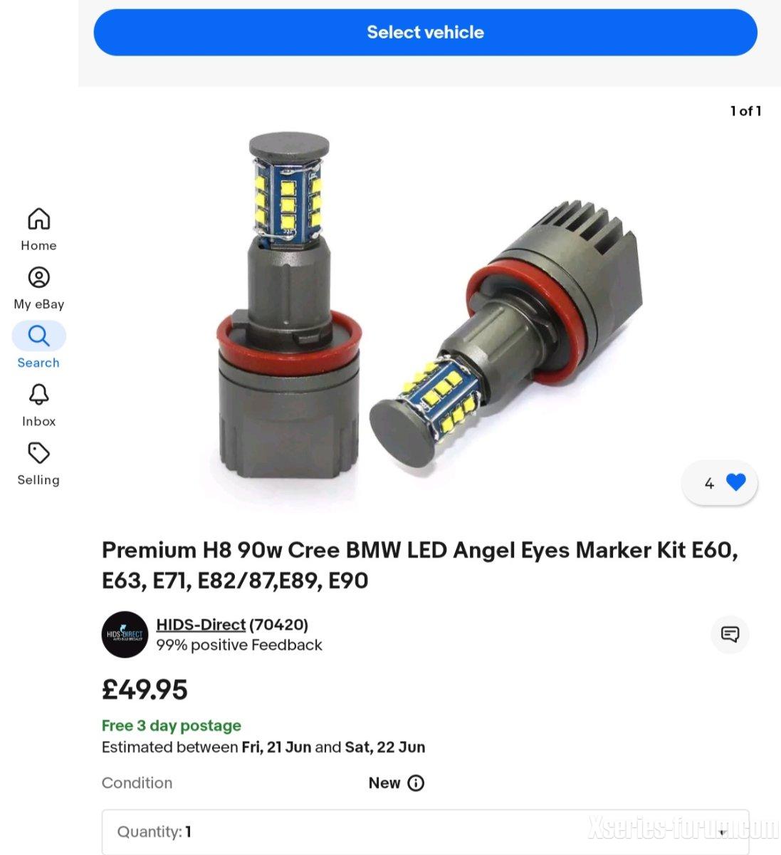

HID direct are promoting Maruta, one option is a cool £170 but suggested as the very best for angel halos? The eBay references are, 274931384852 & 374207516309

As you can see these are suggested for numerous BMW models and have an inbuilt resistor. If theyre no good, they'll go back.

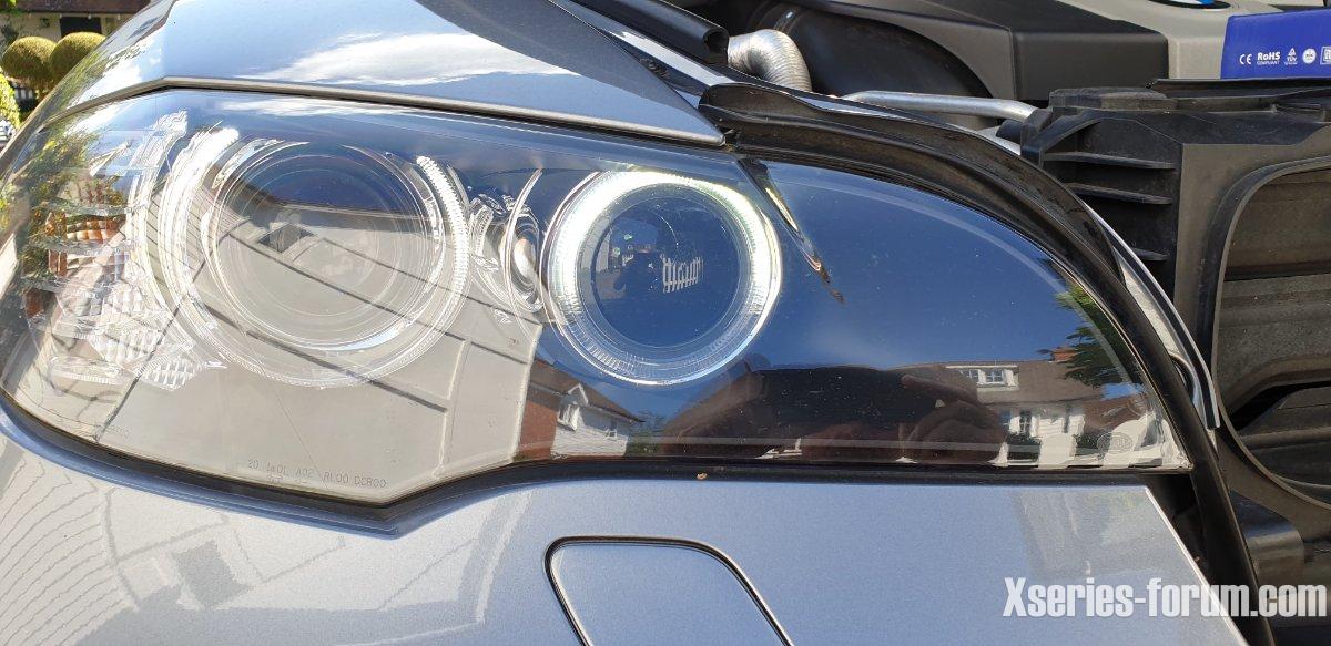

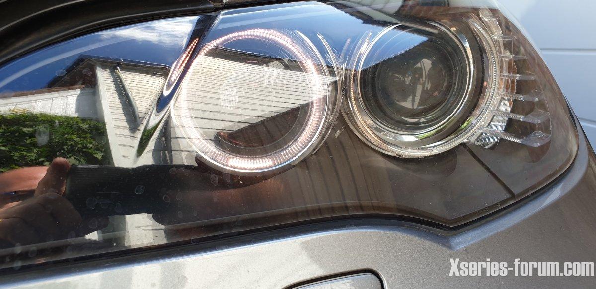

Oh well, not really surprised that these disappointed
. Pictures in daylight aren't the greatest idea, but for the money and the literal pain in my hands created in fitting just one side, its not worth the money or effort. They will be returned.
