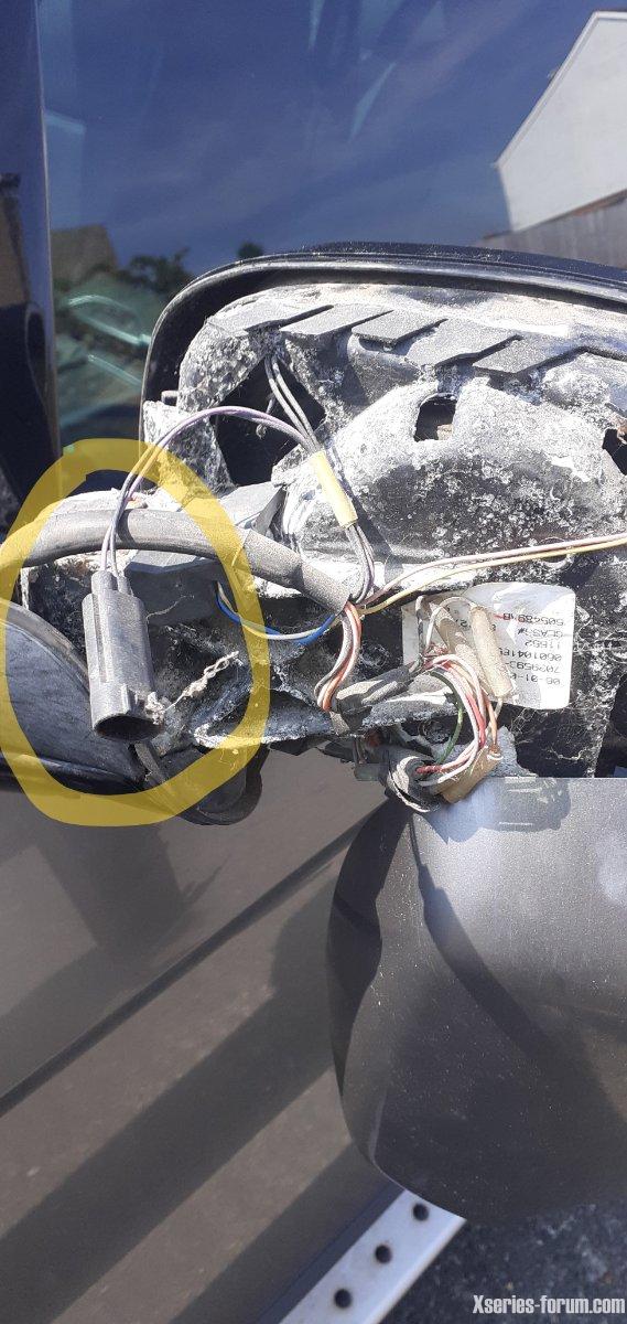

took off the cover from the passenger's mirror to have a look. The switch seems to be intact and clicking ok, but there is a connector that connects to nothing. I am attaching a photo with the connector highlighted. Anybody knows what the connector is supposed to be connected to ?
I have bought mountings and gears for the motors so I know it is probably not that, but I am curious to see if something is not properly connected.
thanks

Think that’s for the puddle light, certainly has nothing to do with folding problem. More than likely it’s the micro switch slightly misaligned. If they have been folding then the motors are probably ok. I have a pair in the garage and I’ll take a picture tomorrow of the micro switch you need to look at.

Thank you for your reply
I don't think it is the paddle light. That is still attached that is why the cover is not falling off. This is something else.
I agree it has nothing to do with the folding though.

E53 power folding mirrors.. a bit of help required
Its a long time since i delved into these but once troublesome, they become a significant pita. Best way to establish if the large connecter is/isnt for a puddle light is check the lens /bulb in the lower edge of the casing and trace the wiring back. Also check if there's illumination from the mirror housing. I dont recall seeing that large plug .

Thank you for your reply.sapphireblack wrote: Thu May 09, 2024 9:27 am Its a long time since i delved into these but once troublesome, they become a significant pita. Best way to establish if the large connecter is/isnt for a puddle light is check the lens /bulb in the lower edge of the casing and trace the wiring back. Also check if there's illumination from the mirror housing. I dont recall seeing that large plug .
I do recall that they are (obviously) linked, and if one side has issues the other side misbehaves. As a LHD design i believe the passeger mirror is the master (could be t'other way?) I spent days in total trying to resolve the problems with mine, switches, motors , all very fiddly work and gave up. I had both sides replaced for about a grand as i recall, and was just the internal guts and labour, door card off, etc. No new trims to enjoy after such an expense.
Yes, it is not pretty to mess with these..
I hope I wont't have to replace both of them. They are cheaper now, but still... the thrill of the repair...

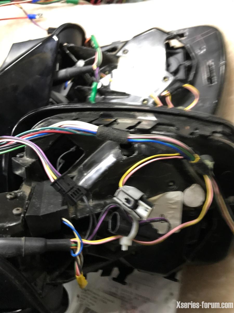

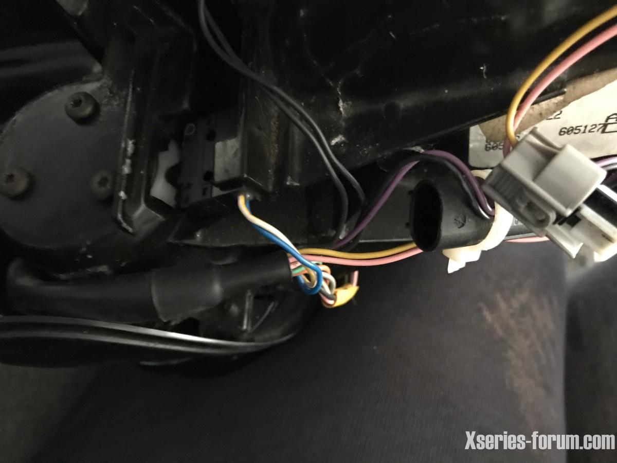

The first picture shows the grey and black plugs. They do plug into each other. The grey plug also plugs into the puddle light. The wires from the grey plug go to the black plug with 4 wires attached and that plugs into the mirror switch.
The second picture shows the micro switch with the blue/yellow/white wire and I suspect the micro switch under that cover is the problem in that it very slightly out of position. As already mentioned they are interlinked and your will need to check both sides.
