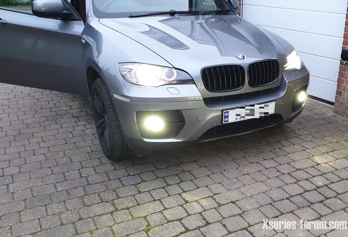

Just finished refitting the decor grills which are a pita to get out. This is a post that needs images which will have to follow.
Some Philips Ultinon 3021 now adorn the units and the difference is literally night and day as would be expected. Of course they needed Canbus adaptors but i made a great deal with a local eBayer selling some unused Philips ones for just £10. The bulbs were £30.
I need to sort out the halo rings now. They look postively dismal against the HIDs and LEDs, even though i upgraded them to better bulbs at the time, years ago now tbh. More research is needed :D

It wasn't dark enough really but the ouput is equal to the Xenons, imo
