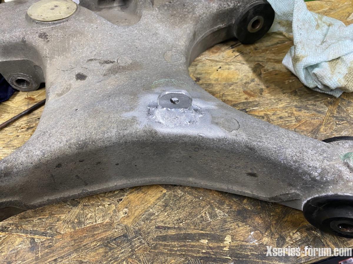

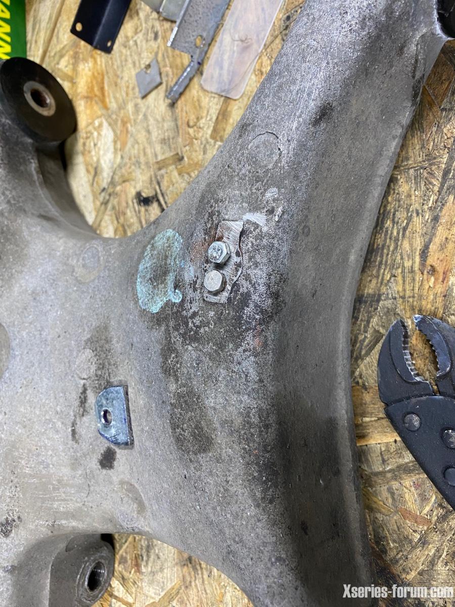

Thought I’d put up a few pics of the problems.

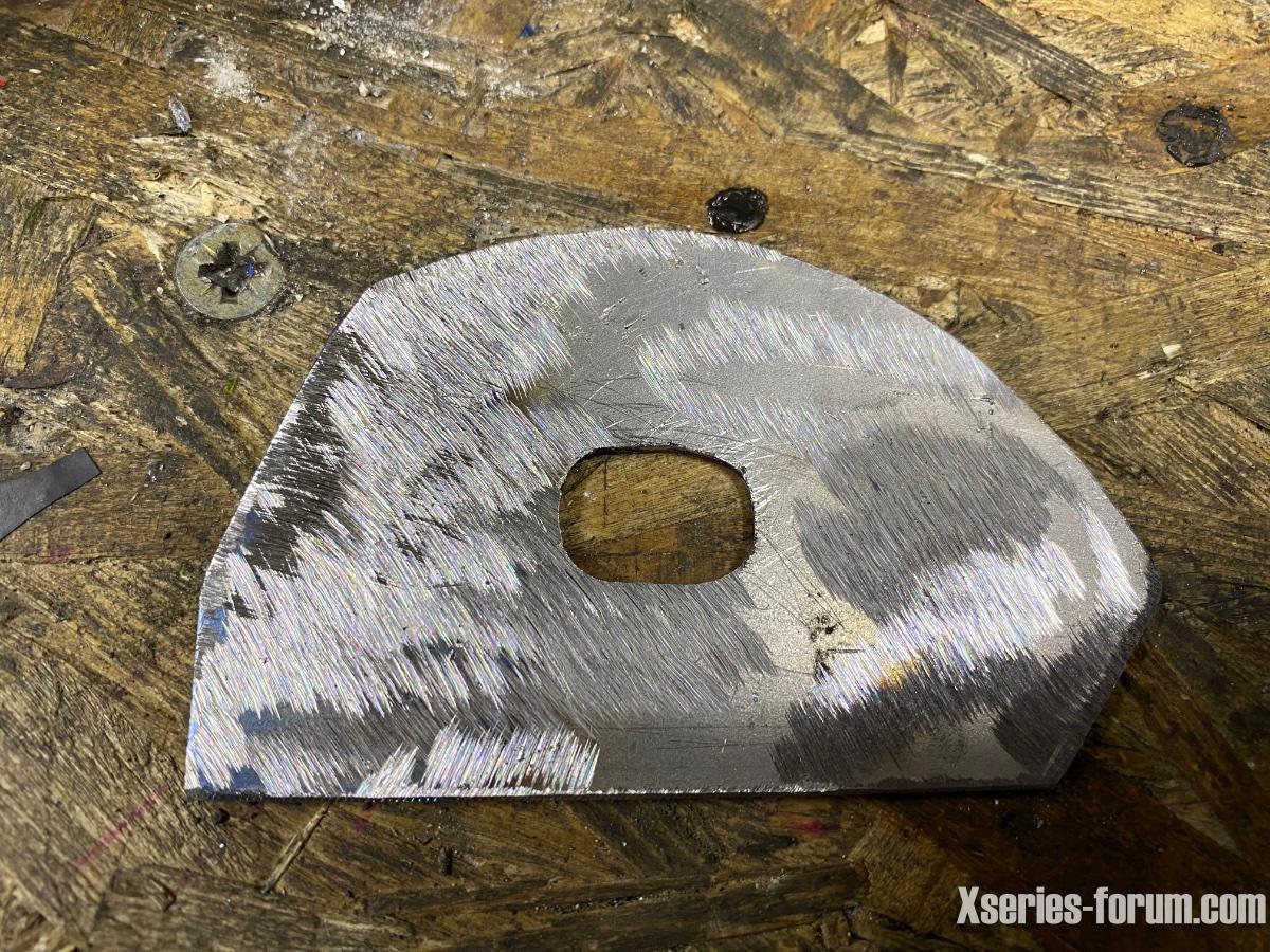

I drilled and tapped and was going to fabricate something but have decided to go to an alloy welder on Monday and see if they could weld a tab on.

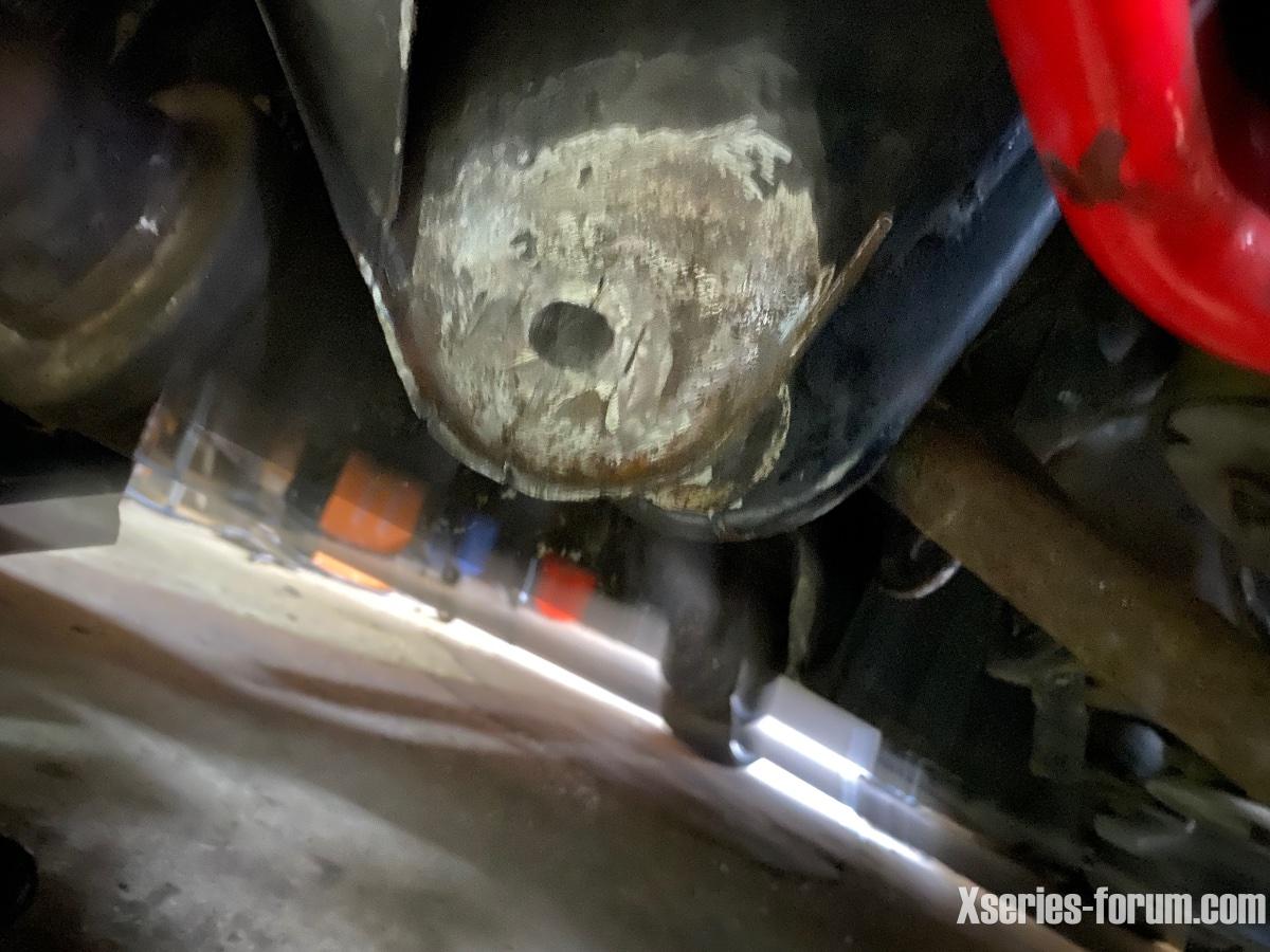

The second pic shows that the little tabs that the eccentric washers work on are gone. They reduced the washer movement by 50% so I got rid of them. Can’t decide if I’ll get now tabs on or weld the plate I’ve made and put the tabs on it.
Does anyone know if that bottom arm can be welded.

So gents the bottom rear arm can be welded.
