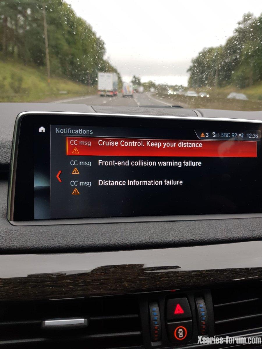

After owning my x5, a f15, 40d, I had a series of warning messages appear shortly after starting, all relating I suspect to the front radar unit mounted under the grill.
We were on our way to Devon, so continued the trip cautiously, stooping at Strensham services for z quick comfort break, after restarting the car all the errors had cleared, and everything worked as it should, three days later, we were returning from Devon and all was fine until we approached half way, when the same three warning messages appeared, we briefly stopped the other side of Birmingham and on restarting the car all the warnings had cleared and again everything worked as it should.
intermittent faults are probably one of the worst kind of faults to find and fix, initially I thought it could have been because the car had been stood for a while, and maybe have been low battery or dampness, however after a few days in Devon in 20C plus dry weather it suddenly reappeared 120 odd miles into the trip.
Has anyone had this problem and can point me in the right direction, I suspect it maybe a connector somewhere, but any help in knowing where to look would be appreciated, before I take the car into the dealership and get them to investigate, the car is covered by the extended warranty but with a £250 excess. so keen see if its just an easy fix like a corroded connector or damaged wire before I potentially give BMW £250.

Had the same messages some time ago and it was after hitting a big pot hole. Moved the wires on the sensors near the fromt wheels from the ABS, pad wear sensors and faults cleared. Had car checked out by indy and they found no faults. Happened some time later after going over more very rough ground. Fiddled with wires again and faults cleared. Now try to avoid pot holes and the car has behaved itself for months.

I’ve had a look at the TIS and just a note of caution when you go rummaging. The radar sensor is in a calibrated setup so beware of moving it. You possibly can’t diy it back into position and BMW use a special alignment mirror rig and laser, plus their usual software.
If you can get a code scan done, look for a misalignment warning. It’s just possible something off the road has knocked the sensor out of position.

The connector is on the left side of the radar head, however BMW ‘recommend’ that to get to it the front bumper panel comes off. If you can get to the sensor without physically moving it then you’ll be fine.

However early last week it started faulting again, so booked it in with dealer and after diagnosis, it’s the front radar unit that’s faulty.
A new one is on order for fitting tomorrow and then hopefully all will be well again, just got to pay the extended warranty excess. Will update again after I collect car from supplying dealership, who I must say continue to be very good, which is the main reason I still use them for service and repair, despite it being a 150 plus mile round trip from home.

New front radar fitted on 24th November however dealer was unable to get new software to load, so car still with them.
BMW Germany involved and dealer is still waiting for the software patch to arrive so they can activate, program and calibrate the new radar unit.

New software patch received by dealer from Germany yesterday upload to vehicle radar calibrated and all good, collected car yesterday evening after 15 days.
Very glad to have kept the extended warranty going on the car as the radar unit alone was over £2400 and that’s without fitting calibration etc etc.!
