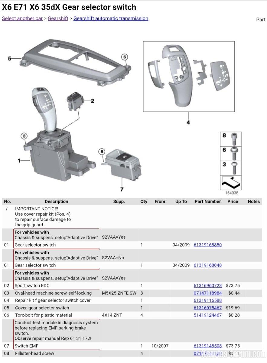

TIS was great though i used it infrequently. i can't find anything that seems to ' replicate ' what was once available.
I would like to obtain the RHD version of #4 to start off with, which is circa £90 😲 for a genuine part on eBay. If the P and perspex panel weren't compromised i could have bought a black or even a coloured frame, lots on eBay.

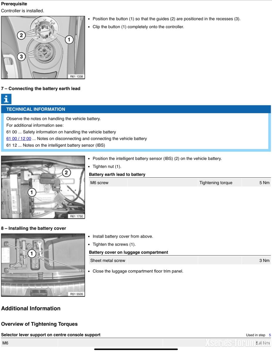

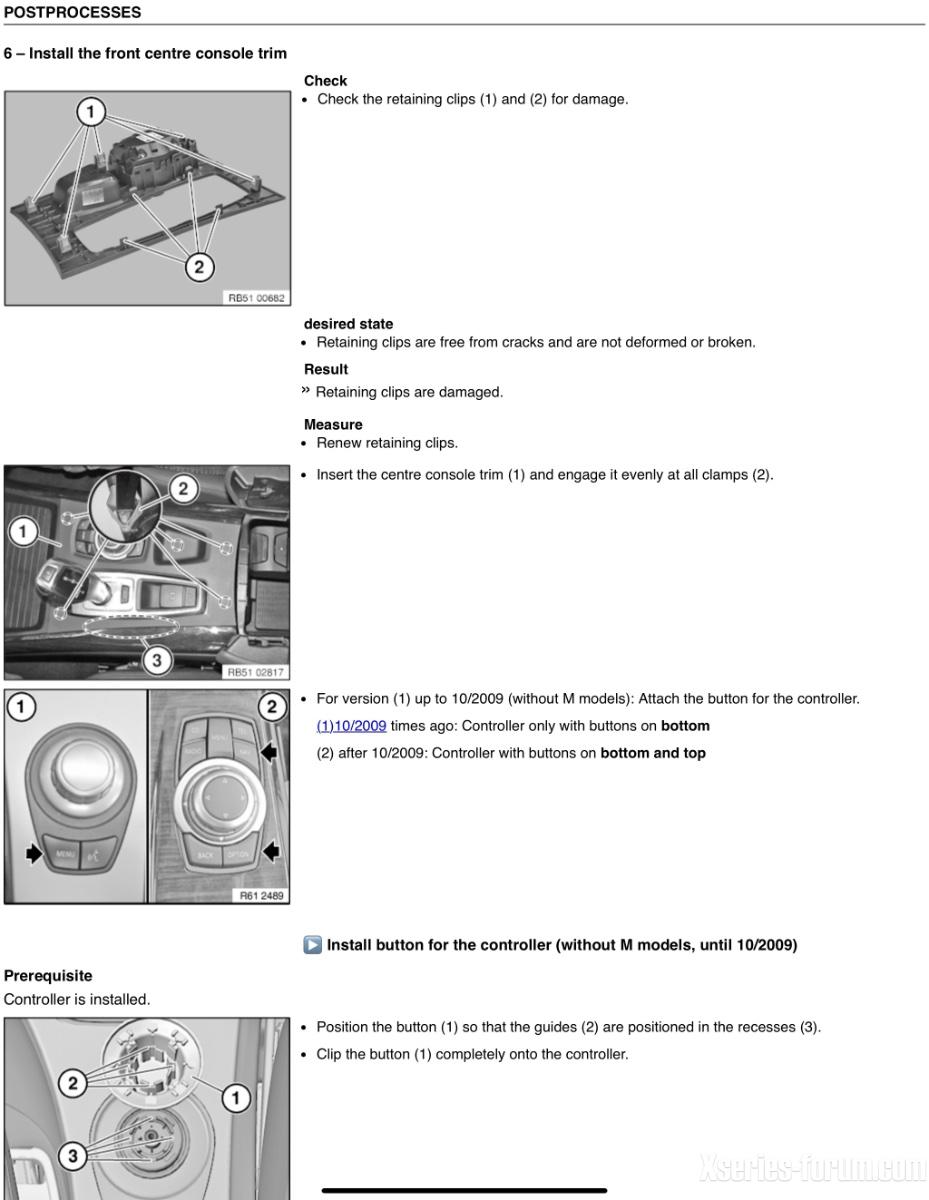

Post by X5Sport » Sun Sep 17, 2023 11:47 am
Instructions…..need to dis the battery first! If BMW broke it, shouldn’t they be fixing it? Do you need to take it all out?
Selector trim in next reply….

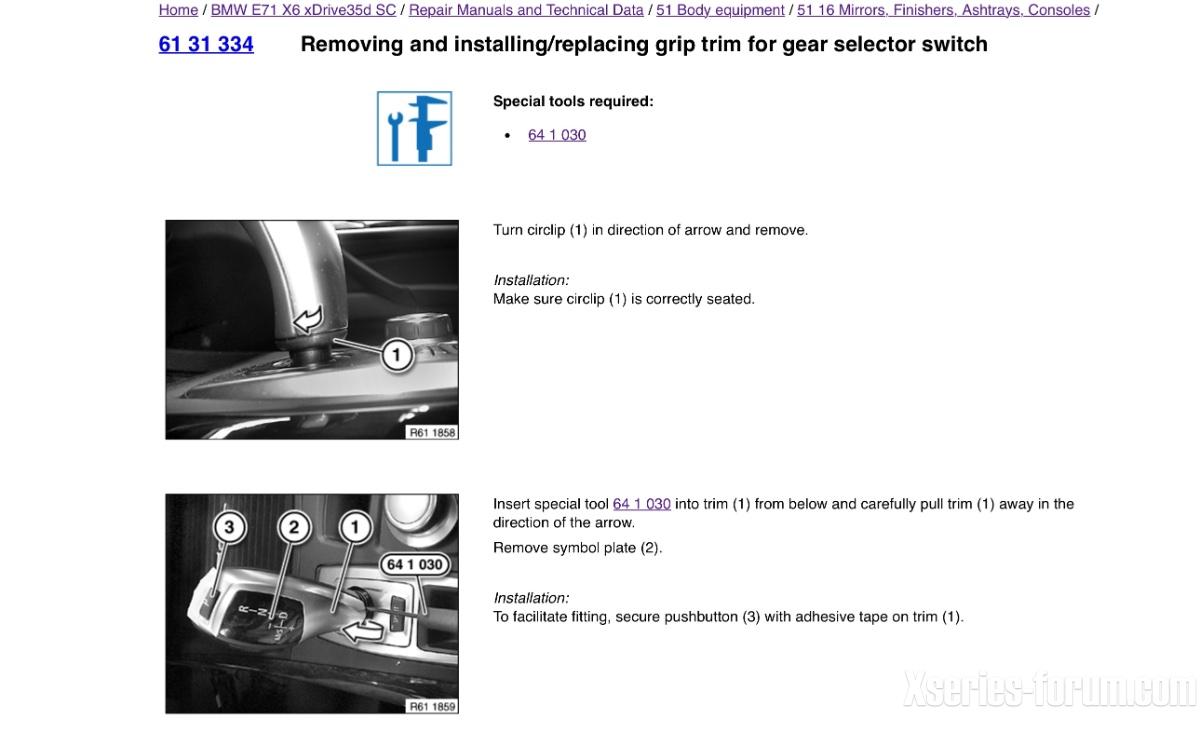

Post by X5Sport » Sun Sep 17, 2023 11:58 am
Selector trim:
Special Tool (bent wire):
Posts: 19217

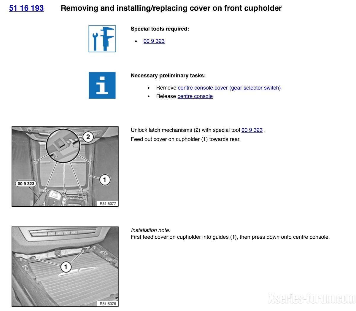

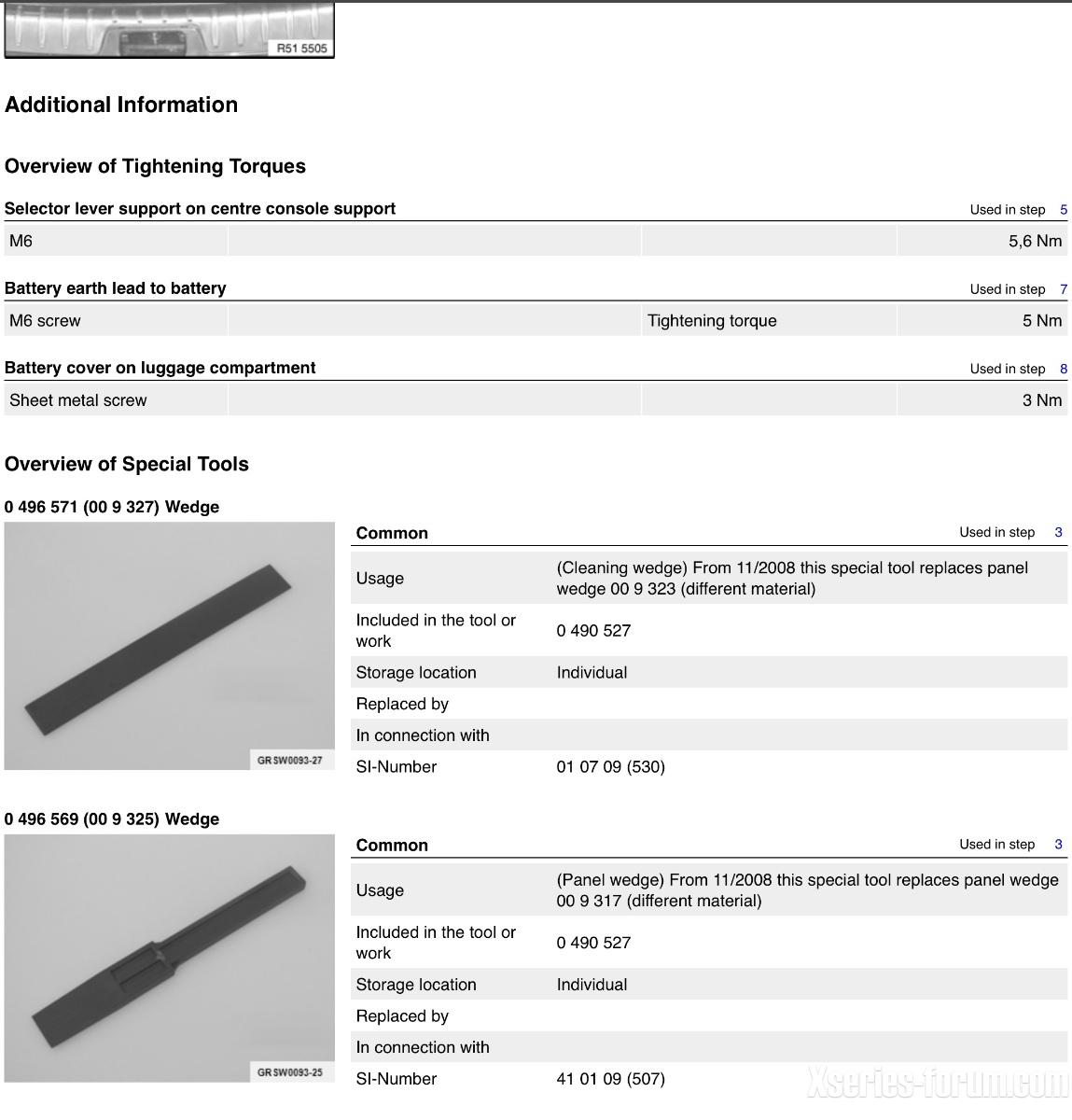

Post by X5Sport » Sun Sep 17, 2023 12:01 pm
Knee pad….
Special tools are trim removal tools you can buy pretty much anywhere.
