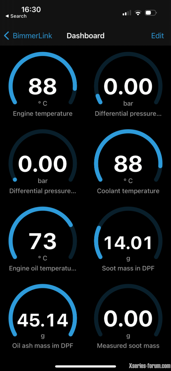

48EC - pressure difference between the charge air pressure (turbo out), exhaust gas pressure sensor (before turbo) and ambient pressure sensor is more than 60mbar. Could indicate an overloaded DPF.
48E0 - is linked to above. Pressure data between the sensors exceeds 150mbar (should be no more than 130mbar).
If the codes are still present then that suggests either a sensor failure or the DPF needs looking at. You could do with getting the ash and soot loads checked to see if the car is regenerating properly.
