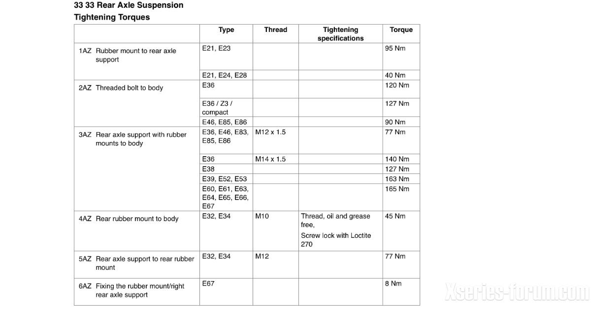

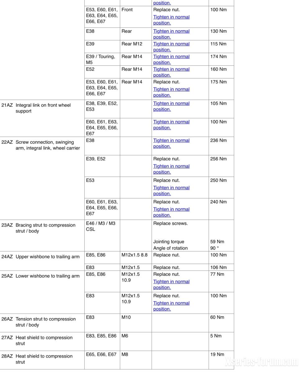

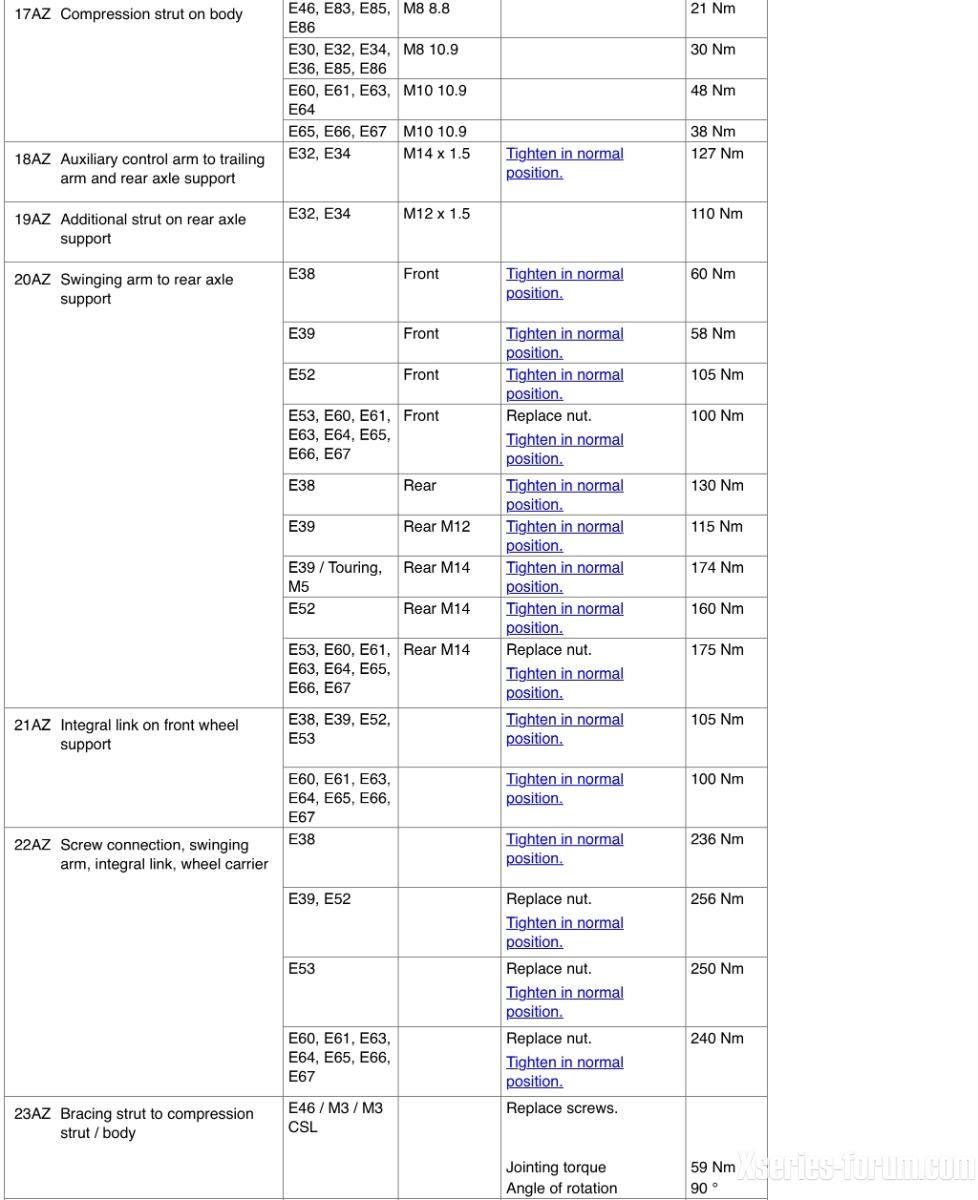

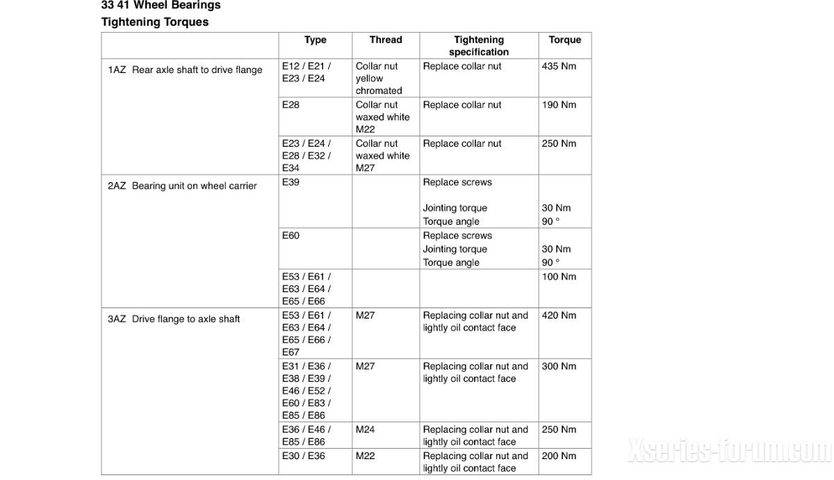

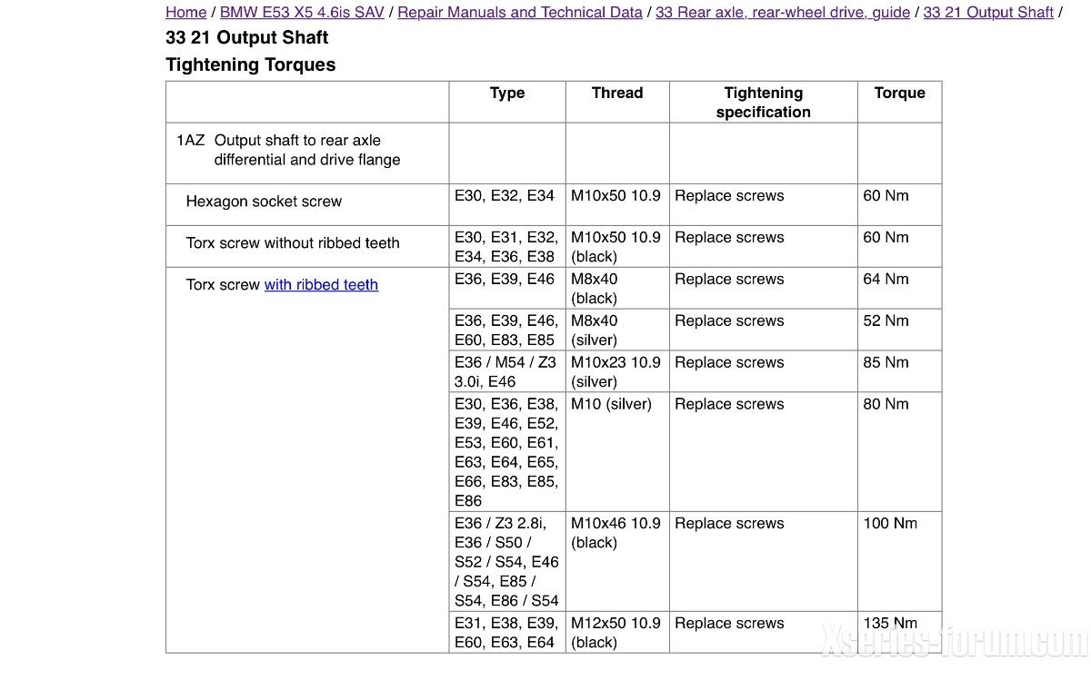

                  Try this lot…..some of the parts have different names to those you’ve used.
                  Posts: 19297
                  Torque Settings - Replacement of Rear Wheel Bearings
                  Post by X5Sport » Wed Aug 02, 2023 8:23 pm
                  Road wheels are 140Nm (+/-10) all round
                  Main hub nut is shown as M27?

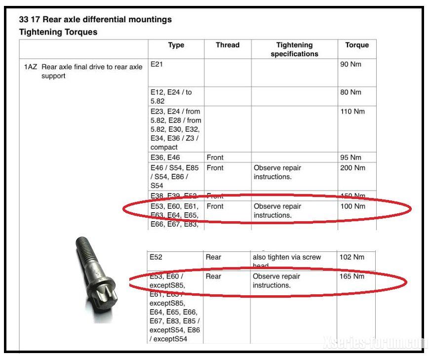

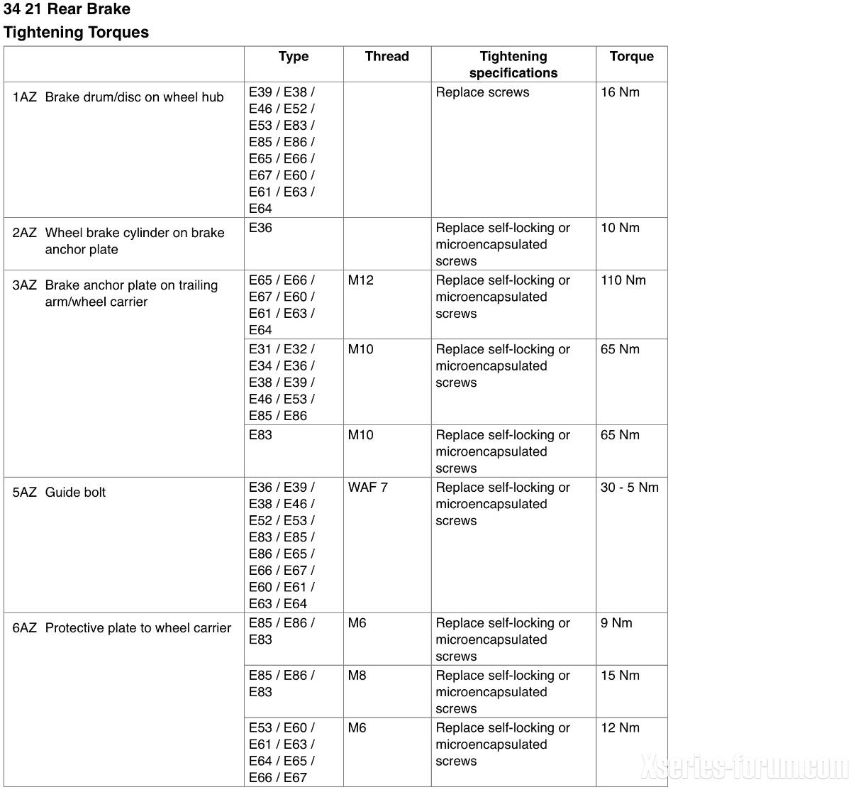

                  Post by X5Sport » Thu Aug 03, 2023 6:51 pm

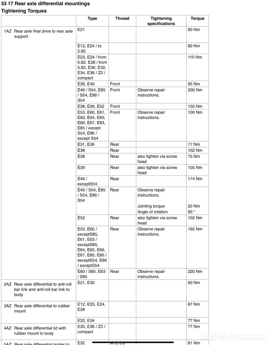

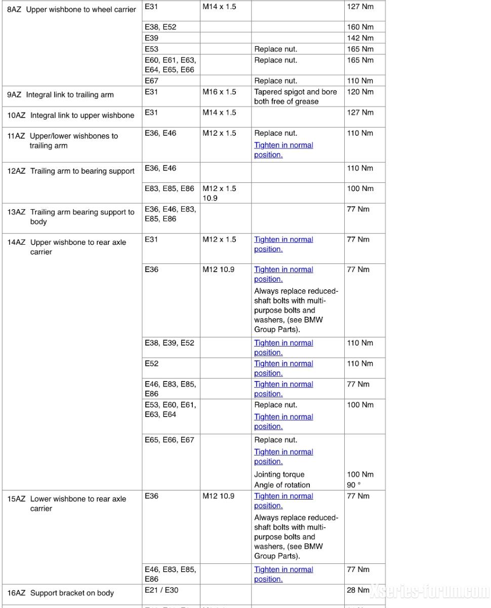

                  Two more…..

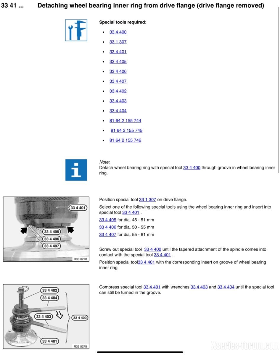

                  There’s a shed load of BMW special tools needed to pull the driveshaft & differential flange together. No idea if anyone on here has done it/had it done without them. That’s what it means by ‘observe repair instructions’. It might just refer to this:

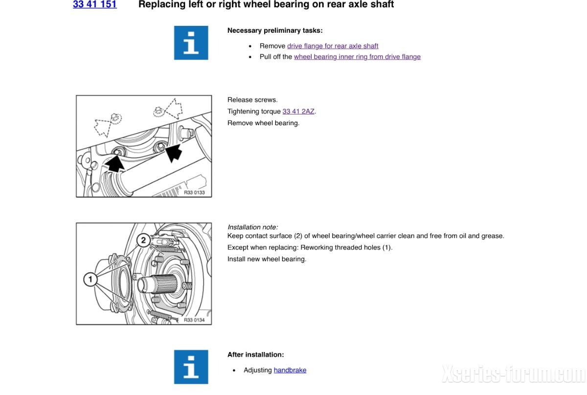

                  Post by X5Sport » Mon Aug 07, 2023 9:44 am
                  Not sure if this is any use….

                  This is the kit BMW Workshops use …

                  Post by henrym3 » Sun Oct 29, 2023 6:36 pm
                  I did all the wheel bearings about 4+ years ago when I also dropped the rear subframe some of the wheel bearings came out with my little 6 ton press, I had to put in a 10t jack for one which slightly bent the press. Like Leslie said some are a pain. Didn’t use any BMW special tools no doubt they would have made it all easier but at what cost.
