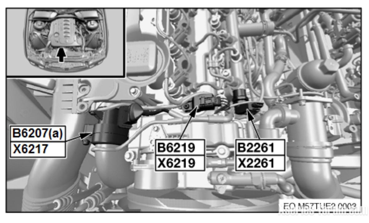

Hi. Reconditioned injectors. Not sure where the camshaft sensor is on the E70.
- Posts: 19267
E70 crank no start when warm
Camshaft speed sensor B6219…..

Thank you... I'll try that next. Just surprised it's not throwing any codes. Had it checked by two garages also but they couldn't find any codes relating to the symptoms.
