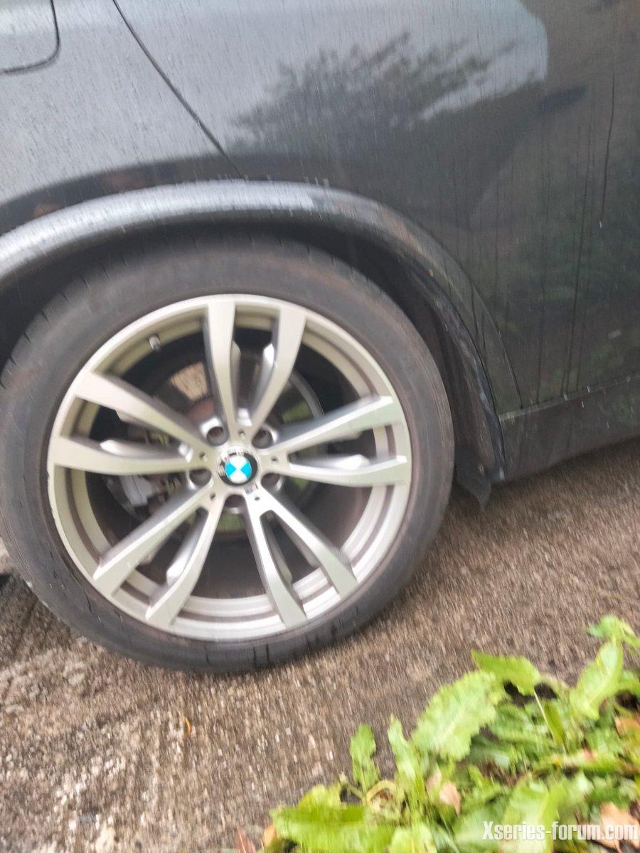

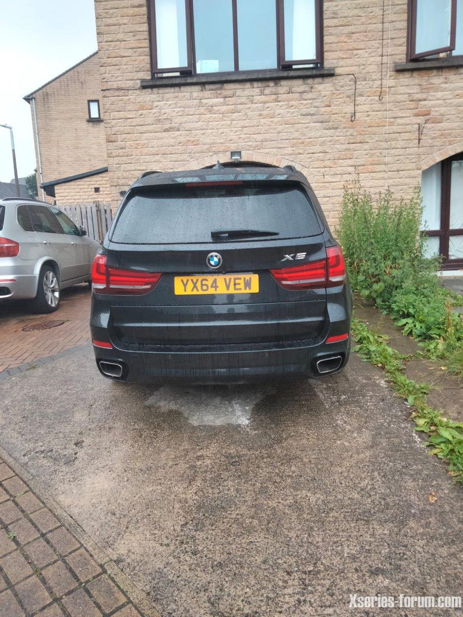

Hi so I got the F15 back after the engine rebuild, I have noticed car is sagging from one side rear drivers side. Thing is Sometimes it doesn't overnight and then on ocassions it sags within minutes. I have ordered the air bags, but don't understand why it's intermittent.
Pics attached
