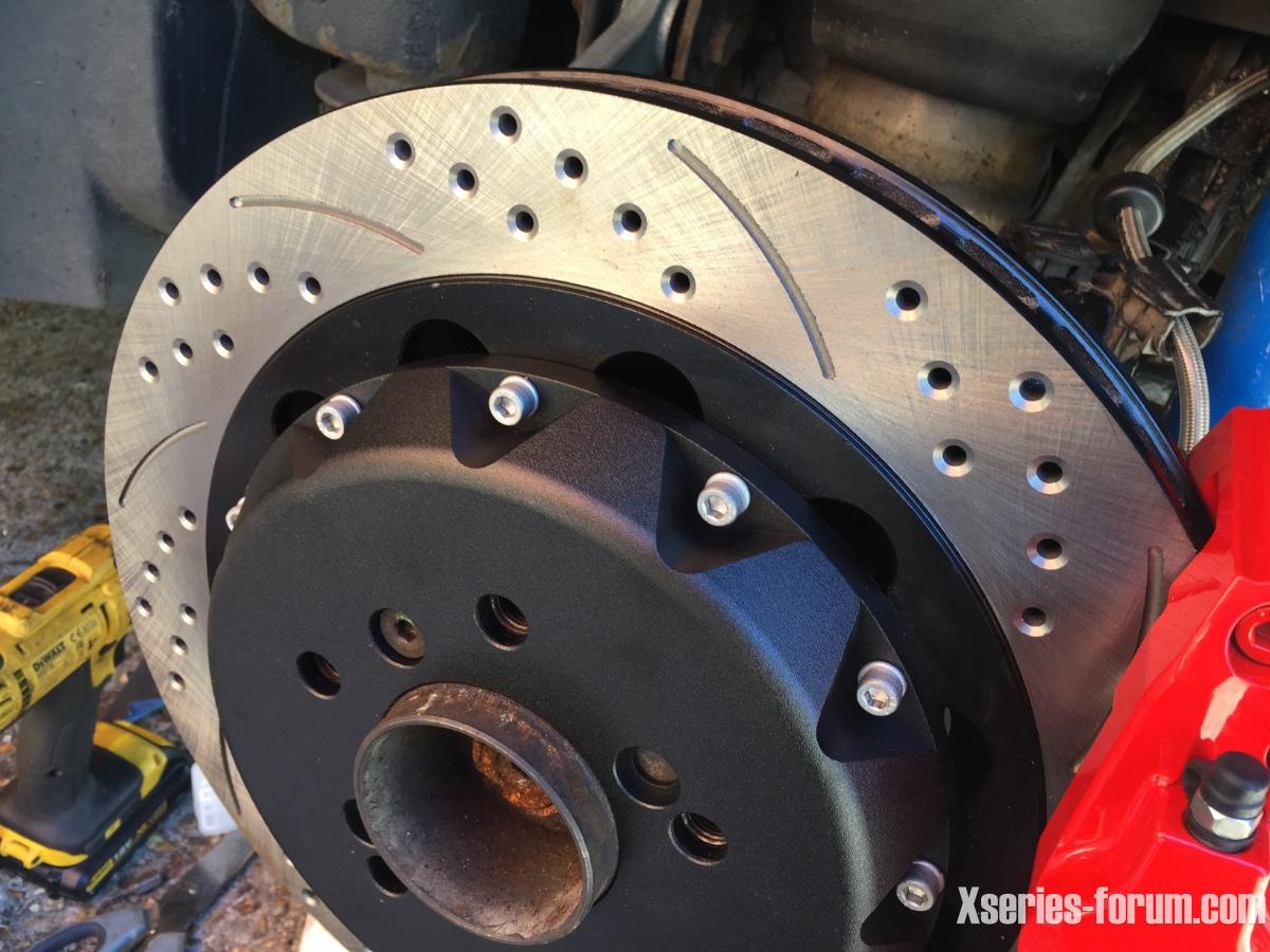

I was looking at putting brembo on my 4.4 but in the end I went for drilled and grooved rotors with some standard pads (can't remember the make but quality) and now it pulls up much better than it did before.
I must admit tho it would look cool with massive calipers on show behind the style 87's..
