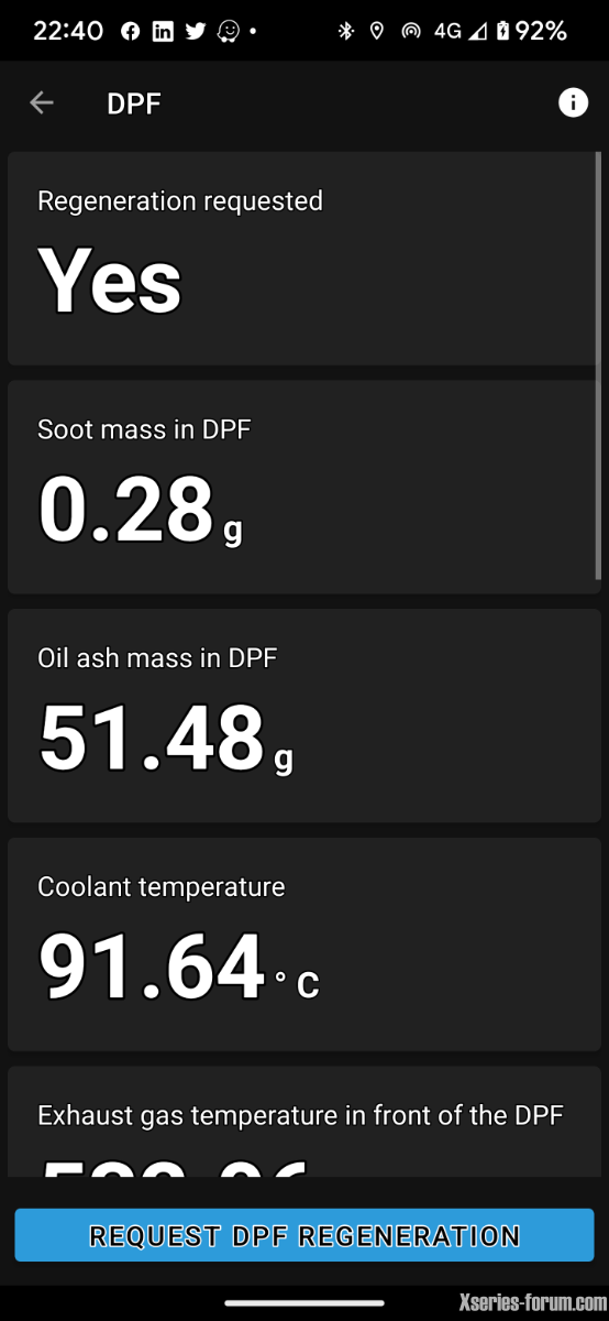

I did run the DPF module on Bimmerlink and its showing Oil ash mass in DPF as 51.48g, I'm guessing that could be my problem?
I'm doing 300 miles twice a week so guessing due to duration and engine & exhaust temp this oil I'm losing is burning off?

Ash build up over time and is directly related to mileage, regens only remove soot your soot has been cleared by a sucessful regen by the look of it. Ash is there forever till it reaches a certain limit then you have issues. I think I read before after 60 grams it flags up a code but it can still run fine after that to well past 200,000 miles. I did see a report of one at 230k in America got the warning at 150k but ran fine after
