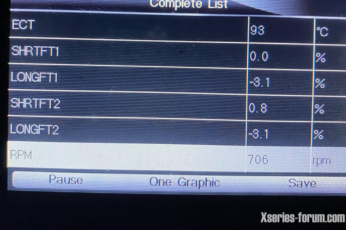

Post by henrym3 » Sun Feb 12, 2023 6:12 pm
I’ve changed the fuel pump and filter for Mehle items. Fuel pressure is restored to normal and I opened the old filter to see what 170k internals look like. I was curious as when I emptied the old one what drained out was the colour of coke. Start is instant and no stall. However short term fuel trims had gone to -25 on both banks, this was reset to 0 done some driving and they are stable as expected.
Then went to Dorset LPG to get the lpg map to try and mirror the fuel map. Need to do a good few miles to now to ensure it maintains the fuel trims.
