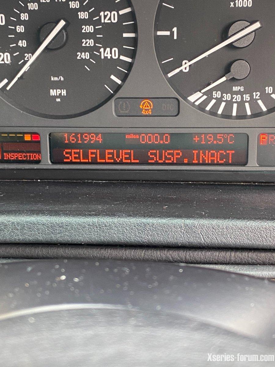

Hi all,

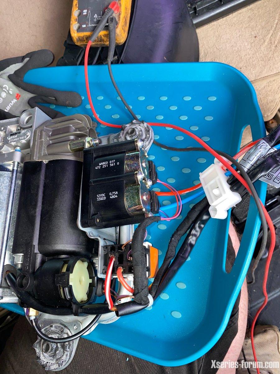

I have seen other posts about this fault, but they don't help with my issue. One day the fault came up, but once you switched off and on it went away, eventually it stayed on, rear suspension did not go down. I googled the fault and there was a lot about the pump piston ring worn, so I removed the pump and wired to switches to turn pump on and operate the solenoids, pump worked suspension went up, after about a month the rear of the car went down and damaged a air bag so I replaced them, I got a copy of inpa and used it to operate the pump and raised to the correct level. Then I read about the module down the side of the battery, checked it out and yeah it was full of water, I bought a used working module and installed, still had the fault, cleared all faults with Inpa but fault still showing on the dash. I then replaced both level sensors on the back suspention, fault still on dashboard, took it to the garage for them to clear faults, they reported there were no faults showing. At the moment every 4 months I have to connect with Inpa and pump the system up.
Can anyone help? This has been driving me mad for over a year

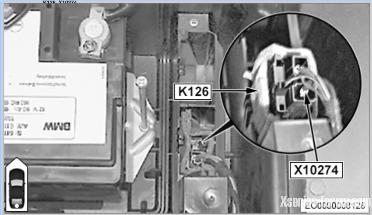

Relay K126 - and it’s to the right of the battery so may have got wet in your earlier incident…X10274 is the connector plug.

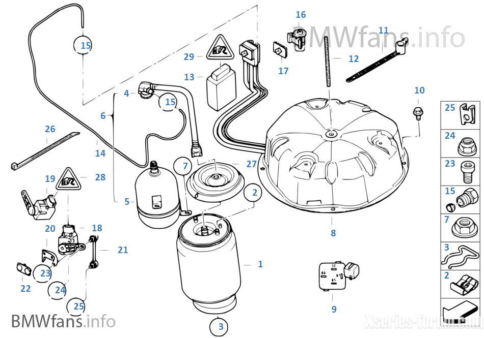

That is a picture of a 2005 3ltr d and item 9 is a relay. So I assume you have one tucked away somewhere

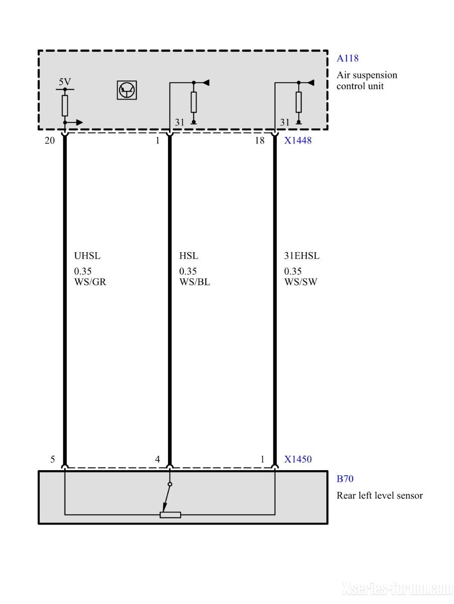

Reading this through again it’s quite likely the wiring to the sensors are damaged. Let the suspension down then disconnect the levelling rods and move the sensor arms by hand and see if it activates the pump, disconnect the wiring plug and ensure it’s clean spray some contact cleaner on it, trace the wires as far as possible for breaks. If all fails do a continuity check to the module. PITA but you’ll pay a fortune to get a garage to do it
PS
Someone might have a wiring diagram for wire colours

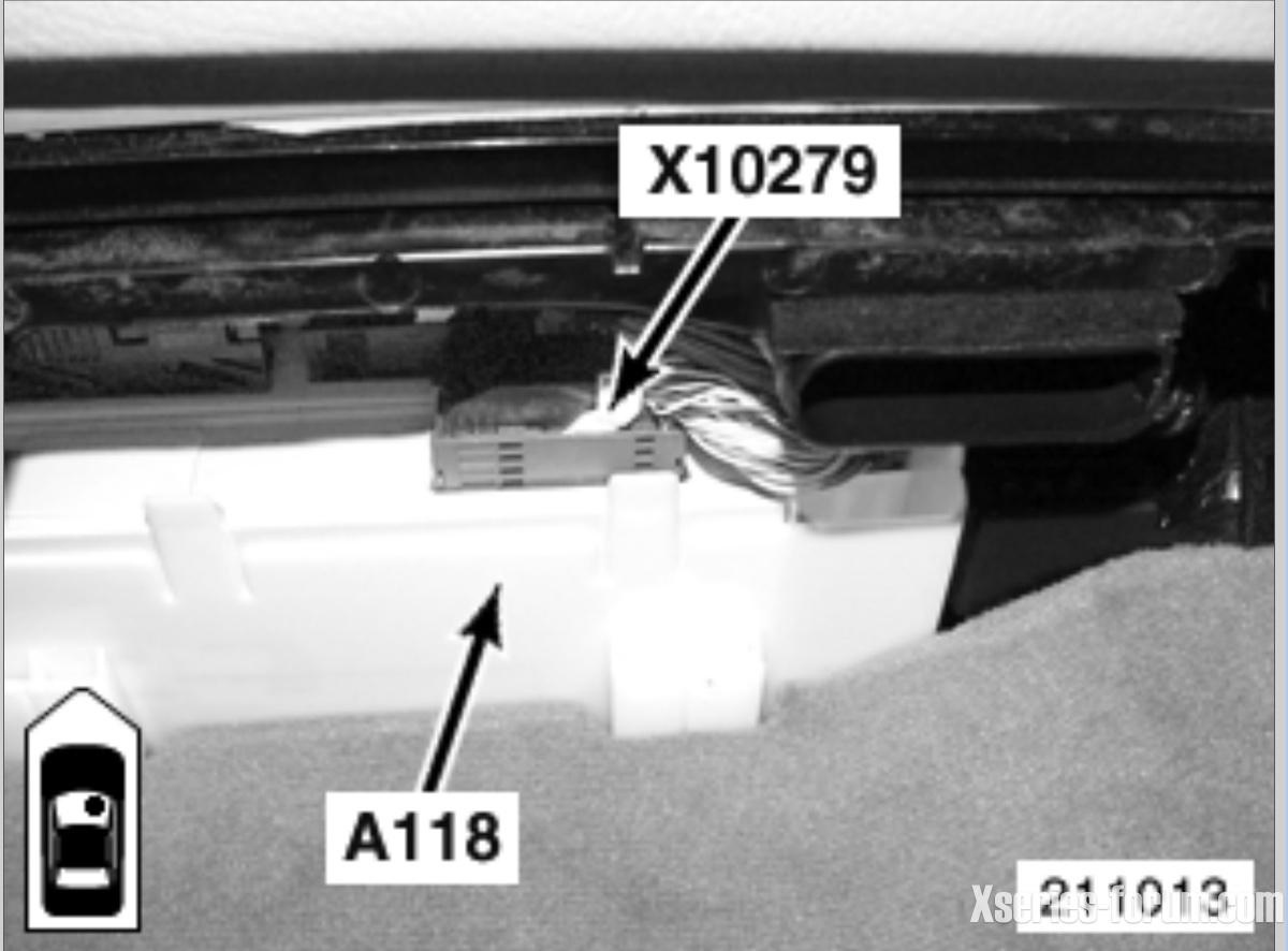

Found this: (E53, 3.0D single axle self levelling susp).
The control module A118, is behind the glovebox, passenger side…the connector (X10279) is a 54-pin. The wiring colours are as below. I think WS is white (it’s German) and SW is Black

My old E53 V8 had what I always believed was referred to as the "german helmet" item 8, in the lower boot area. I didn't recall that the car had air suspension as i never had any issue with it in ten years of ownership. Was I lucky (though had plenty of other unrelated issues) or is my memory failing me and the car didn't have rear air suspension?
