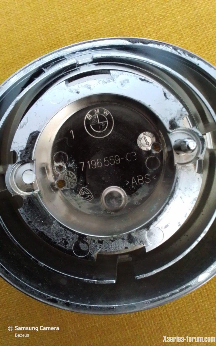

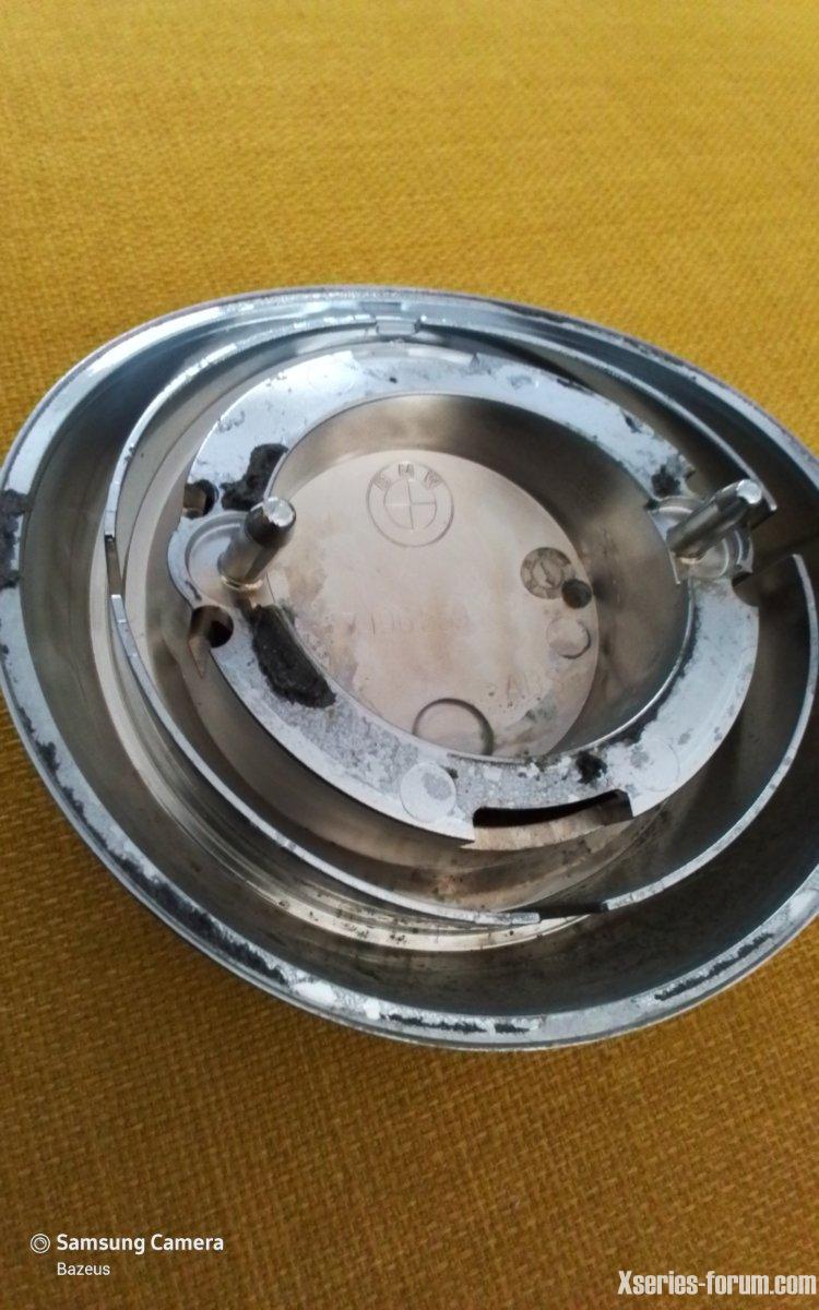

Removed this earlier today, not the most difficult task but what a faff. The badge on mine is a one piece affair, quite a complex item when you examine how its made. No grommets either, should there be? I noted the right hole is horizontaly elongated too
Short term, masking tape over the holes awaiting the replacement.

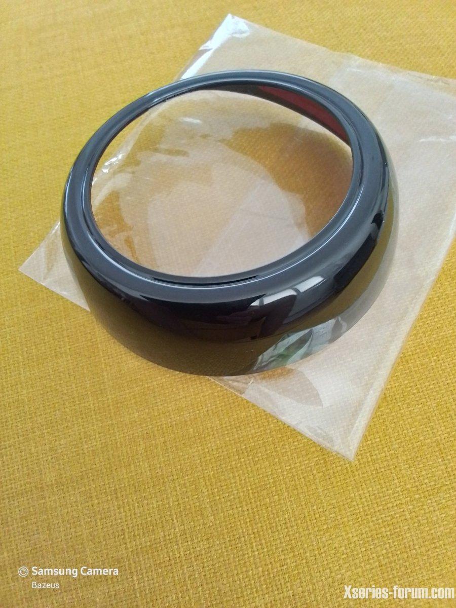

I'm pretty sure this is a one piece item. I'll snap some pics tomorrow, a replacement is ordered anyway so I'll fit it. Ironically I have a gloss black cover ring for the widget/spacer. Why the actual roundel had blistered I don't know. Its now turned into over £60 for a basic badge swap
Heat obviously helps with removal and it came off 50/50 clean, sticky foam residue is always a pita to get off. I used masking tape around the base section, heat and plastic pry tools, which have been invaluable since I bought them a while back now.

Images for reference. This is definitely a one piece item, I tried pushing on the roundel from the rear/ inside through what look like access holes and that only punctured the roundel. Maybe it starts as two pieces but they are fused together in some way?

New badge arrived via postie today, its on now and has finished the look again. I still have a gloss black covering ring but do I fit it to cover a brand new badge?
I noted the new BMW badge has a drain hole area at the bottom. No nylon locator grommets either. Two locating pins on the moulding and it seems the self adhesive tape is no longer enough for a water exclusion fit ?
