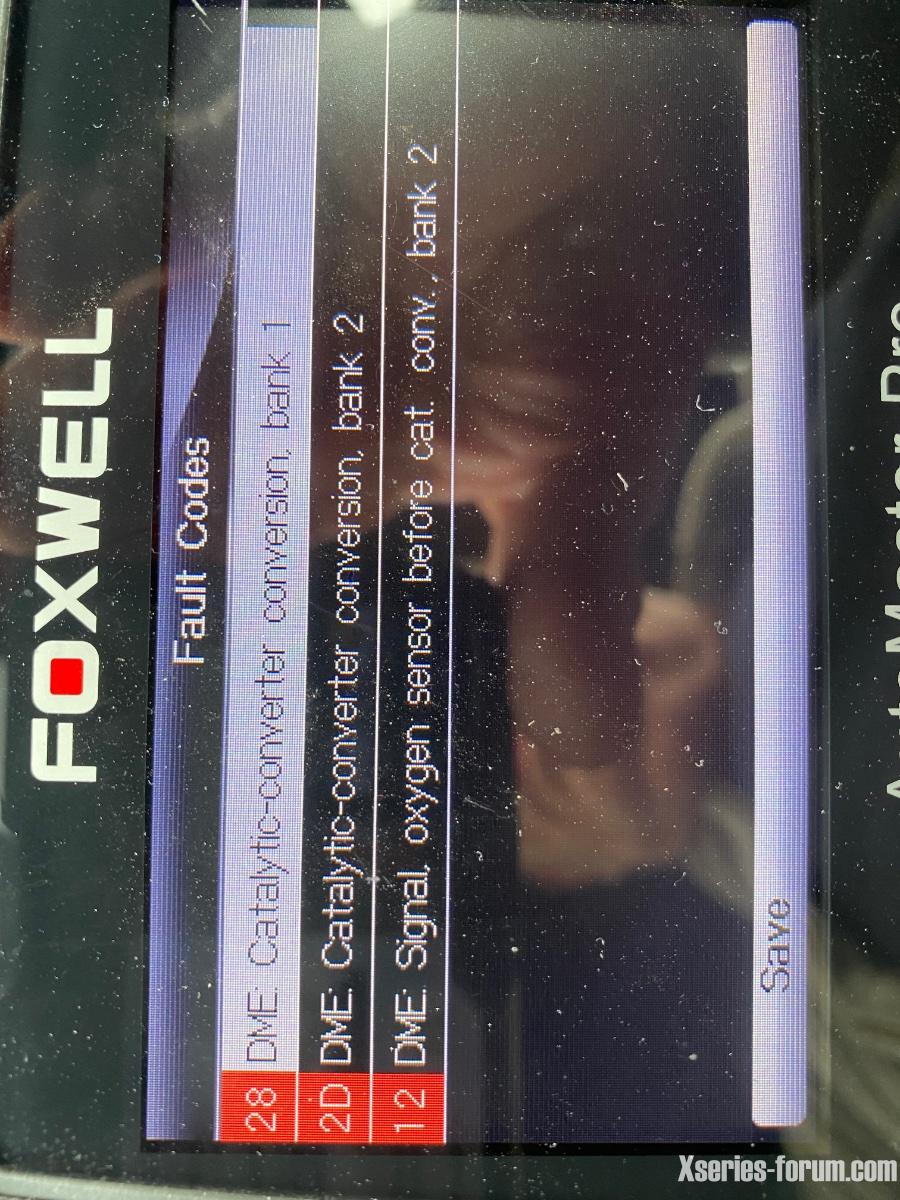

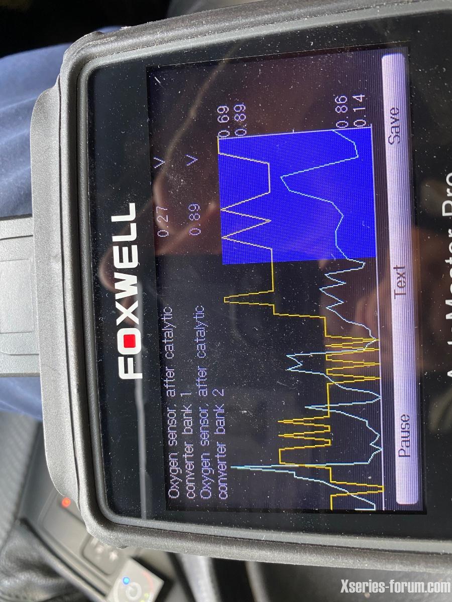

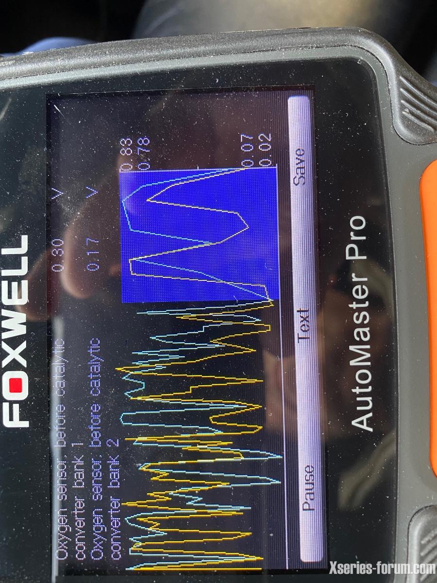

Post by henrym3 » Tue Sep 27, 2022 6:27 pm
First pic is using petrol and second is on LPG
Fault codes difficult to find answers
28 fuel trim adaption low/high OR Lambda sensor
2D can’t find anything
12 can’t find anything
So if fuel trim then it could be an air leak. Need smoke test.
Problem is by the time you get lambda readings the idle is not bad.
I’m leaning toward air leak or MAF
Opinions appreciated

Just had a quick look at https://bmwfault.codes/ but it doesn't give any more information than your Foxwell other than two codes to link back to the O2 sensors
I think an air leak is the possible cause a perished hose somewhere The MAF is testable so that should be easier to rule out
