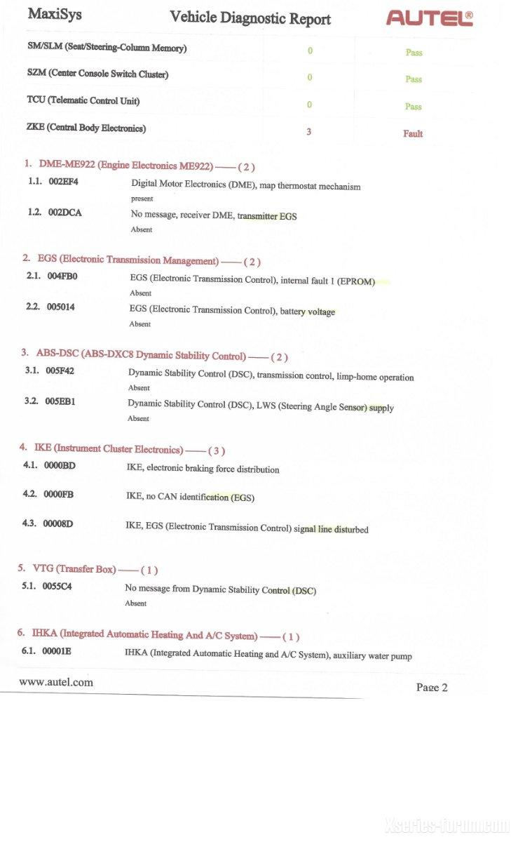

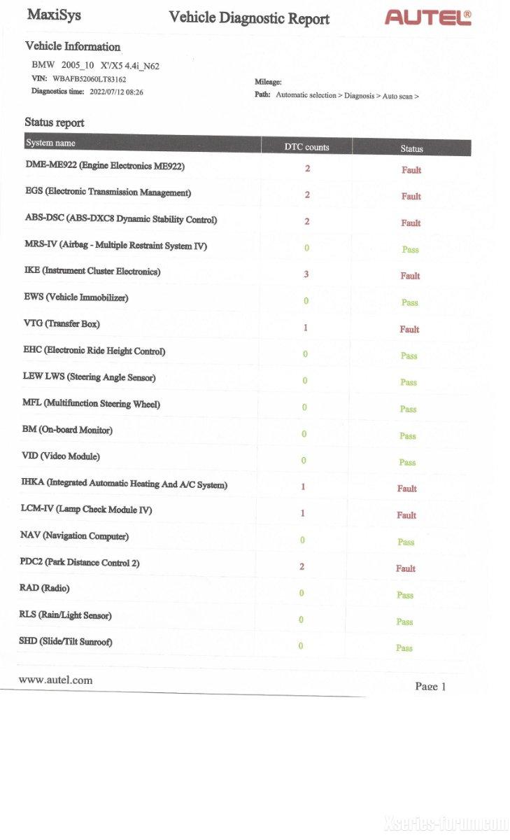

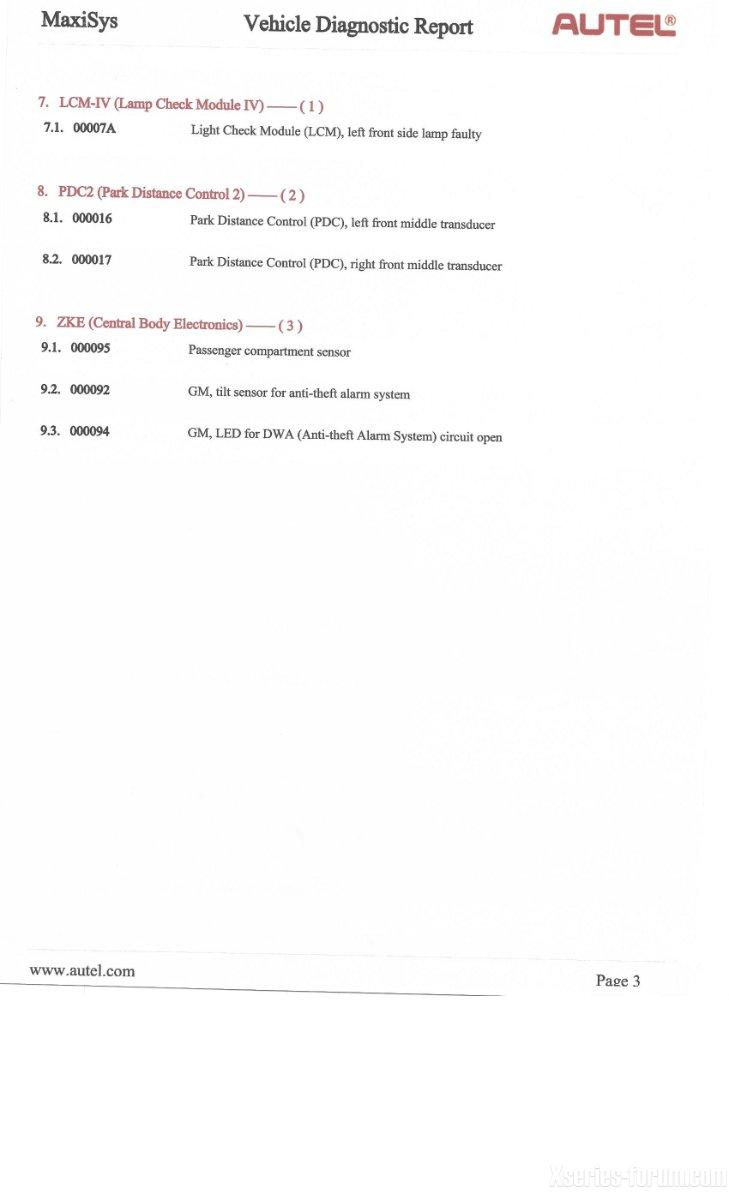

Thanks for the feedback.
I have attached the full report. Does this have the detail and accuracy needed?
These are also the dashboard lights that show when going into safe mode.
Next steps?
Next steps?

I think the ‘absent’ errors are those stored in memory from previous. If the error code log is cleared and they return then those one are ‘present’ and still triggering.
DME looks like one of the thermostats is stuck - probably open. Common fault so the engine runs cooler. That wouldn’t cause a gear problem though.
I get the Aux pump error on mine, always have and it just means the Aux Heating isn’t working…..it isn’t fitted in my case.
It could be an oil pressure issue within the box itself once it warms up. Hard to say but things to look at would be the box itself (clutch or brake packs), torque converter, transfer box.
If it’s had a transmission oil change, what state (colour/smell) was it in? Dark, burnt smelling oil means trouble within the box itself. The Mechatronics unit is just the brain controlling the hydraulics.
