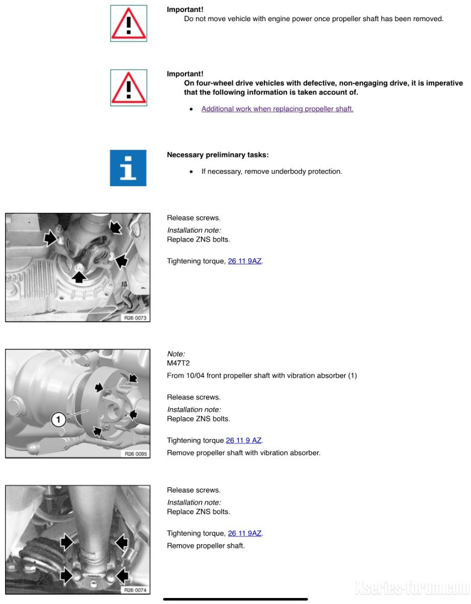

I can’t promise images for everything but this may help:
You MUST replace all the ZNS bolts (from BMW) and ask your local BMW dealer to confirm torque setting and angle. They are tightened to a torque and then a specific angle. Only designed to be used once!. There are several torque settings in the source I have and it’s not clear what the right one is. Once everything is fitted then transfer box (assuming it is also OK which sounds doubtful) will need resetting electronically (it’s what is referred to as the ‘additional work’ on the image above. It’s normally done with BMW software, but there are other tools that can help. Again your mate might have what’s needed.
