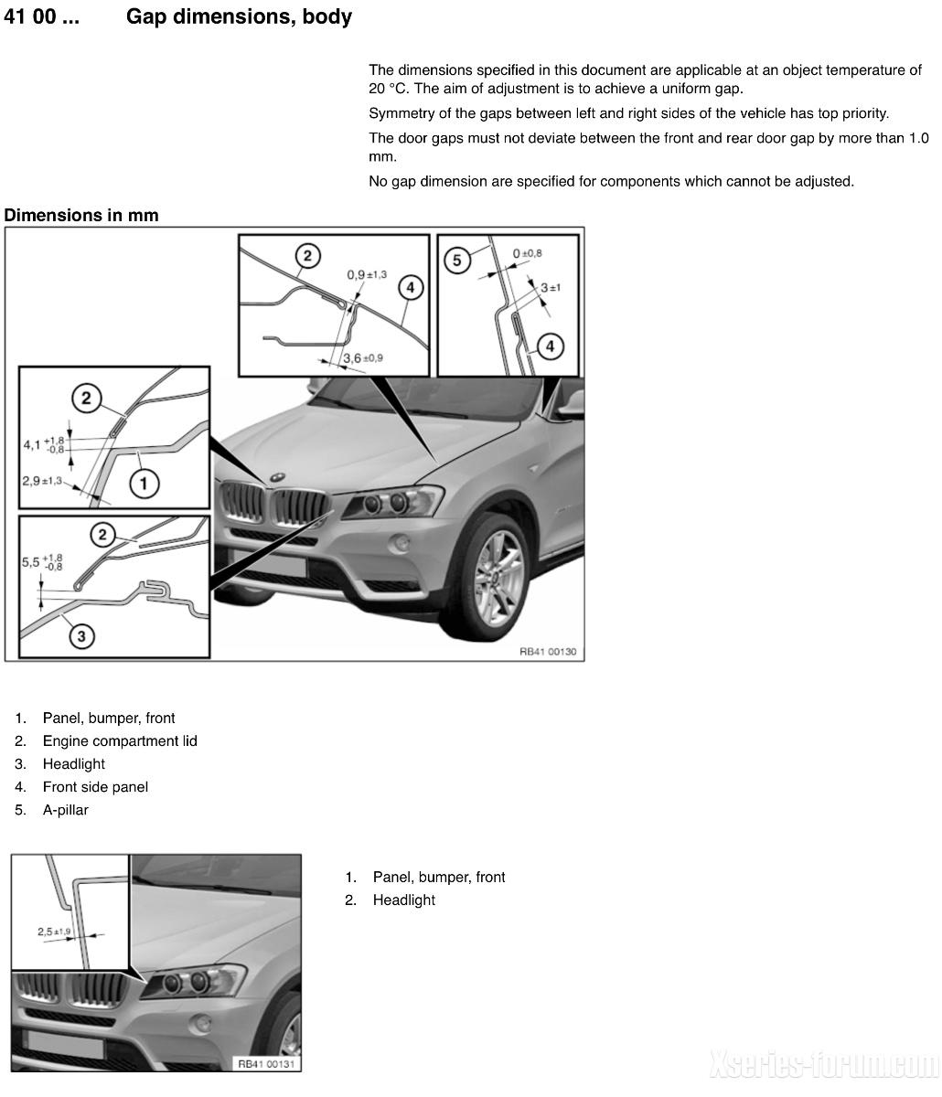

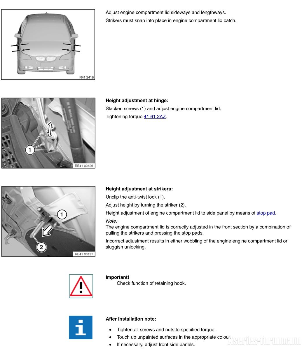

Is there any adjustment possible on the bonnet catches on the F25? To my eye, our bonnet sits fractionally too high (above the grill) and could do with closing just a little bit tighter. Just wondering if there is a way to do that?
Posts: 19292
Bonnet adjustment?
Post by X5Sport » Fri Jul 08, 2022 8:52 pm
This…dimensions first, then how to adjust.
