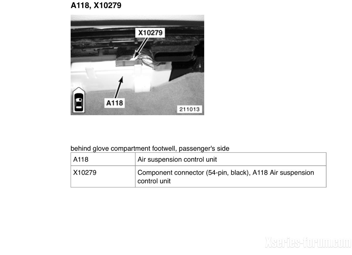

I am wondering where the control modile lives...
Anybody know ?

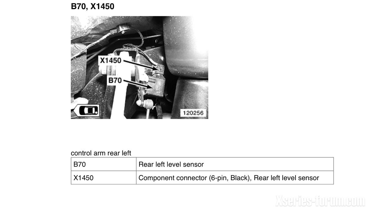

Posts: 19297
Saggy Rear Air Suspension D-Sport
Post by X5Sport » Sat Jul 09, 2022 11:04 am
Should be here:
Is the level sensor OK on that side?
X5-D-Sport
Posts: 1371
Joined: Sun May 25, 2014 11:13 pm
Post by X5-D-Sport » Sat Jul 09, 2022 12:19 pm
Many thanks chap.
I have a spare sensor for that corner, So will swap that out tomorrow too.
