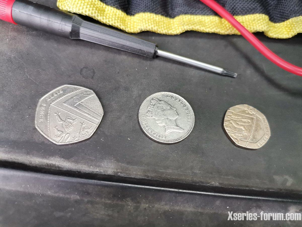

Only good news on this update, I removed the CCC module using YouTube videos for reference and sure enough the unit rattled like a piggy bank. I managed to find a video showing a guy stripping the CCC unit to replace a faulty DVD so I used this information to strip it and remove the loose change.
I found the 20amp fuse on the back of the CCC unit blown, so when I rebuilt the unit back up and replaced the fuse I put it back in the dash to test and it all works...
Very relieved and happy to get away with a couple of hours of my time and a 50p fuse to fix. But hats off to Andy Navman 07905245385 for his time in the first place, without his knowledge and information I think I'd of sent it off for a costly and in this case needles repair.
Thanks everyone for there replies to my issue, maybe this will help another parent!

So I consider this to be a really good result, maybe I should use the coins recovered to purchase a lottery ticket?
