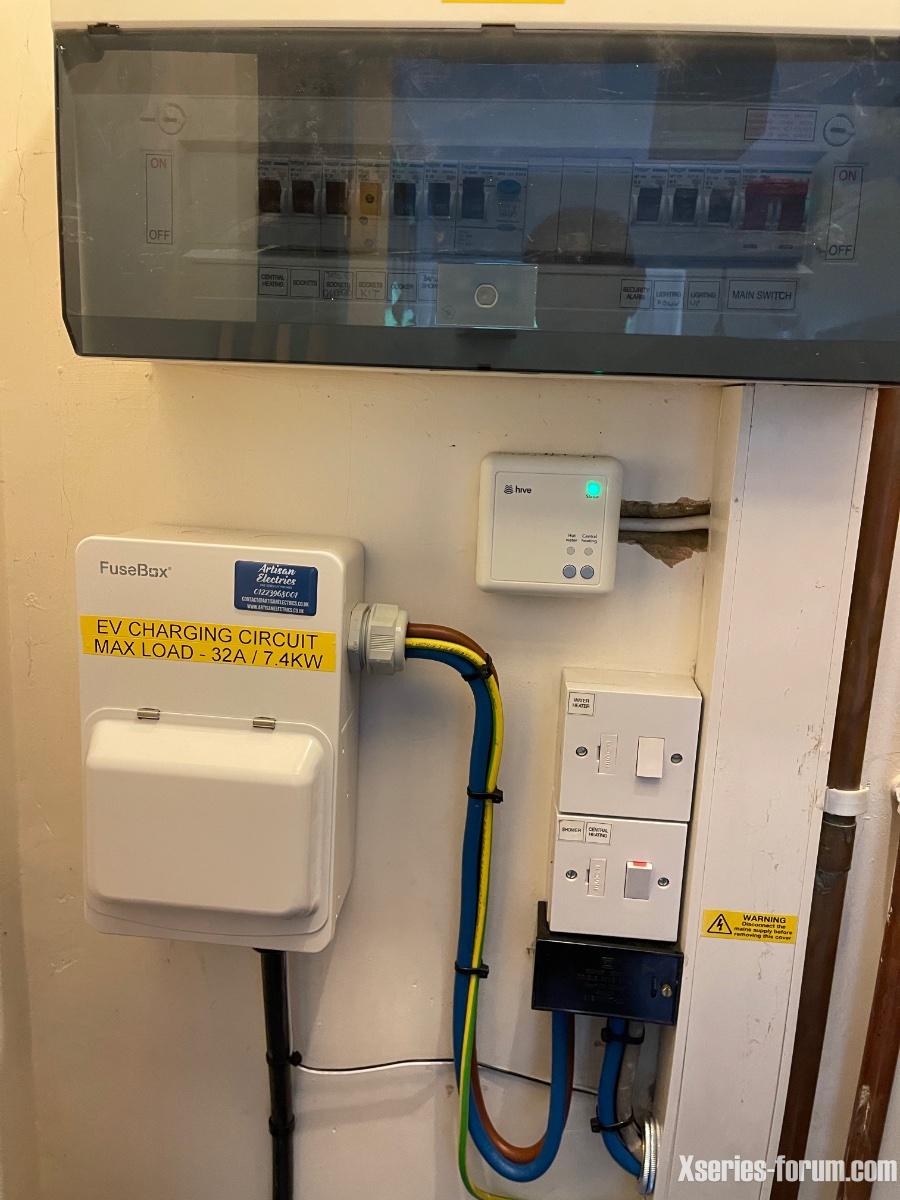

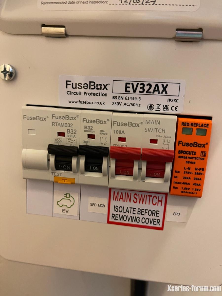

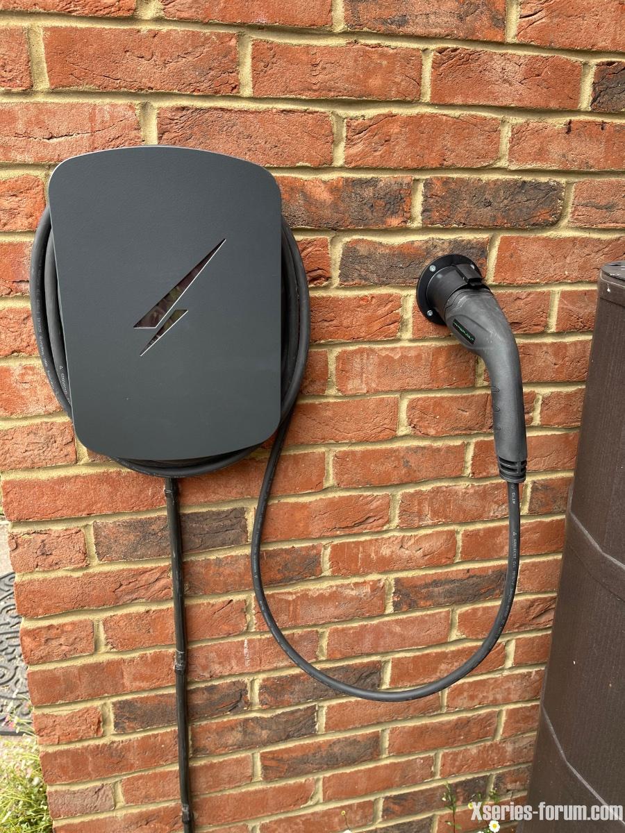

Here we are. 6 hours of work by one sparky and the domestic electrical side is all done.
Hypervolt Home 2.0 7kW ‘smart’ charge point with 10 metre cable (£800). British made of course.
The internal install has a second consumer unit with (now required) anti-surge protection, MCB to allow that to the replaced (say following a nearby lightning strike or dodgy mains), 32A circuit breaker (must be Type A to protect against a DC leak) and 100A MCB master switch to isolate the charge point system entirely. New tails run from the company 100A feeder, split to both boards so the house and car side are completely separated.
The thin black/white pair runs to a current transformer/active load monitoring (CT/ALMS) system designed to monitor full system load and reduce the charge rate to the car if the house needs a lot.
Feed cable is SWA Armoured 3-core 6mm with an included 4-twisted pair, Cat 5 Ethernet core to allow smart monitoring.
