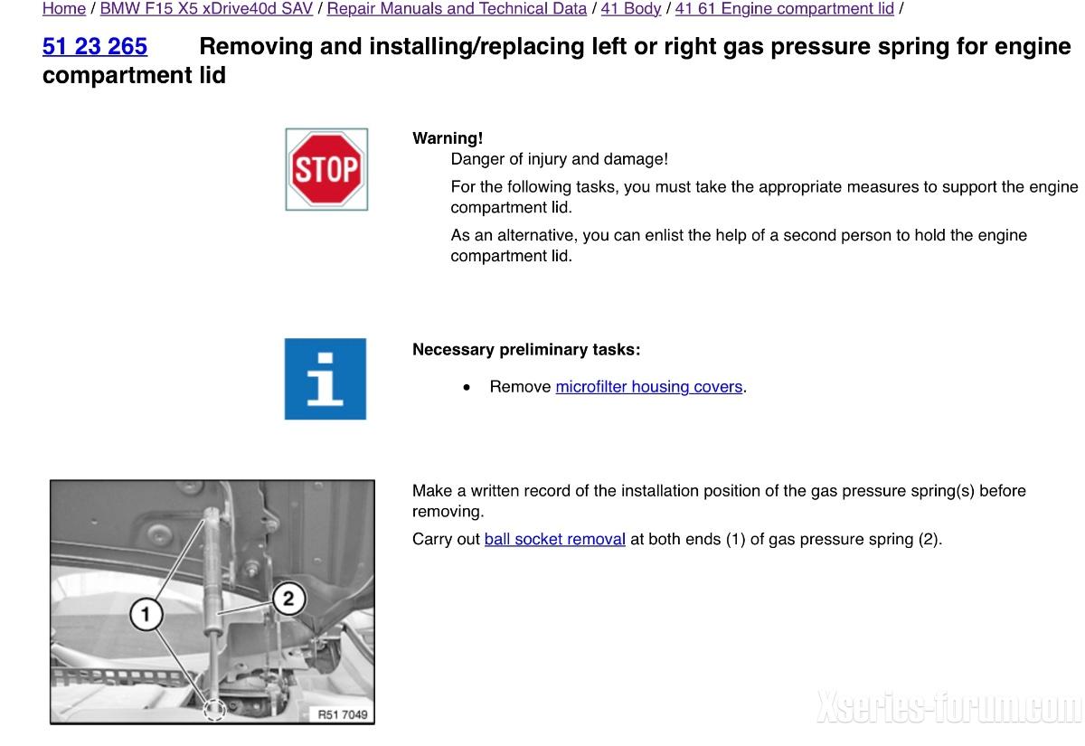

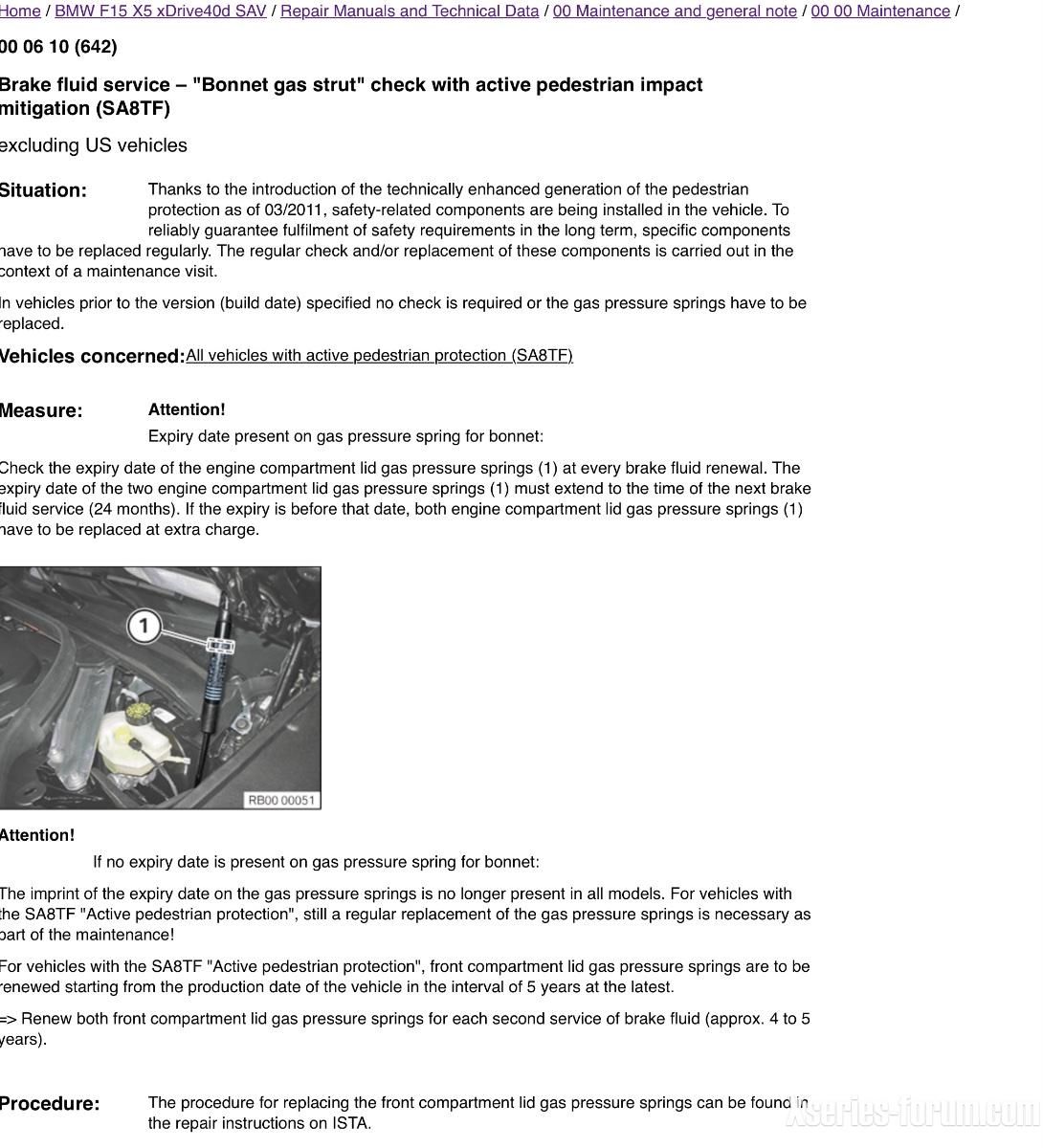

The ‘pedestrian guard’ system comprises a pyrotechnic gas generator on each bonnet hinge mount, and gas struts.
Part number: 51237308065. Febi versions are £71.00 each. These are specific for vehicles fitted with SA8TF
There is a specific service line item against the F15 & F16 to replace the gas struts before the expiry date.
=> F15/16 New testing point:
On vehicles with active pedestrian impact mitigation (SA8TF) check expiry date of gas struts. Expiry must not be before next brake fluid service. If necessary replace at extra charge. Change interval 5 years from date of manufacture.
<<< Change procedure (the only one listed) It does say to get the pressure off first as the spring is under pre-load!
It doesn’t mention the pyros. Those are about £180 each.

"Excluding us vehicles" though I wonder why ? Seems money for old rope same as when airbags had an expiry date

I was told the same when it went in for a brake fluid service, the service manager said,
‘we have to tell you but they don’t need changing’ for the first time (5 years old) I took the car to an Indipendant mot station and surprise surprise no mention.
The only thing I can conclude is that different dealerships have different views
