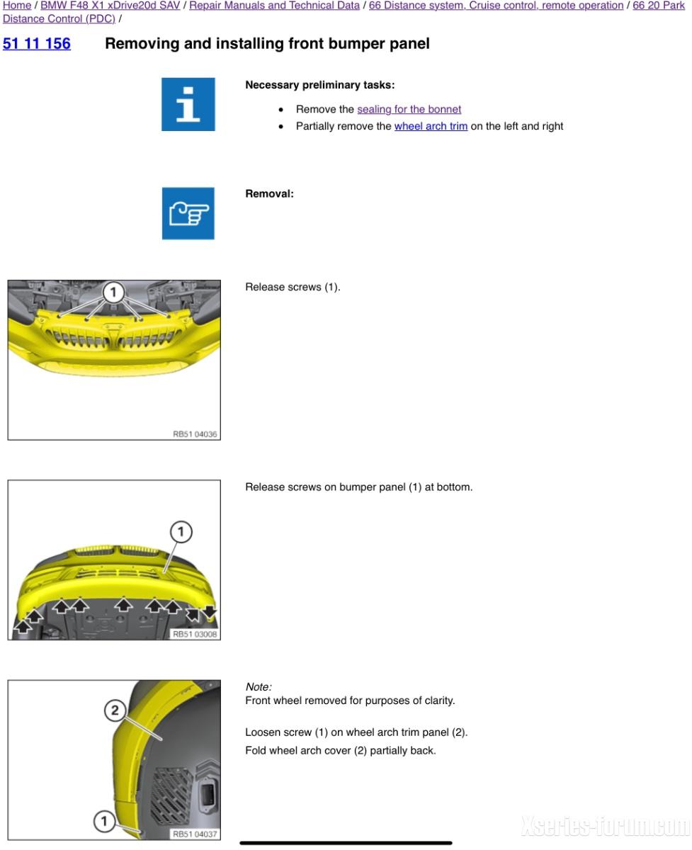

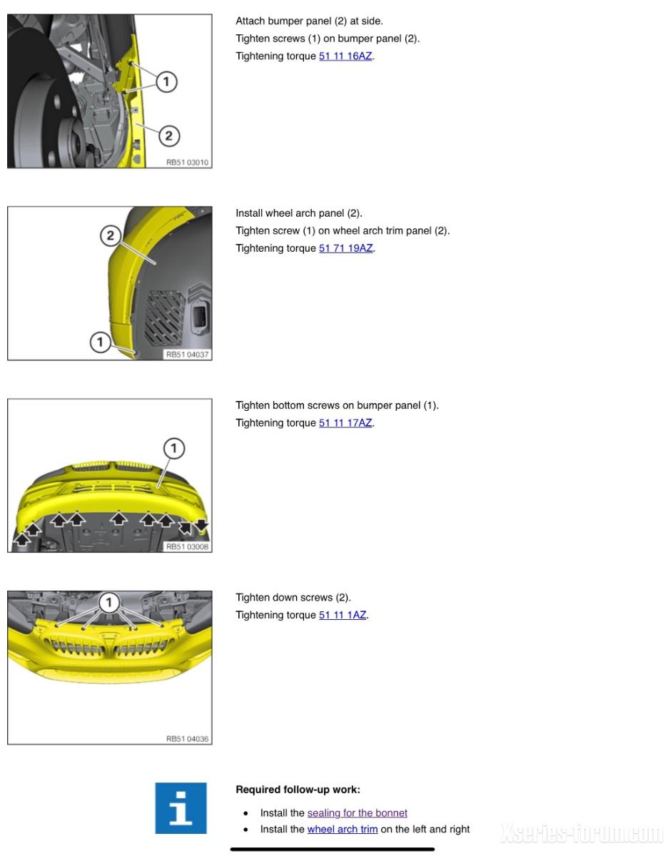

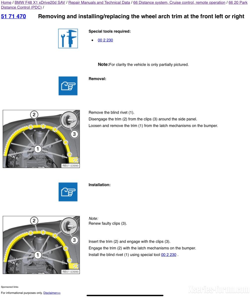

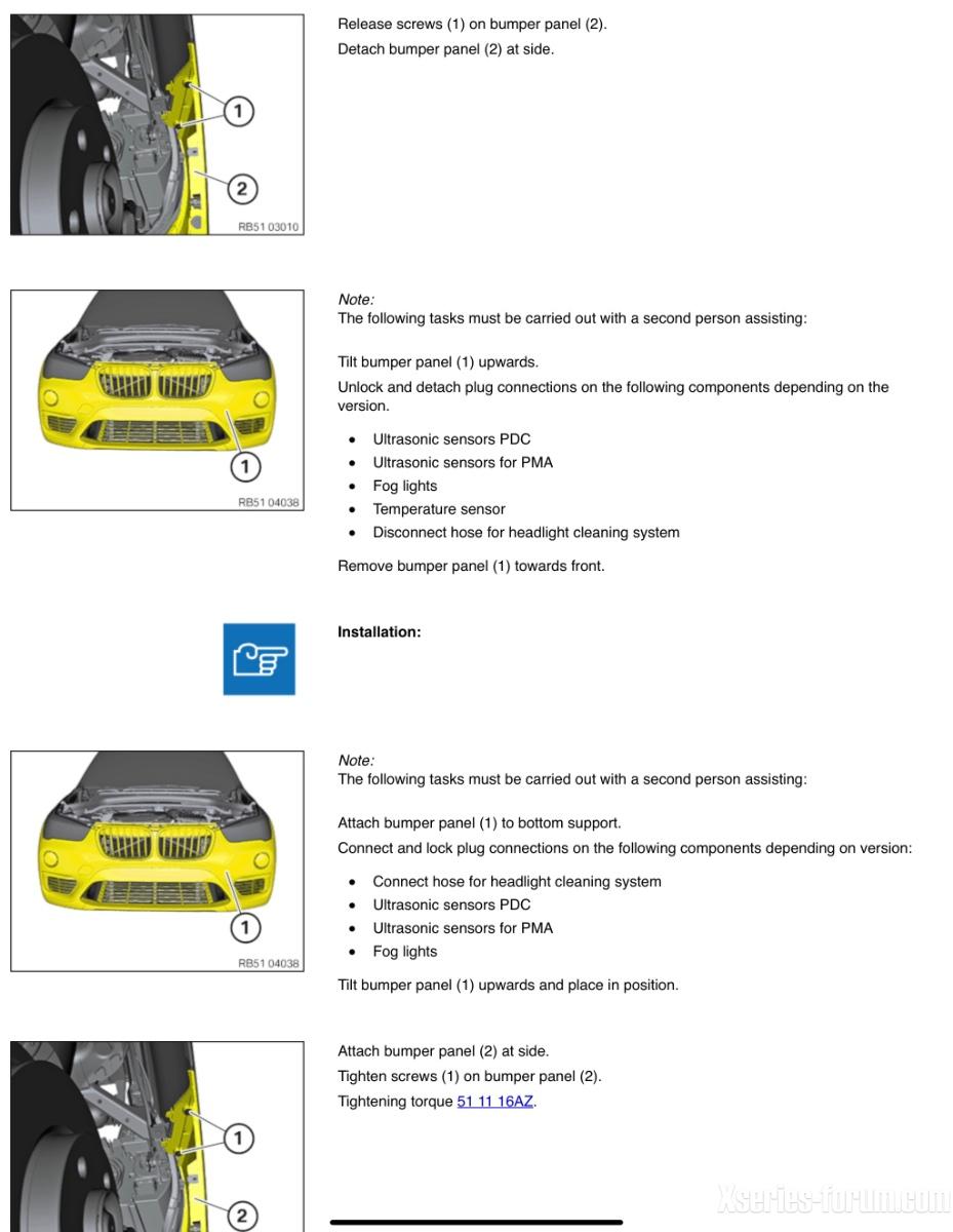

The front sensors don’t need the bumper off apart from left centre. Screws at top (4) and bottom (9) all need to come off Sides are got to via the wheel arches and front right via the trim panels below the fog lights.
Wheel arch trim removal.

Hey pal, thanks for taking the time and showing this. IN regards to removal of the bumpers , take it can be done with with wheels on, but is it ones of those jobs its much easier to take the extra 15 mins to support the vehicle on axle stands and removal wheels?

It probably can as long as your tools can get to everything whilst the wheels are on - I’m thinking wheel arch splash guards. There’s often not a huge amount of gap between wheel and wing. If you have ‘dumpy’ tools then it should be fine. One of those ‘it depends’ jobs I guess. :)
