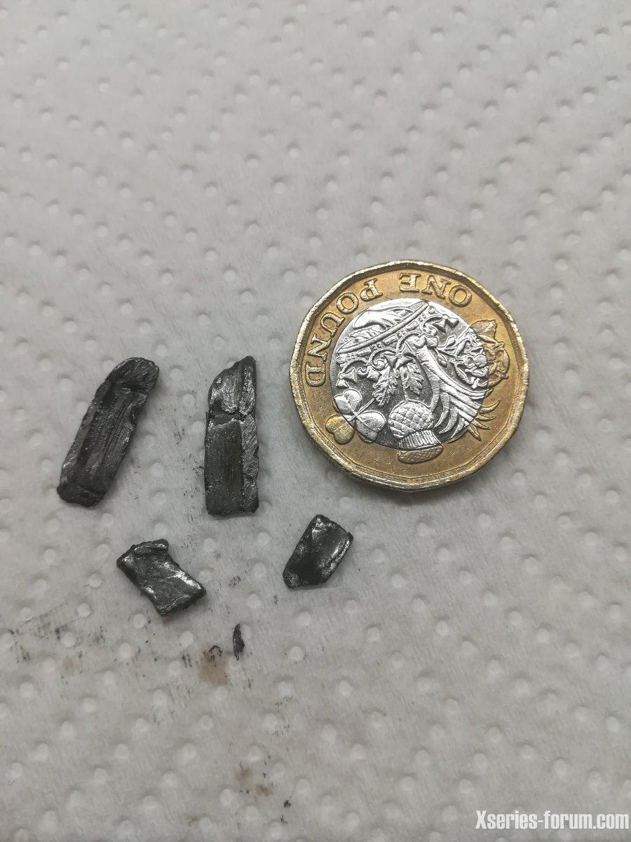

Ok here we go..
Ive done a full trans service today - fluid and filter. Did the test drive and the thud from 3 to 4 is gone as far as I could tell on that short trip.
The gear changes are all smooth as now but...
When i took the sump off I found some chunks of metal stuck to the magnets.. Not a good sign. See photo.
The magnets had a bit of fur on them but nothing major. Fluid was dark red and didn't smell too bad.
When i refilled it and ran thru the gears in manual it would not stay in 4th.
1,2 3 and 5 all ok.
Anyway, its all back together but I may be living on borrowed time although it's driving ok.
We will see.
1,2 3 and 5 all ok.
We will see.

That’s not good! At least they’re caught by the chip collector magnet and aren’t on the loose in the mechanisms now, but….. 4th gear uses the A & B clutch packs only so these could be from the drums around those clutches rather than the clutch material as the size and shape looks like part of a drum. Sadly I think you’re right, chunks of metal are not a good sign. Some images of parts here….I did look to see what might be a close match to the source of the bits.
https://www.automaticchoice.com/en-gb/b ... -catalogue
The only way to find out is surgery
- Posts: 1712
Ooo transmission..
Trouble ahead by the looks of it

I've sent an email to Stevensons engineering near Ware to see what a rebuild will cost but in the meantime there is nothing I can do but use it.
Who knows - there may be chunks of metal in lots of gearboxes on cars that the owners know nothing about..
Like I said, 4 th gear was not selectable as I was cycling through the gears after putting fresh fluid in but when I drove it all gears were usable.
What about the transfer case chain apparent slack? Thoughts anyone.

The scary thing about that is you’re probably right. It’s why aircraft have warning circuits on their chip detectors…..OK the consequences tend to be a smidgin more serious when their gearboxes go……but it’s only a sensor that brings a warning light on and the magnets are already there anyway.Themoog2 wrote: Sat Sep 25, 2021 11:18 pm Who knows - there may be chunks of metal in lots of gearboxes on cars that the owners know nothing about..
