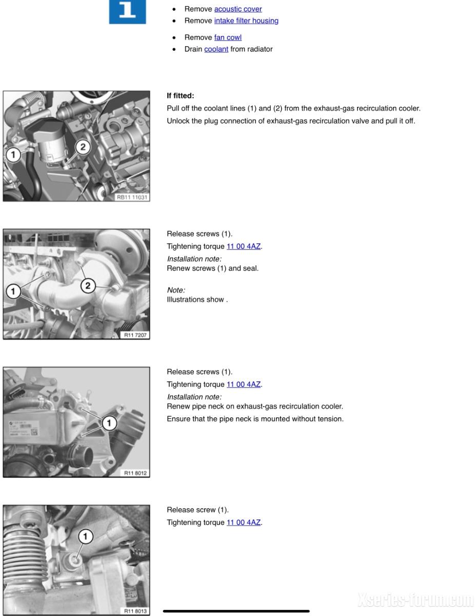

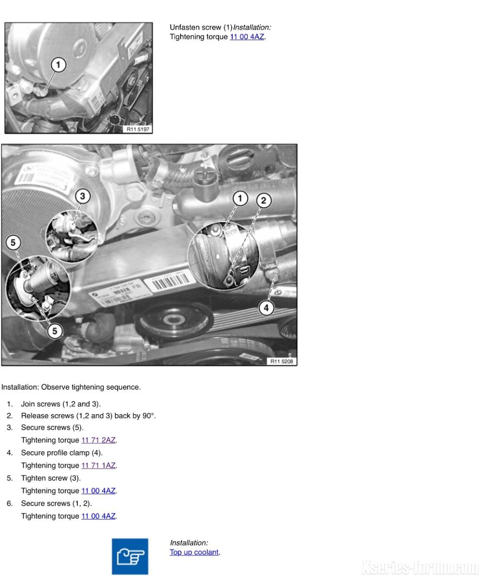

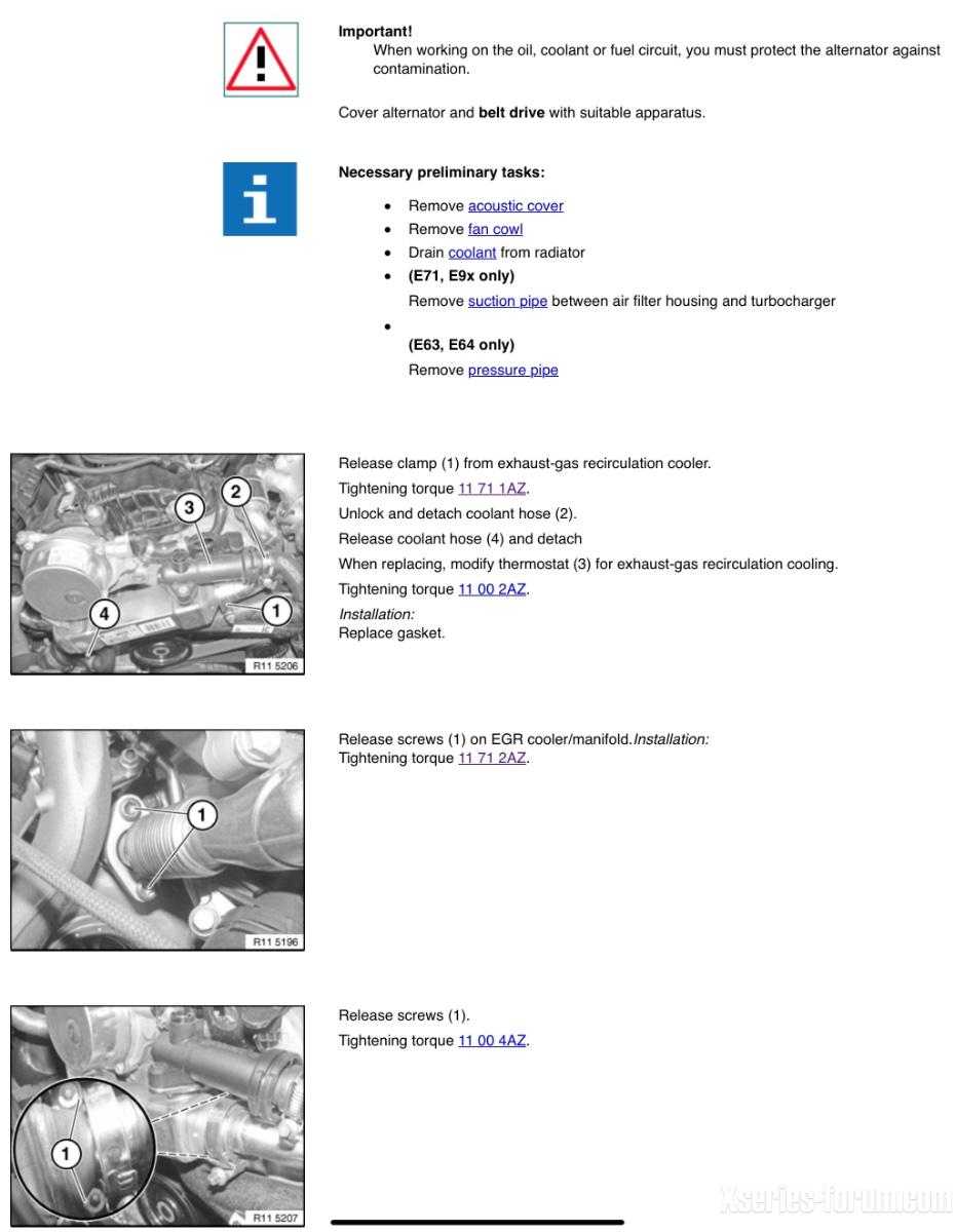

The EGR has a water based cooler radiator. If that’s cracked it could be that is dumping coolant water into the inlet side? With the EGR having been changed it might be a pointer? If it was refitted with any tension on the coolant pipes that could cause an issue too.

thanks for that, I'll have a look on Real OEM. I recall my 3 series had an EGR thermostat (the short black plastic one), but not it's own rad. Do you know where it is?
- Posts: 19293
Possible head gasket failure
They don’t all have one. Hard to tell from the images I found, I think it’s top front of the engine for the 30d (almost the same as the E46) and right side on the 40d about halfway back.

Cheers bud, its an M57, I recognise the EGR thermostat from my 330d (had one blow, and another new one weep with a crimped 0-ring).
He needs to inspect the front end, didn't realised the EGR had a radiator, or how it's water would enter the inlet, but it does seem odd it's been blowing white smoke since they worked on it and the oil neither oil or water are contaminated. Will explore further and report back

Have just been looking at Real OEM and am now wondering if it's the EGR cooler or thermostat. Is there a way if this is faulty or not assembled right water can be either pulled into the inlet manifold or it can become pressurised and water pushed into the exhaust? Been a while since i took an EGR thermostat apart (and the car's 300 miles from me) but i recall they're fairly simple inside.
