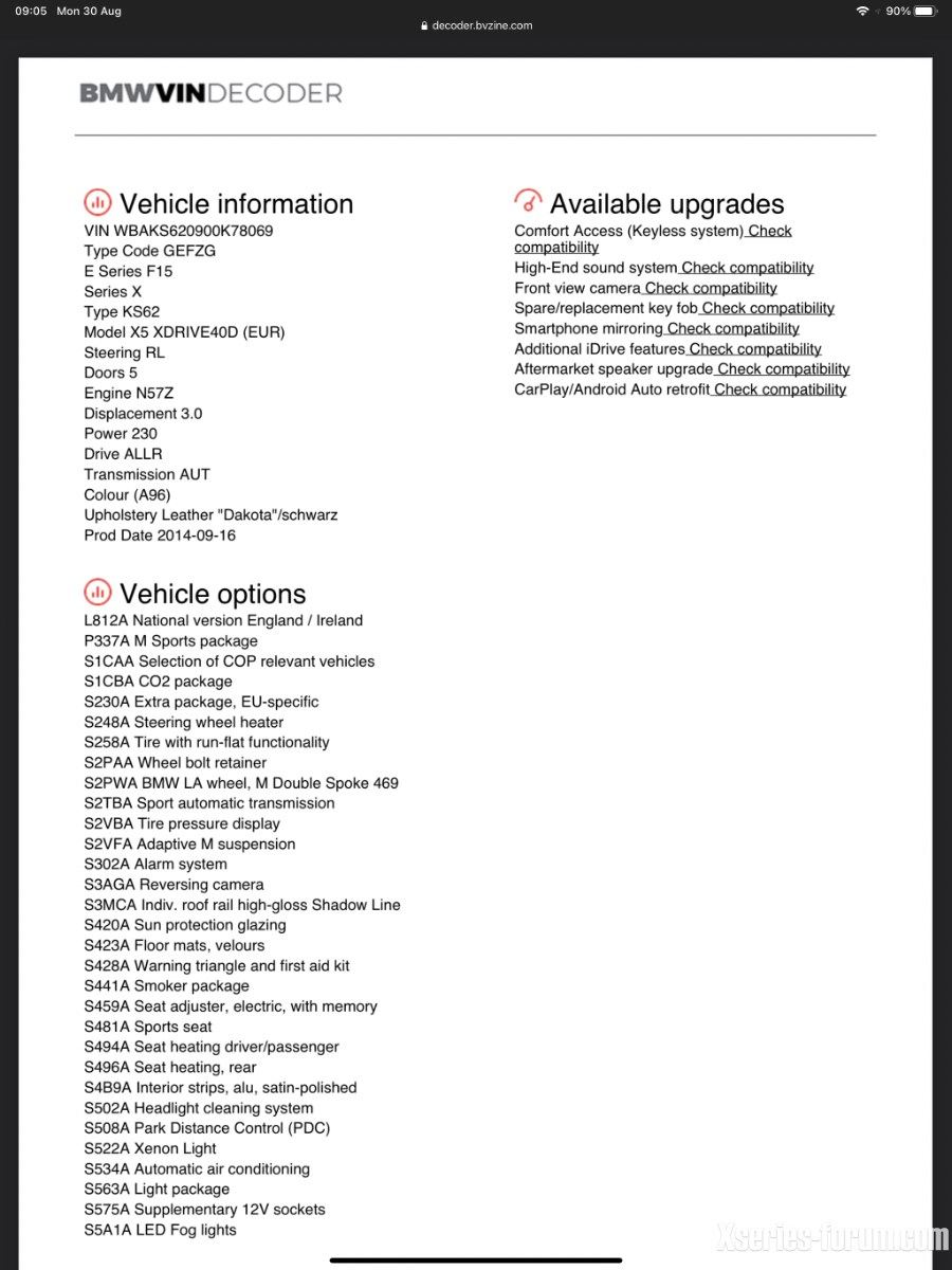

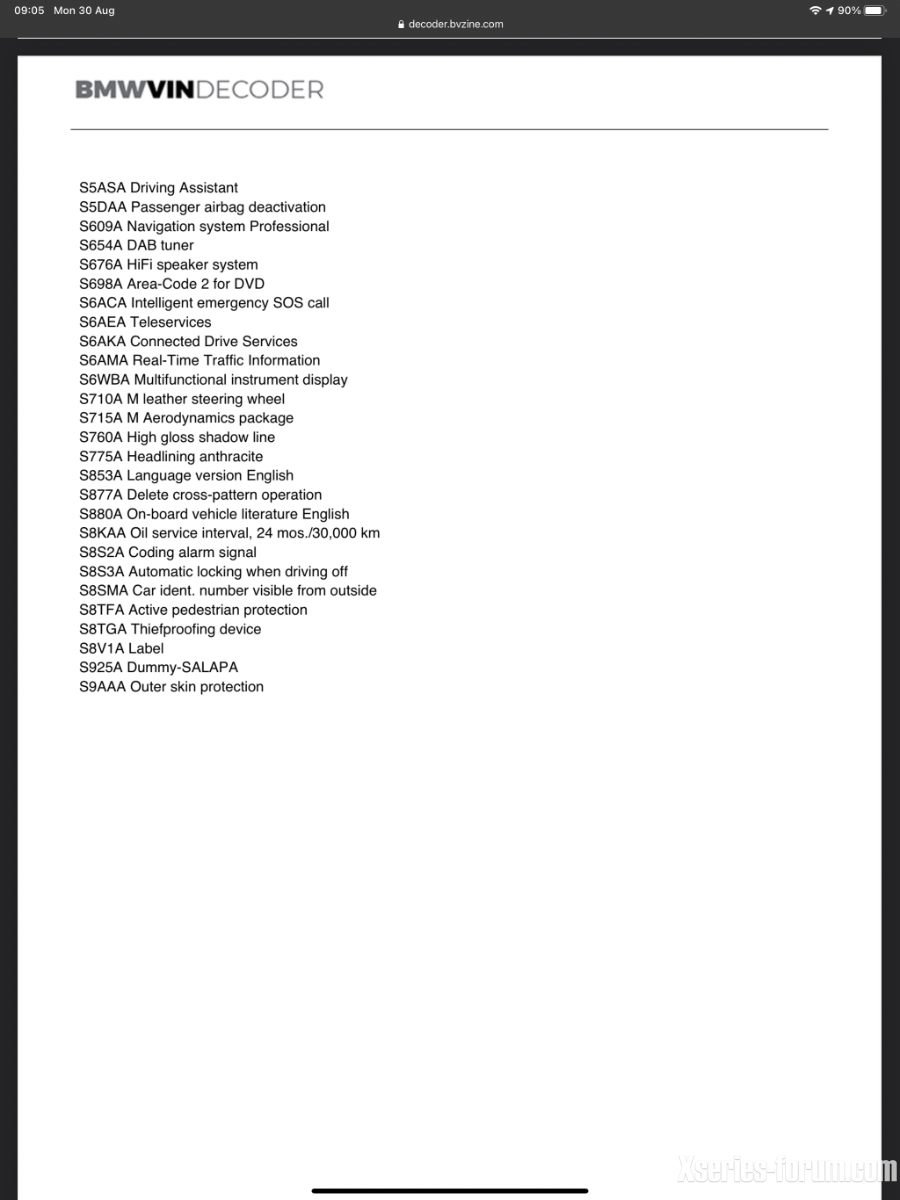

I managed to get the vin decoded but didn't see the HUD so won't know until Wed.

From that list if the car had HUD it would show it. The "CHECK HISTORY " i would heed too, perhaps the car hasnt been dealer serviced?
LHD too, where in the world are you located?

No the cars definitely Right hand drive and been serviced loads by main dealer .. haven't actually seen it until Wed but I am in England! I got screen print of the date/mileage of the history and the dealer name so I'm going to call them up tomorrow

Odd that the decoder says LHD? Checked the VIN number?

No not really as I only have the reg number and I got it by some website so maybe wrong but the rest of the details add up correct reg date etc... Have to wait I guess! .. strange

The HUD if fitted would be option S610A (I have had it in 3 BMWs and it’s always been that code). Assuming that you have the right details then it isn’t included. It would be worth asking the Seller for the full 17 character VIN to be certain.
Something you really also need to find out is what tyres are fitted. BMW xDrive cars are very sensitive to tyres (bad design IMHO) and need to be shod with the right rubber and have even tread depth all round. The F15 is less problematic but it still needs checking. It should have either ‘*’ or ‘MOE’ marked tyres with no more than 1.5mm difference between any one tyre and the others, or between axles. ‘*’ are BMW Homologated, ‘MOE’ are Mercedes Original Extended - which BMW now also use. Mixing brands, or going ‘cheap’ is not recommended.
Some decoders get the LHD/RHD wrong, but this one looks better as it says RL for steering. It’s also got the power (in kW not bhp)
