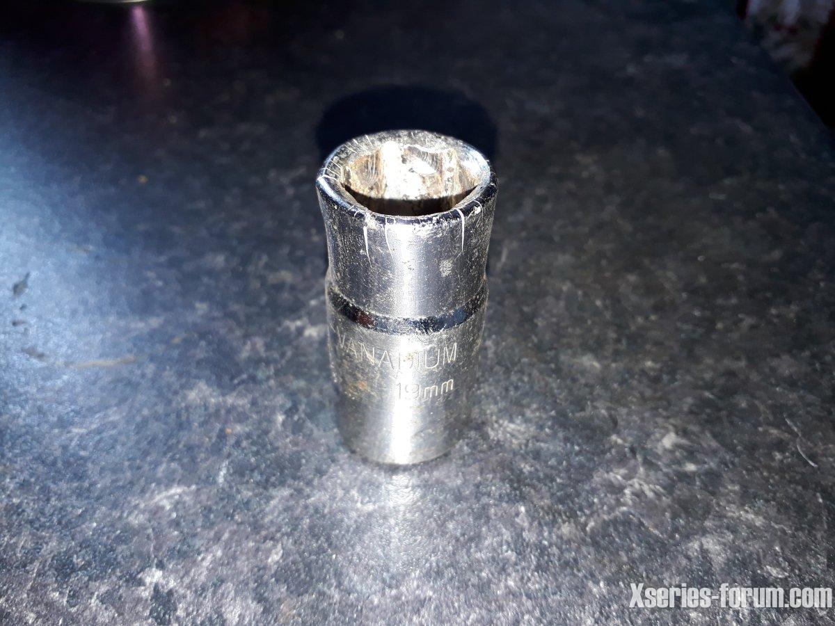

Swapping over to my 21" summer wheels and was in the tyre fiiters getting 2 new rear winters on the rims and watched them uggga dugga the wheel bolts with an air gun and then use a torque wrench to check the tightness :rofl: Not surprisingly them all clicked straight away , the front were fitted a few months ago and its about the only time I let then tighten the bolts due to covid distance rules, I usually do them myself with a wheelbrace and torque wrench in there . I did remove the locking ones myself as the airgun will knacker them and leave you stuck unable to remove them yesterday .
I tried to undo the fronts today and there was not shifting them with an extended wheelbrace so I pushed harder and the socket split :headbang: most have been about 250-300nm :cry: It took a 600mm long breaker bar and an thick wall air impact socket to get them undone and a huge effort at that thought I was going to need a piece of pipe on them .
Lesson learned will not let it happen again , below the now binned socket :rofl:

One that the socket slipped on is rounded a bit , I might do away with the locking wheel bolts as they are a pain and if it failed in one of the deep reach alloys you would never get it off again. The bolts are very tough Id be more worried it could split the alloy taper but I may need to buy a few spare bolts soon anyway.
Unfortunately I've been at another tyre place not that long ago and it seem the norm to ugga dugga then use torque wrench after , its what they have been shown I guess so a training issue, place I usually go to were fine with me doing up my own even if they thought it a tad strange :rofl:
I guess it's more work for them and all they are worried about is being sued if one comes off so too tight ain't an issue.
At the side of the road I had zero chance of undoing those wheels. :driving: I thing a long breaker bar and a 17mm IMPACT socket, not an ordinary one as it will fail ! should be in everybody's toolkit and the preset 140nm bmw torque wrench someone said about on here is excellent to tighten them up again. :thumbsup:
