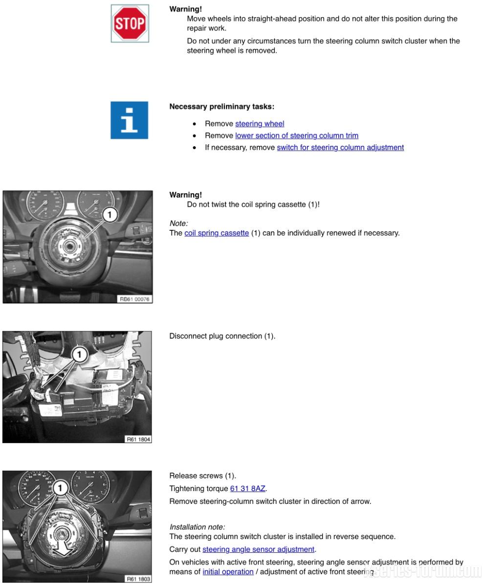

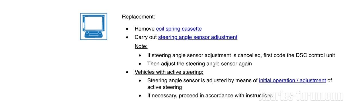

Post by Sm[]key » Sun Jul 18, 2021 10:30 pm
Has anyone changed this themselves? Can't find a guide to do it? :D

Post by Leslie » Mon Jul 19, 2021 11:50 am
Not done but think it needs calibrated after.

Post by henrym3 » Mon Jul 19, 2021 3:08 pm
Put in BMW X5 e70 steering angle sensor replacement in google. Loads of vids.

Post by Sm[]key » Mon Jul 19, 2021 5:49 pm
I did, non for e70.
Posts: 19262
2010 E70 X5 3.0d - Fault Code DSC 5EC0 - Steering Angle Sensor
Post by X5Sport » Mon Jul 19, 2021 8:48 pm

Post by Sm[]key » Sun Jul 25, 2021 12:03 pm
https://www.ebay.co.uk/itm/324723634506 ... Sw2Zxg-Wui
Thinking of getting a 2nd hand one off eBay, as the 4x4 light coming on all the time in now and is annoying me!
Any pointers to stop this going horribly wrong? :driving:

Post by sapphireblack » Mon Jul 26, 2021 5:26 am
It looks pretty straightforward to replace, but if not confident maybe buy the used* part and seek professional help with a BMW indy or other trusted workshop,
* what mileage was on the donor car? You dont want another failure a short time down the line.

My e53 experience warns me that this could be the ABS module. It never seems to give fault codes but blames everything else. ie wheel sensors, sas g/b etc. Unfortunately one has to follow the fault code but don’t be surprised if the fault returns after sas repair. Hope the sas fixes it.

Post by Sm[]key » Sun Aug 01, 2021 9:09 am
Ok thanks all, I've received the second hand cluster unit will install later in the week.
Does anyone know if these need to be coded to the ECU?
Posts: 1525
Post by Alan Gunn » Mon Aug 02, 2021 6:32 am
Yes i would think so if changing the cluster.
Tamper dot on mileage plus the miles.
