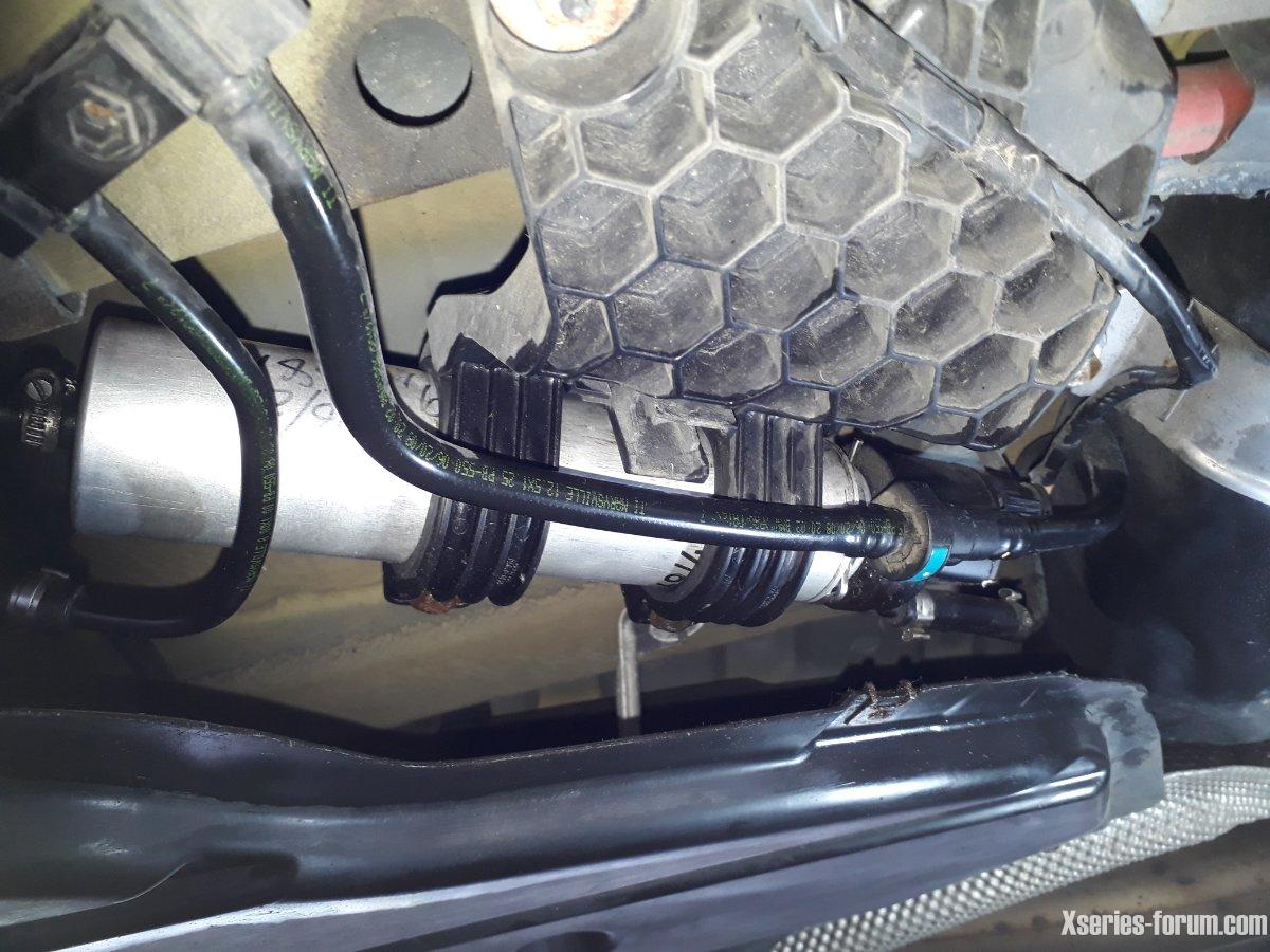

Well that was no fun lol I can confirm it is on the left side and you do need to remove the front panel to get the middle panel off and really the rear is a bit in the way but I left it in place and worked around it but it makes accessing the 2 filter bolts a bit more tricky. There are many 8 and 10mm screws and plastic 10 mm nuts and push in plugs in the sill cover , the plastic nuts are perfect but the screws and what they screw in is rusting away as they go into the foil heat shield and some are missing already as there is nothing left to screw them into.
I thought I had all the diesel drained but I must have knocked the front connection and a load poured out onto the drive as I had moved the container out the way
Despite priming for 30 secs 3 times by pushing the start button without touching the brake pedal to start it still took a good 5 + seconds of cranking which seems like a long time when you are waiting for it to fire
With limited room ( I had the rear wheel up on a 4 inch block and the scissor jack lifting the front a little for clearance it's not a job id want to do again in a hurry, there still is too little room
