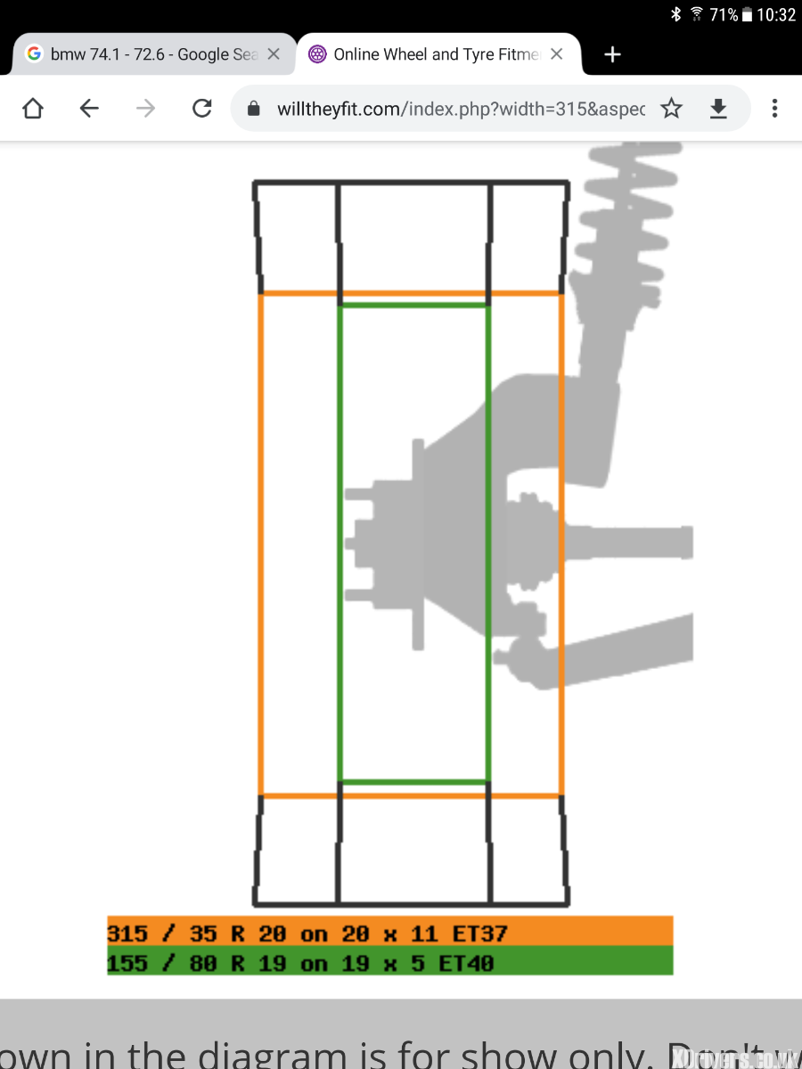

2: Have the alloy space saver CB enlarged but knowing the offset, 40 vs 14 is still rather shallow, the rear is depicted here
