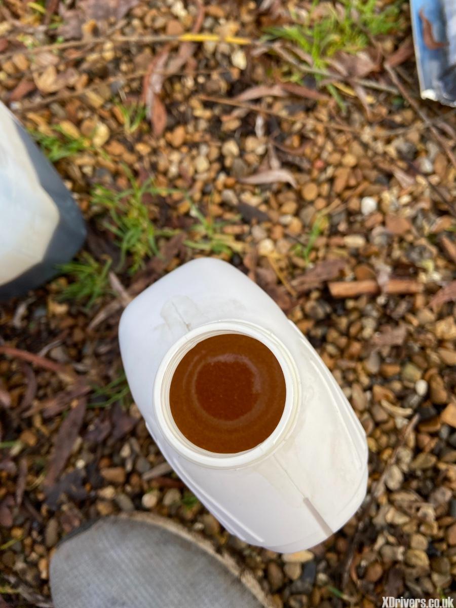

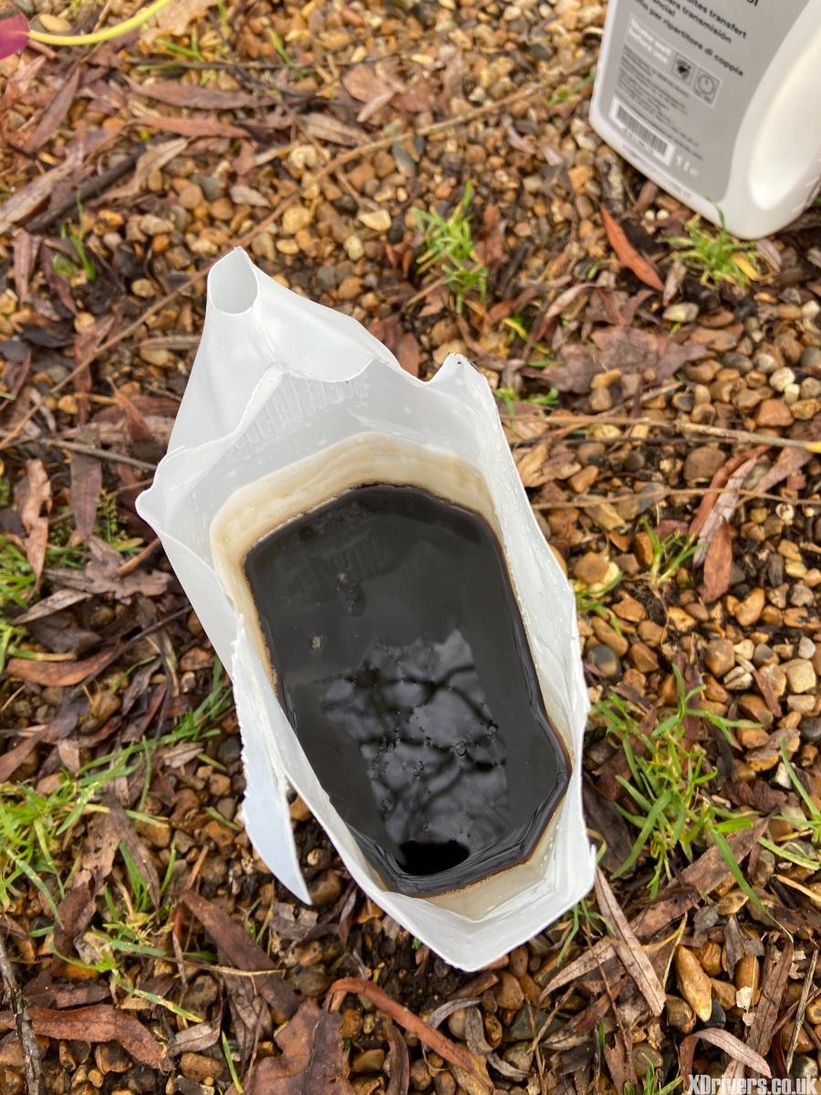

Finally got this done today! Well it’s one of those jobs I wish I had never started! What an absolute PITA job, language was fruitful! Fill plug is completely blocked by crossmember, had to make my own tool, and then filling back up was a nightmare, need a really small tube, but it’s done! Don’t recommend it as a job to do unless you can get a ramp!
Oil before and after
Makes a difference to the drive and tyre skipping/judder has gone, not reset the adaptions yet however!
