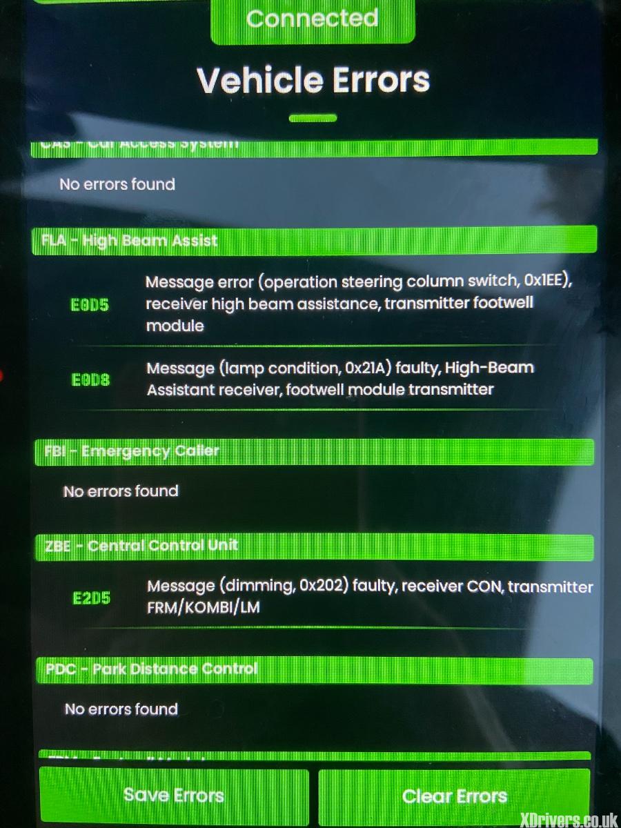

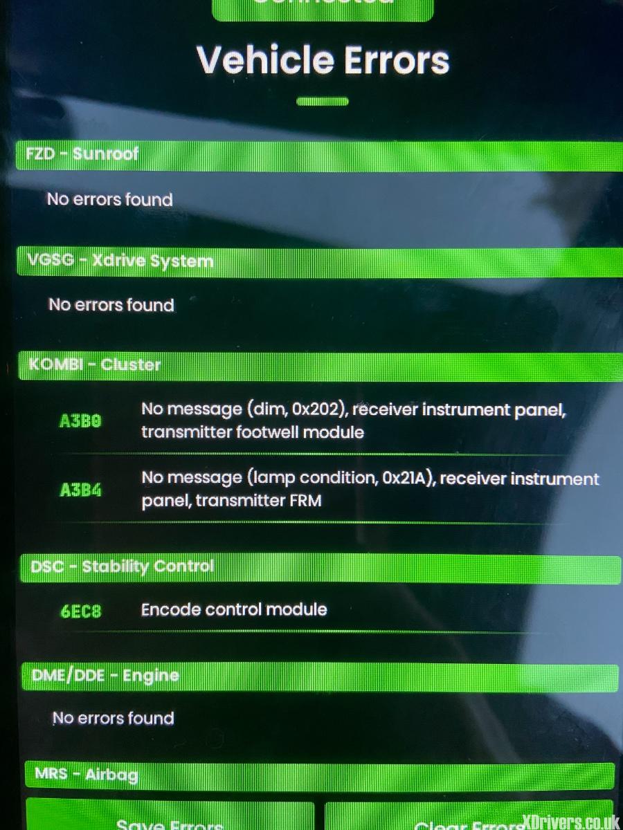

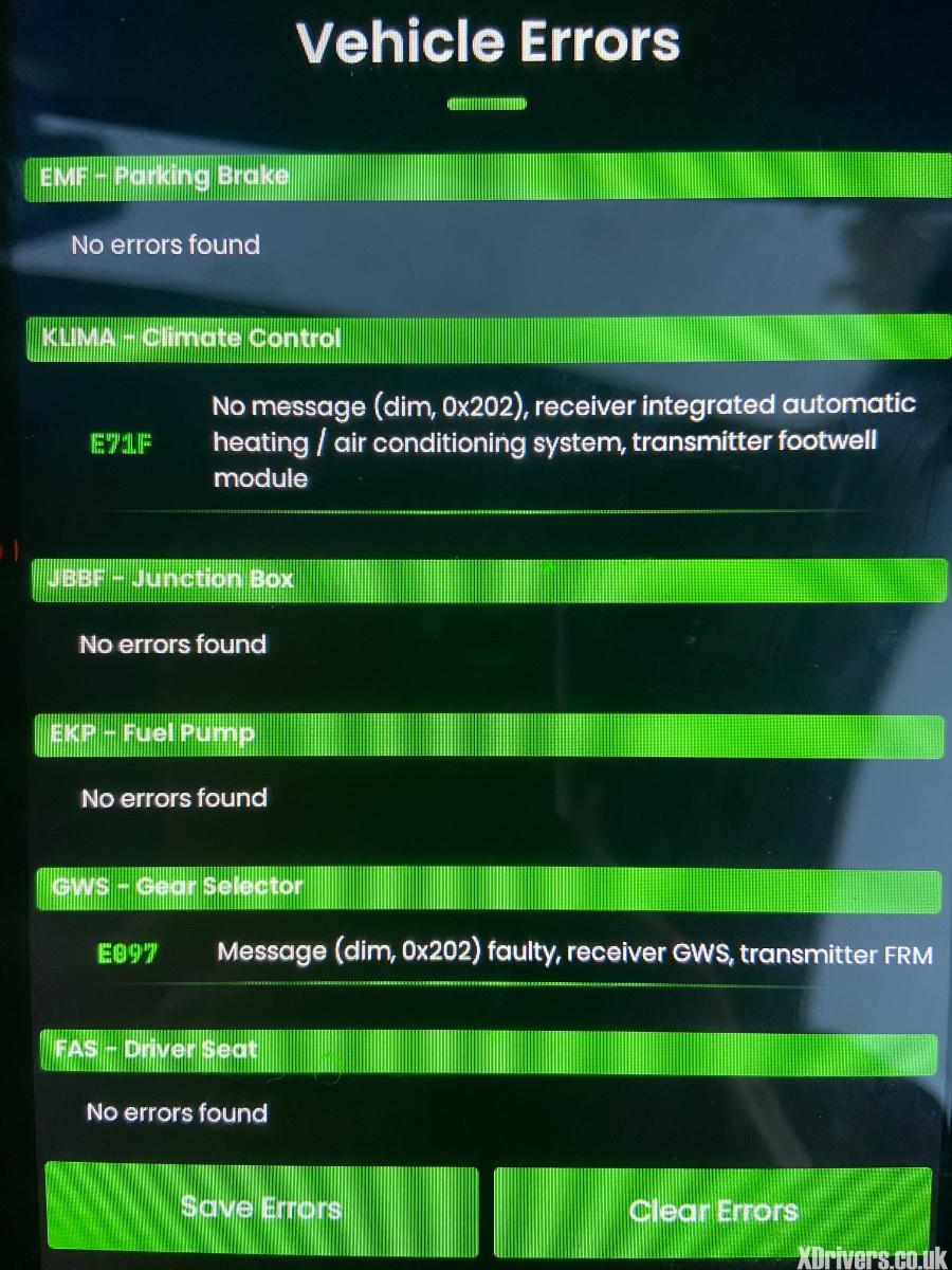

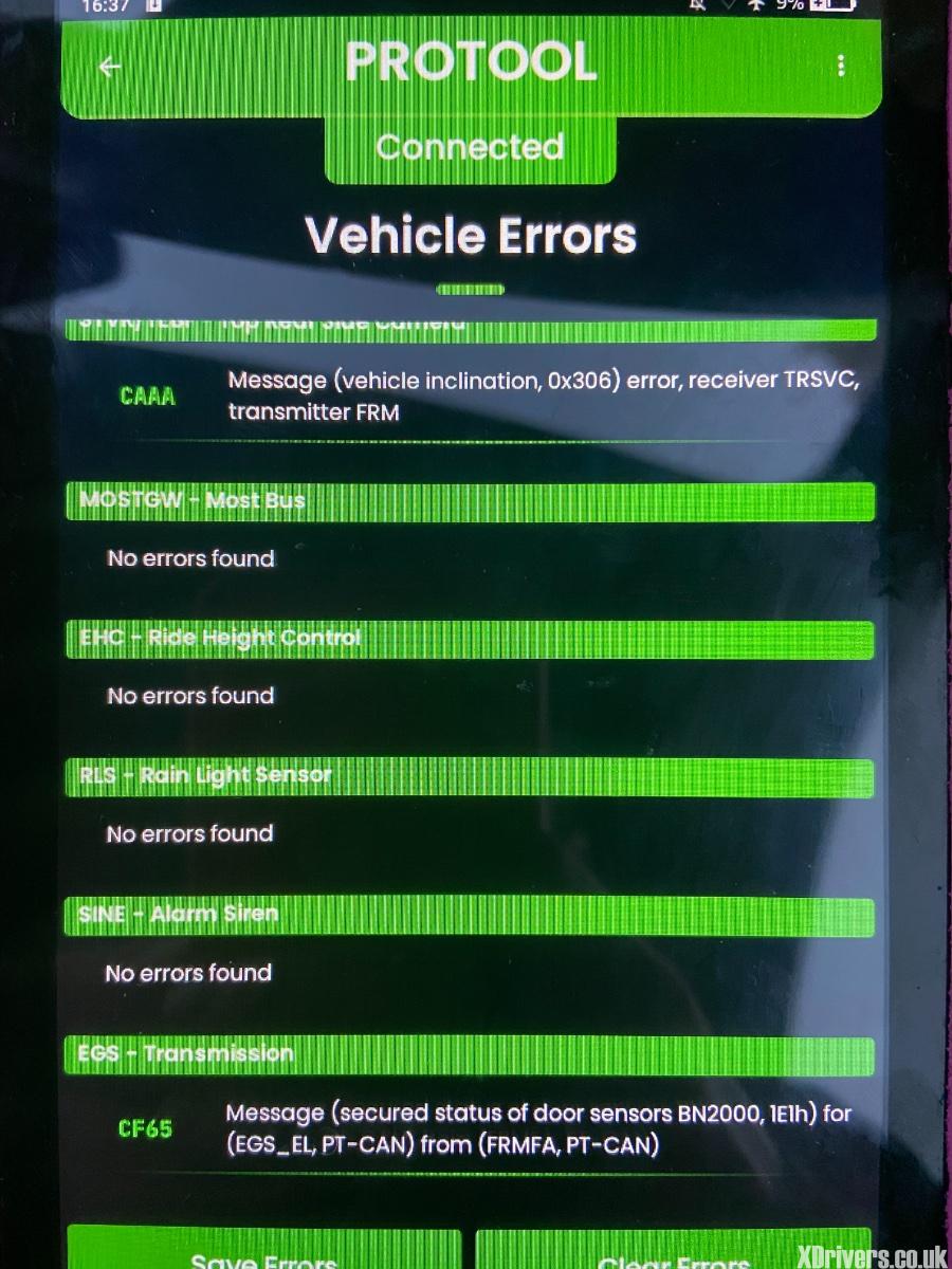

I have scanned the car, errors below using bimmergeeks ProTool.
I thought this might be the FRM, however I can communicate with the frm?
