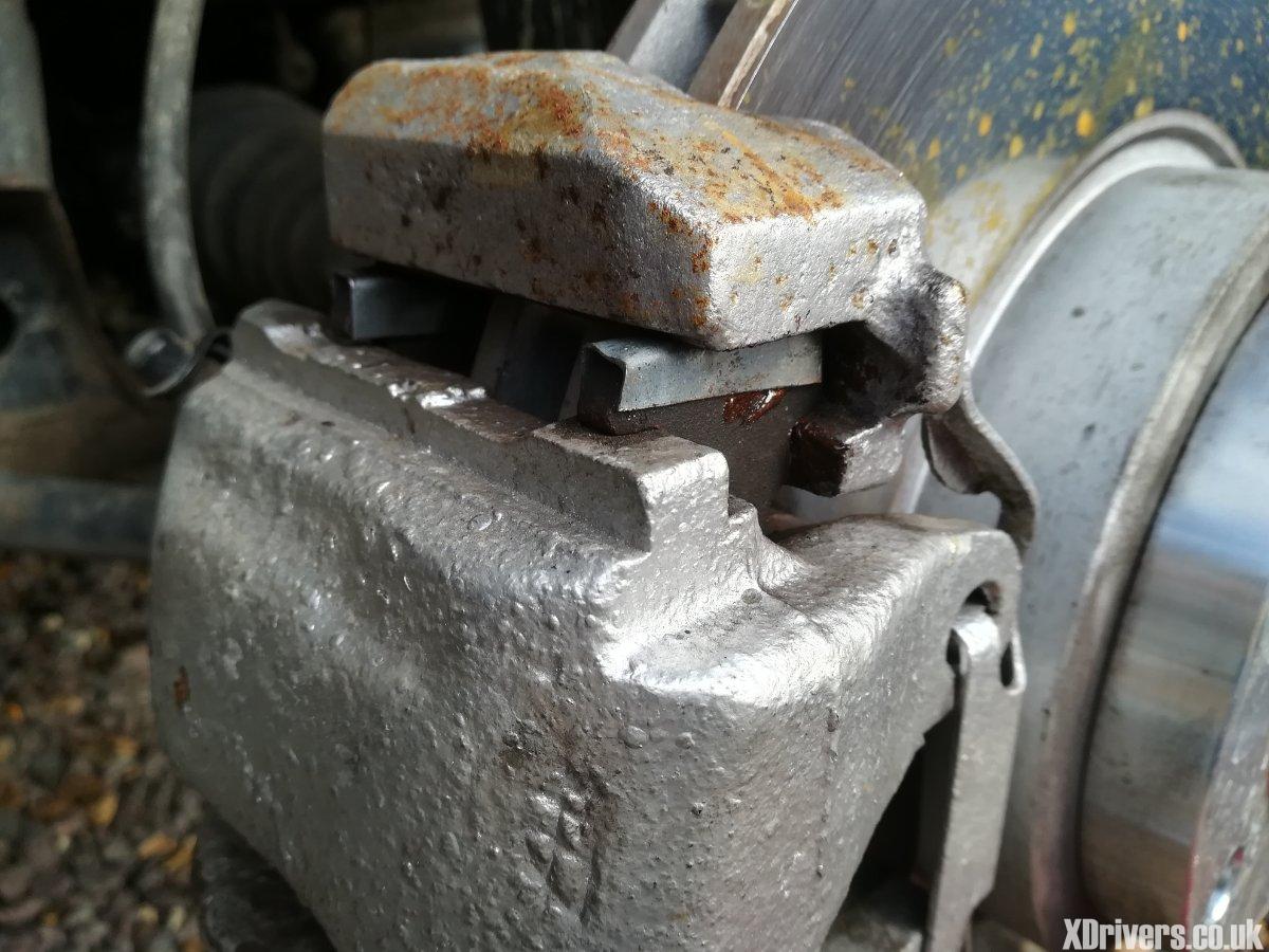

Having shimmed the rear brake pads as they were loose in the calipers I've now had to do the front..
I dont know why they have suddenly started to click buy upon inspection the pads move up and down at least 1-2mm.
I suppose I should buy new pads but there is loads of material left on them but if anyone has any suggestions for a higher friction pad then speak up.
Anyway, now I've shimmed the fronts so hopefully they will shut up..

Mine all move the same way - they’re supposed to - but there’s no audible ‘click’ when I use the brakes. Mine has Pagid fitted all round, with copper ease behind the pad and at the pad/calliper rubbing area. It looks as if you have something similar on you car.
It’s almost as if the piston is over-retracting and all I can think of for that is slightly loose wheel bearings but on all four and suddenly - that doesn’t make sense.

Make sure the caliper mounting bolts and guide bolts are tight to start with and then jack up a wheel at a time and apply brake and see if it is releasing again as sticking calipers are common and a giveaway is one wheel blacker with brake dust than the rest , I've put 2 calipers on in the last year due to sticking. Also rotate the wheel to see if there are any tight spots or indeed any bits of rust scale on the edge of the disk catching as it spins or if the disk is warped which is again common.
Never seen pads need shimmed and they really should wear in a way to become loose and the anti rattle clip is there for that reason , is it pressing on the pad ok ? plus the prongs on the inner pad go into the piston too so it shouldn't rattle and it seems a bit of a bodge and I doubt the mot man will be impressed either if spotted

Bodge! Cheeky git.. I’m an engineer don’t you know.. And anyway- I know the mot man.. but that’s not why you called...
All I’ve done is essentially made the pad metal ‘ears’ a bit longer. Agreed - in theory the calliper should hold the pads firm but as they are considerably shorter that the space in the callipers then there must be some movement when the brakes are applied as there is some serious rotational force. I’ve had this before on a Vauxhall vectra gsi (remember those) and new pads stopped the noise.
The spring clip is ok and seated correctly.
Anyway I’ve done a test drive and it all quiet now.
