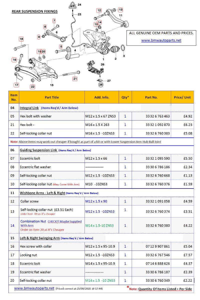

FOR ORDERING ALL YOUR
REAR SUSPENSION FIXINGS
*OEM Part Numbers given & *No. of Units required per side
BMW X5 E53 -
List of Rear Suspension Fixing - Prices.jpg (168.51 KiB) Viewed 26463 times
I hope this is of use to one and all.
