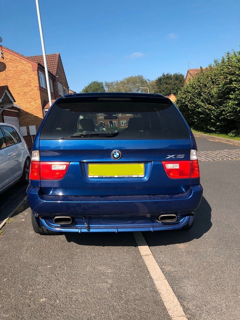

Adding some starting pics of the Beast before I started.
Just completely standard really but the pics hide the tired paintwork and leather etc.
The coating on the black front plastic on the bumper had peeled and rear bumper had a slight dent.
So figured I’d start a new thread for the swapping, modding and restoration of the new beastly 4.8is I bought last weekend.

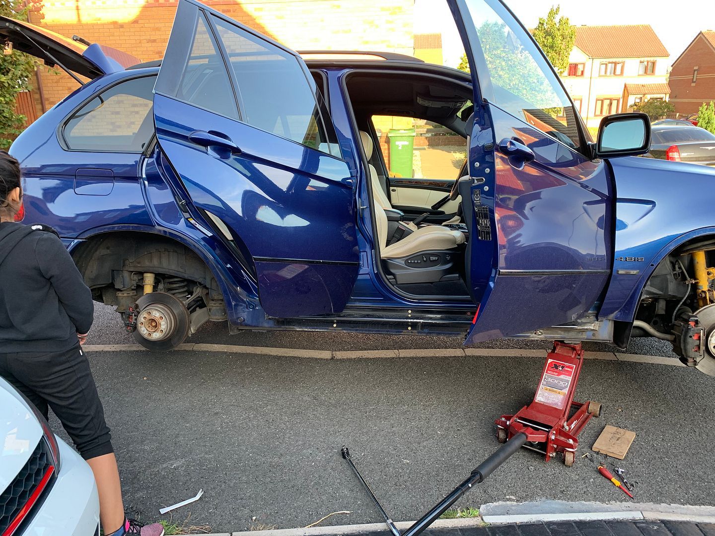

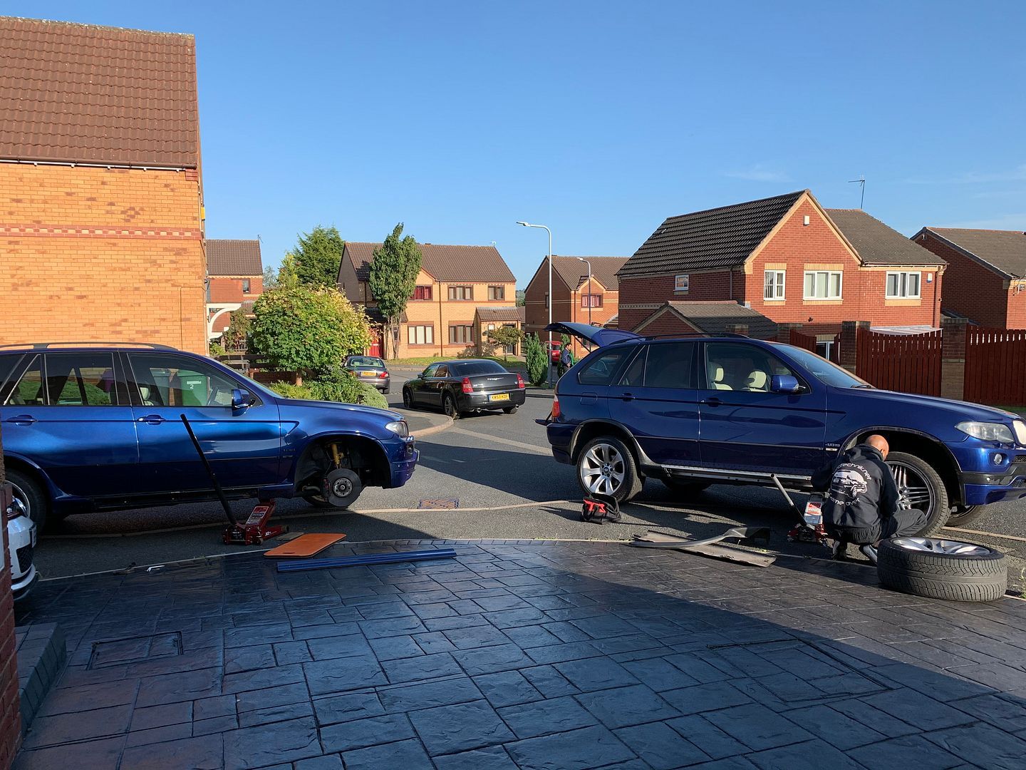

But for now the next big thing was swapping the standard black arch extension kit over to the old Beast and get the colour coded kit off ready for respray.
Luckily weather was nice so took a few hours to just get the side extensions swapped over.
Trusty trolley jacks and a couple of axle stands:

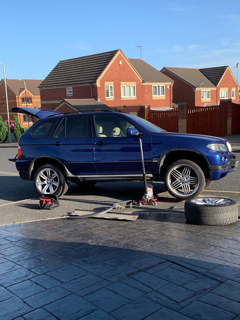

Side plastic extension pieces are quite straight forward to remove/fit. Same time needed to swap the Alpina's over too:
Getting my son involved and luckily he quite enjoys it too:
Only the aluminium sidestep to remove/swap now and that's just a number of bolts:

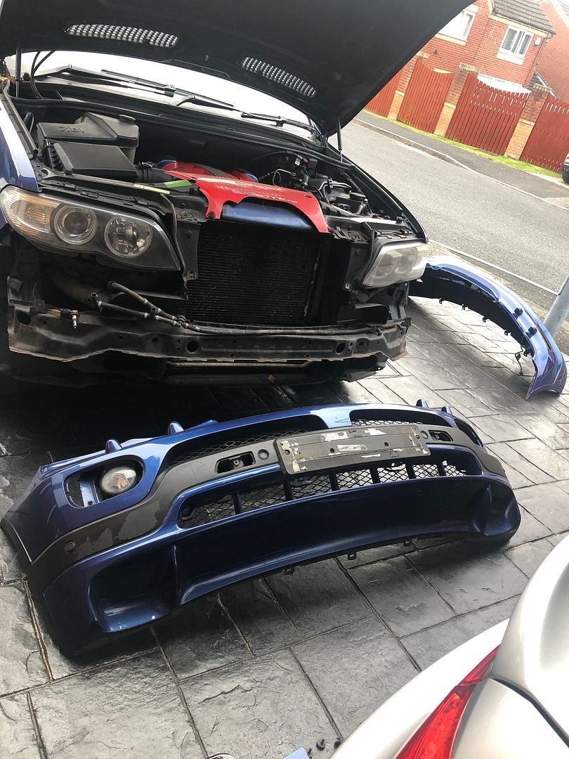

Front bumper is a straight forward affair too:

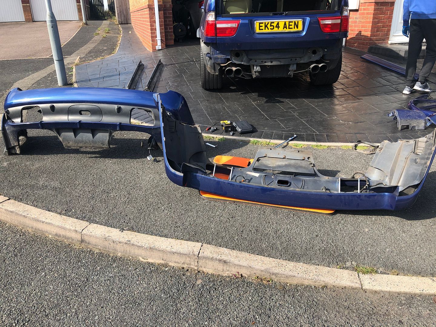

Rear bumper is bit more involved as easiest option is to remove the nuts so the whole bumper bar/bumper shock absorbers come out with the bumper:
However we did discover the shocks needed swapping over as the new Beast has the Westfalia towbar fitted so using it's own mountings. But once swapped the bumpers go back on straight forward:
Now the rear bumpers have been swapped (with the Alpina's) and the front bumper is placed on it's ready to go to the bodyshop to have the extension kit resprayed again to freshen it up along with the whole front end. Rear bumper is still all good so no point spraying it just for the sake of it.
