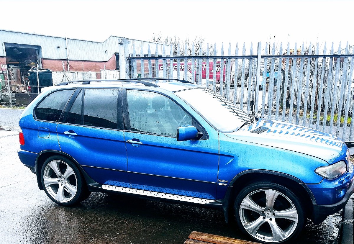

:!: Just introducing myself, I'm Jonny and the (proud?) owner of 04 d sport estoril blue 22inch Kahn rs and host of problems. Bought the x as it I got it super cheap and I mean cheap ! So the problems start here...
Won't start. (New battery fixed)
Gearbox slipping (oil filter change mega seals done, no slipping but too early to say yet)
Flat tyre (20p)
Doesn't lock. ( £3 eBay barrel repair fixed)
Air suspension fault (low one side) (dunno yet bought a 2nd hand valve haven't got near it yet)
Cracked manifold ( to do list)
TV,GPS not working, radio ok (to do list)
Front suspension knocking (to do)
Rear pads shot (to do)
Roof locks like someone washed it with a Brillo (gloss black wrap will sort)
And on and on lol
