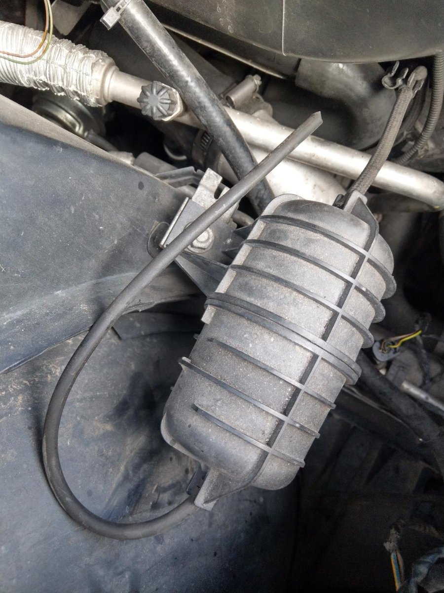

hi all
so i popped the bonnet today and noticed this and that the tube which looks like some form of vacuem tube is not actuallly connected .
any ideas, thanks in advance
anyone know what this is please?

It needs connecting! It’s the vacuum reservoir for the turbocharger control valve. Without it being connected you will lose boost. Both hoses need to be connected.

newtis.info is a copy of the BMW Service Instructions. You have a M57TU engine.
For parts data, use Realoem and put the last 7 of your VIN into the ‘Serial Number’ box to pull up your model.

Hi
Thanks very much i ll check that out , much apreciated. i had noticed some flatness on performance of late !

It should be connected to the turbo.
You can see the other part of the pipe still connected (coming off the newish/shiny part in the background of the picture) .
Needs a new length of pipe then the turbo will work again.
