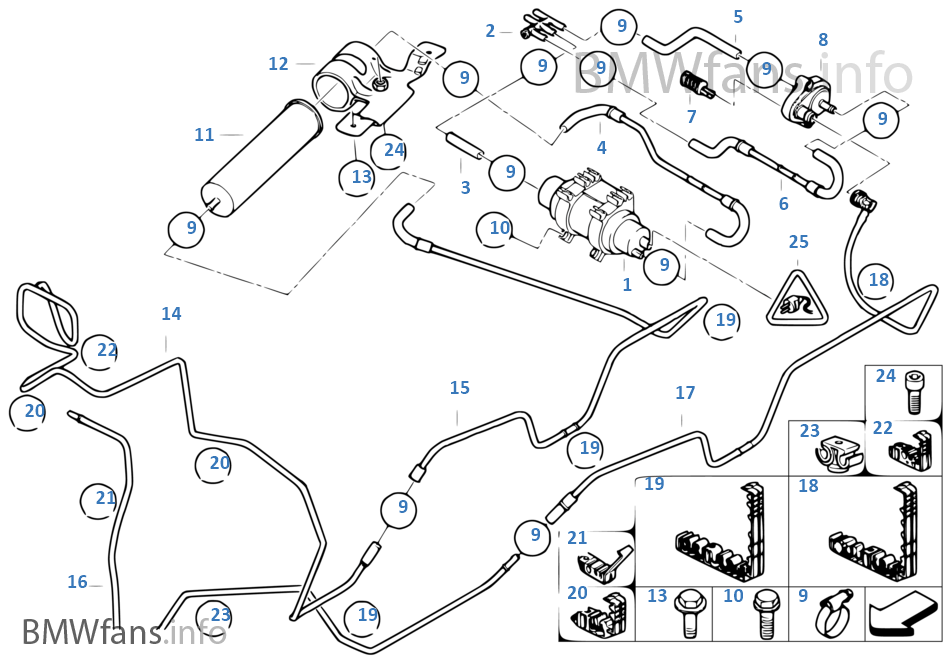

On the Diesel 2005 E53's is there just the one fuel filter, located under the rear floor pan ? or another in the engine bay also

Looking at this pic it only shows one filter.
You could check the suction jet pump hasn’t failed by checking the hidden menu to see how much fuel is in the left and right tank or just bung a five litre can of diesel in the tank and see if it starts and runs ok.
