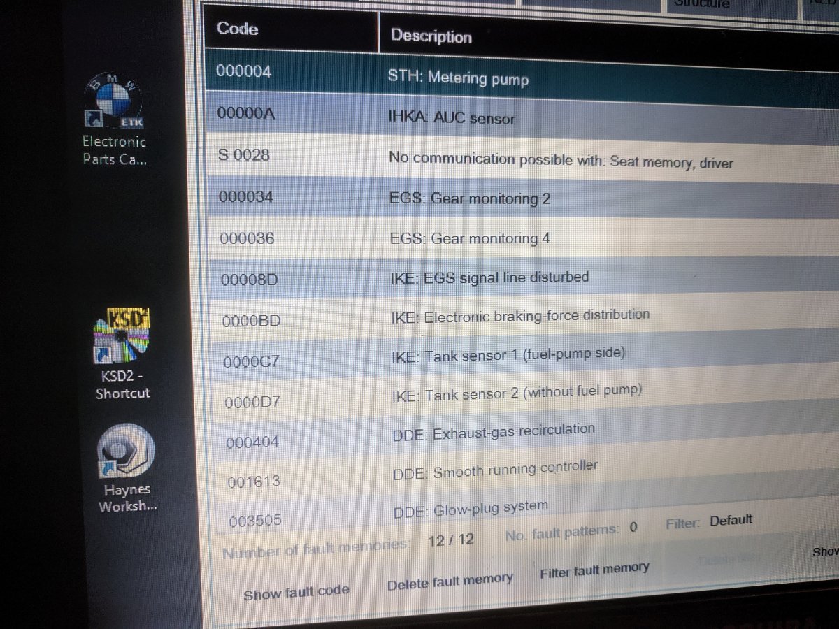

Charged battery and read codes.
- Posts: 19224
Re: Not such a Merry Christmas
The two ‘gear monitoring’ error codes could be 2nd and 4th gear clutch pack slip (it would possibly explain the symptoms you reported). The codes seem to indicate that the car is reporting that the monitored input and output speeds do not align correctly so something is slipping. Try clearing them and see what comes back (assuming that you want to drive it?).
These faults can occur if the transmission was filled with the wrong oil - only the correct BMW/ZF listed oils should be used (or one that matches the exact spec) - or if under-filled. The filling procedure is very specific and must be followed to the letter (involving temperatures and shifting with the engine running) to achieve the correct fill level). If too low the box cannot maintain its internal hydraulic pressure on the clutch and brake packs so they slip.
It could also be bad solenoids that control the shifting (sticking during operation), or at least that was another possible explanation I found on line.
Not sure about all the others but your glowplugs or controller are also showing issues. Those are a diy job as long as you plan well ahead as penetrating oil is a must and it can take a week or two to get into the holes fully. Snapped plugs are common (and fortunately fixable without taking the head off now) as I had earlier this year.
